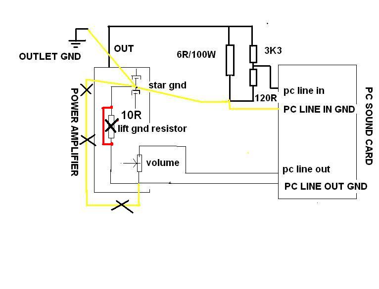

Nothing special.. Loopback, signal from card output to amp, signal from amp output to card line input , via voltage divider at low impedance. Normal shielded cables, shield always connected at both sides.
It is good to find optimal level for card input / output for minimal distortion, and than keep signal near this level, if possible.
And I found basic mistake in all posted schematic here. If an input ground, isolated from power ground via 10R resistor (ground loop currents limit ) should have any sense, than grounded end of NFB resistor must be connected to this input ground (junction R2,C2,R3), not to power GND. Other way this 10R resistor only worsens mains artefacts.
For CFA amp (NFB resistor only 50R) decrease value of R3 to 1-2.2R, but best solution is not to use this resistor at all (replace with jumper to power GND).

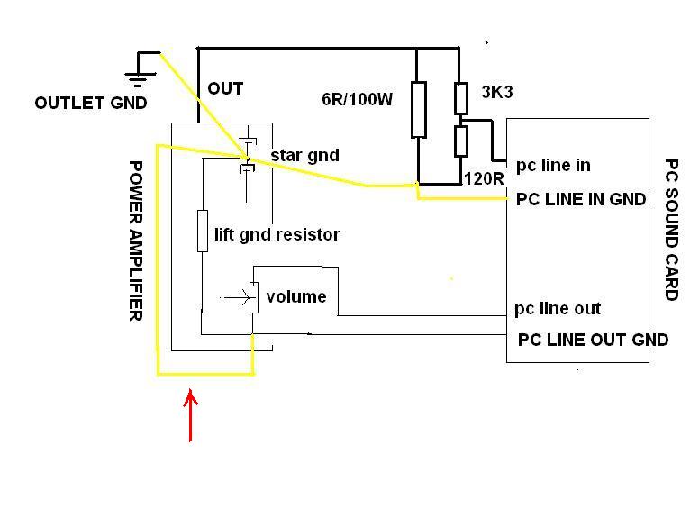

That is the reason why this yellow wire added ,by-passing this lift gnd resistor

Do not use "special" wire direct to star gnd point, it is not good.. Simply replace 10R resistor with shortest wire jumper (cutted resistor lead ) instead of 10R, at the same place. Input GND and input bias resistor (10k) ground side should be at the same potential as NFB return path ground (ground side of 50R). Traces at PCB are not zero impedance, so I recomend GND as poured copper plane.
Ok understand this.
The recommendation is about direct ground input point with a short link instead of this 10R resistor.
I will try this soon.
Thanks again.

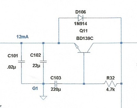

The OPS has a cap multiplier built into the board that drives the IPS. The original used 470R/22K voltage divider. Both you and OS changed that in your mods for the IPS. My question is whether or not that is an important part of the mod? I thought the idea of this modular design was that we could build the OPS and use as is, and simply attach different types of IPS modules. I don't want to have to modify the OPS every time someone comes up with a new IPS. Defeats the purpose IMO.

Target of all this modifications was to improve PSRR, that is why here are cap multiplier modifications. Simply calculate time constant (RxC) of colector to base resistance and capacity from base to ground. If multiplier transistor has high enough h21, you can use larger value for resistor and so increase time constant - improving filtration. At the same time voltage drop across multiplier should remain reasonably low (2-3V), so exact values depends on transistor parameters. Here is no need to change this for other IPS in use.

The BC3x7-40 would be the best transistors for the C-multiplier. Put a diode or two across the base-feed resistor to make sure Vce never exceeds more than a few volts. The BC3x7 is extremely robust and can handle up to 1A inrush surges, so as long as your frontend reservoirs aren't too large, it can fill them instantly.
Putting diodes across base resistors will also dramatically increase BC3x7 base currents at switch on , and I am afraid, that BC3x7 can not reliable survive this for long time..
