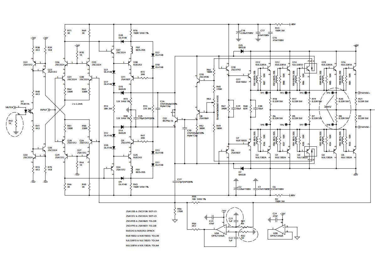

These days , even the best amps are willing to go back to the "classic"
(below) . I heard this one (repair) /// it rocks !! 21'st century Leach ...
They put the whole IPS in SMD. (small)

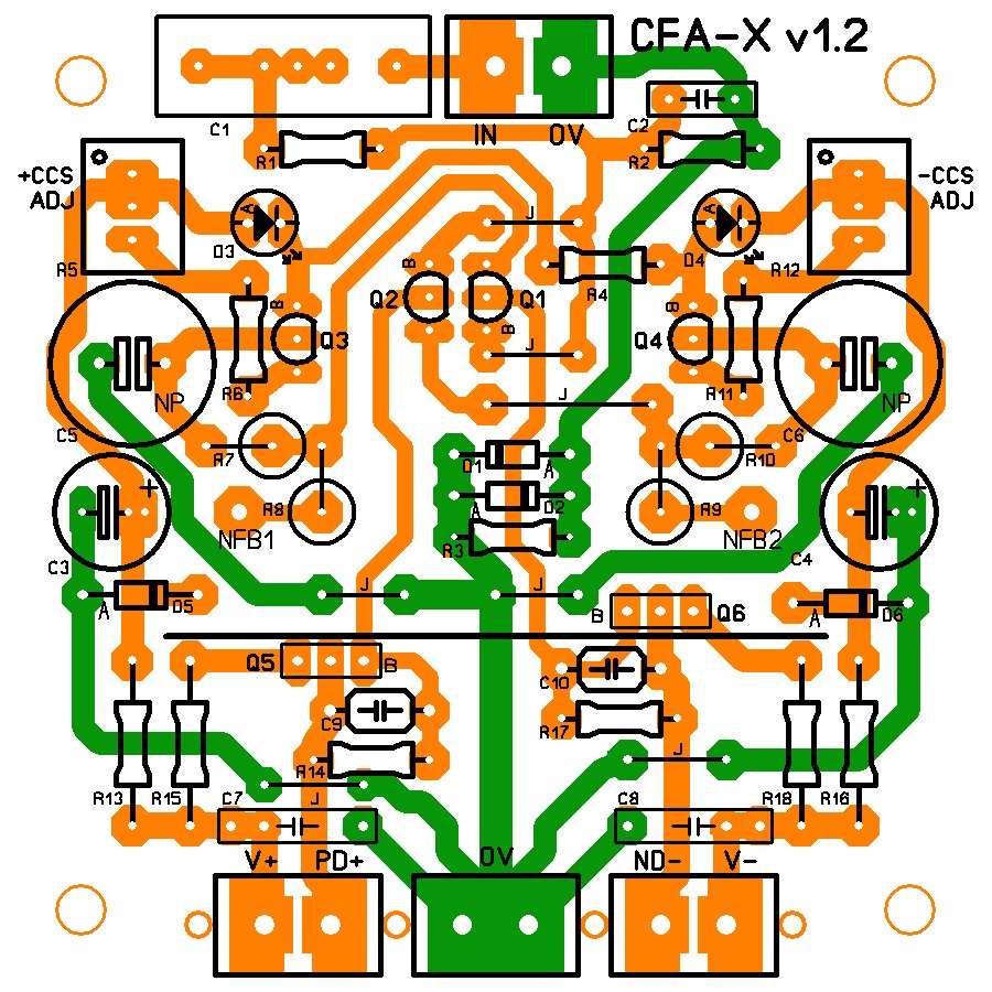

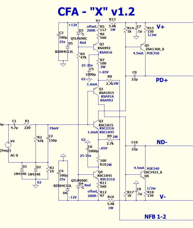

CFA - X is done.
Had to check the other VSSA variants out there ...
Peeceebee had the decoupling of both the IP pair and
the current feedback on the same ground traces
... but it
still works !
Jkeutmann's through hole variant is better , the original lazy cat
thread shows just about every mod that can be done
Here... (CFA-X) , we might drive 400W EF3's and use 85V rails.
More considerations ....
-Separate zener diode regulator and current feedback ground returns
which are fully symmetrical and terminate at "star-OV ".
Current feedback as designed is 20mA at 70V rail clip. SOME
tweakers
might want to lower CF resistance to hit 300V/us+
....50ma could be passed to the ground centerpoint
... balanced
(same length) traces will cancel this out here. You don't
want the regulator decoupling to "see" any of this garbage
-The input pair ... At high rails and heavy current feedback , all
you have between you and "magic smoke" is Q1 and Q2 (below 1).
THEY BETTER BE GOOD !![dice :dice: :dice:](https://files.diyaudio.com/forums/images/smilies/dice.gif)
KSA916/KSC2316 are 30p Cob 120 Vceo heavy duty vertical output devices ...
http://www.mouser.com/ds/2/149/KSA916-66917.pdf
http://www.mouser.com/ds/2/149/KSC2316-59562.pdf
MOUSER has 6K each of the "Y" grade. These are better for
a big output voltage swing monster amp running at 70V+ rails.
CCS's just supply 1.6-1.8mA (ksa992/sc1845) is alright here.
Look it over ... I'll have my glass of Argentine Vino while I stare at it
(below 2) for awhile ... I think it's 100% ( and the best of the Variants) -

ostripper,
Couldn't you decrease the voltage into this input section below that 70v requirement of the output section and run them at two different voltages? Is there a good reason to keep one rail voltage for both?
I you look at the circuit , it is different than the others. The current feedback
nodes are current sourced from a +/- 12v supply (the zeners).
Each input device only sees only the rail + 12V. This automatically doubles (-12v)
the voltage this IPS can handle.
Globally , this IPS could run from 35V -85V (my design goal).
With lower Voltages , R13/16 might need to be reduced to keep the
Zeners at 12V. Input devices could be "cheeper" lower Ic (ksa1015/sc1815)
, as well.
That's all ... good for all the OPS's.
PS - you would want to do the reverse ... the OPS can run "boosted rails".
(IPS at a regulated 70V - OPS at 60V , for example)
OS

Thanks for the explanation OS. I have a couple of Lazy Cats VSSA boards, how different is your CFA-X design than that? I look forward to a complete tested amp from input to output and the opinions on the sound.
ps. I guess I should have said the input section as your output section is very different I believe than what LC did in that regard.
There is not much to the VSSA , it's just a simple I-V converter where
there are just 2 devices doing most of the amplification (I).
CFA-X just level shifts the NFB node to the 12v supplies to double
the voltage capability. This amp , lazy cat's ,VSSA, peeceebee are all the
same input section.
This variant is just customized for the slewmaster OPS.
OPS is already tested , this IPS is so dang simple/stable .. it can't fail.
OS
