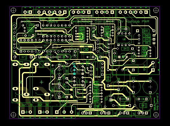

Christophe, the whole thing fits 101.6 x 76.2 mm board, including speaker relays (electromagnetic or SS), providing:
1) Remote (trigger signal) on/off;
2) Soft-start with flexible control over the delays and sensor checks;
3) Protection against:
- DC offset (2 channels);
- Over-current (2 channels);
- Over-temperature (2 zones);
- AC failure.
4) Status indication (single LED);
5) Redundant algorithm - extremely robust in every stage of the working cycle.
Hard to beat performance/simplicity ratio
As OS just mentioned, sensors can be used separately from the controller, although I don't see any reason not to use the controller, unless it's a matter of controller-fobia
Attached layout, designed by jwilhelm, is not the latest one, but already compact enough...
Again - I like your circuit, Op-Amp based sensors are precise, SS relays are fast and powerful, but... sometimes you need an extra control channel, sometimes you need some delay to last a bit longer, etc. That's why I use a micro-controller.
Valery
P.S. Could be a cool project to combine your sensors and my controller / firmware, to have a great combination of precision and flexibility, plus cool indication features

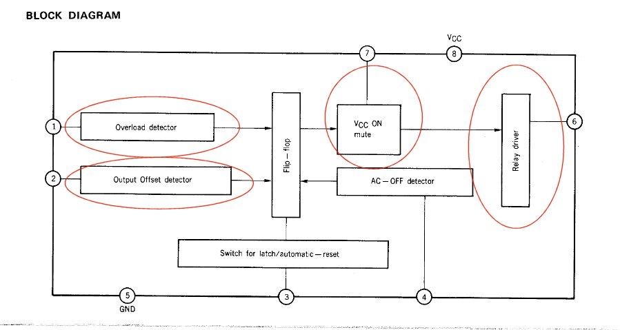

I now have a good idea of the 1237 internals. Just have to convert its
block diagram to discrete (below 1).
(circled) I have ...
-The DC offset circuit - 3-4 bjt's , diodes , caps.
-The overcurrent ... the opto

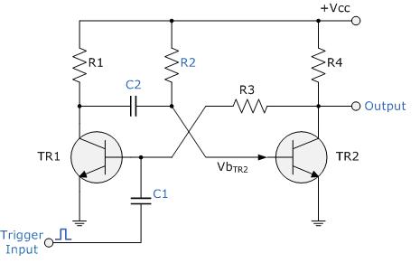

-I will use a latching flip flop (below 2) - 2 bjt's.
- The 2 bjt multivibrator's (below 3) R/C will reset the flip-flop after 5 seconds -
after it is initially triggered by an inrush surge. This will turn the relay
driver on.
- Power off can just be the quicker timing of the auxiliary supply's collapse
turning the relay off before main rail collapse.
There is my 8 bjt circuit - should work well.

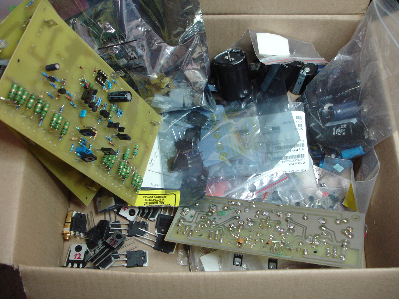

Sorry for this off topic but i want to say Thanks to a good friend ,Gred(coolewater) from Germany . He has sent to me a free package full of parts
I also want to say a thank you to those who offer me free PCB, But i don't know if i have the permission to say their names.
Thanks friends.I appreciate this.
