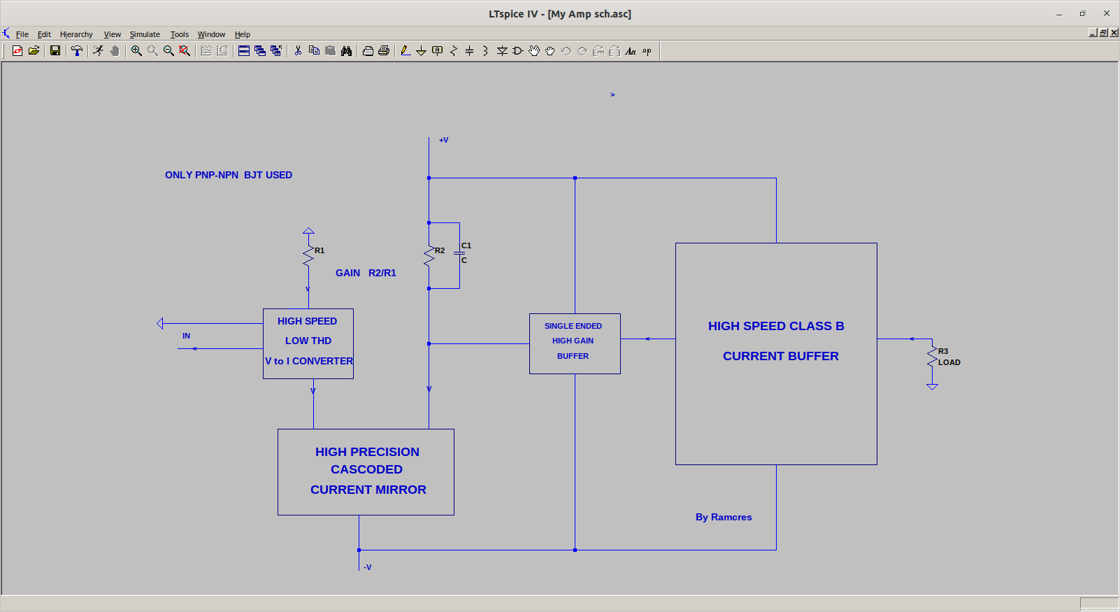

This is my amp design :
All the stages optimized for speed ,low distorsion and constant delay .
I forgot , without C1 :
Delay in fist 3 stages 0.3ns
Delay in output 1.2 ns with 8ohm load 1.3ns with 4ohm load
And the sound ....delicious.
BR

Your amplifier design provides us with no details, just some functional blocks.
It would be more appropriate for you to start a new thread to discuss your amplifier design rather than doing it here as its distracting from the slewmaster cfa/vfa discussions.

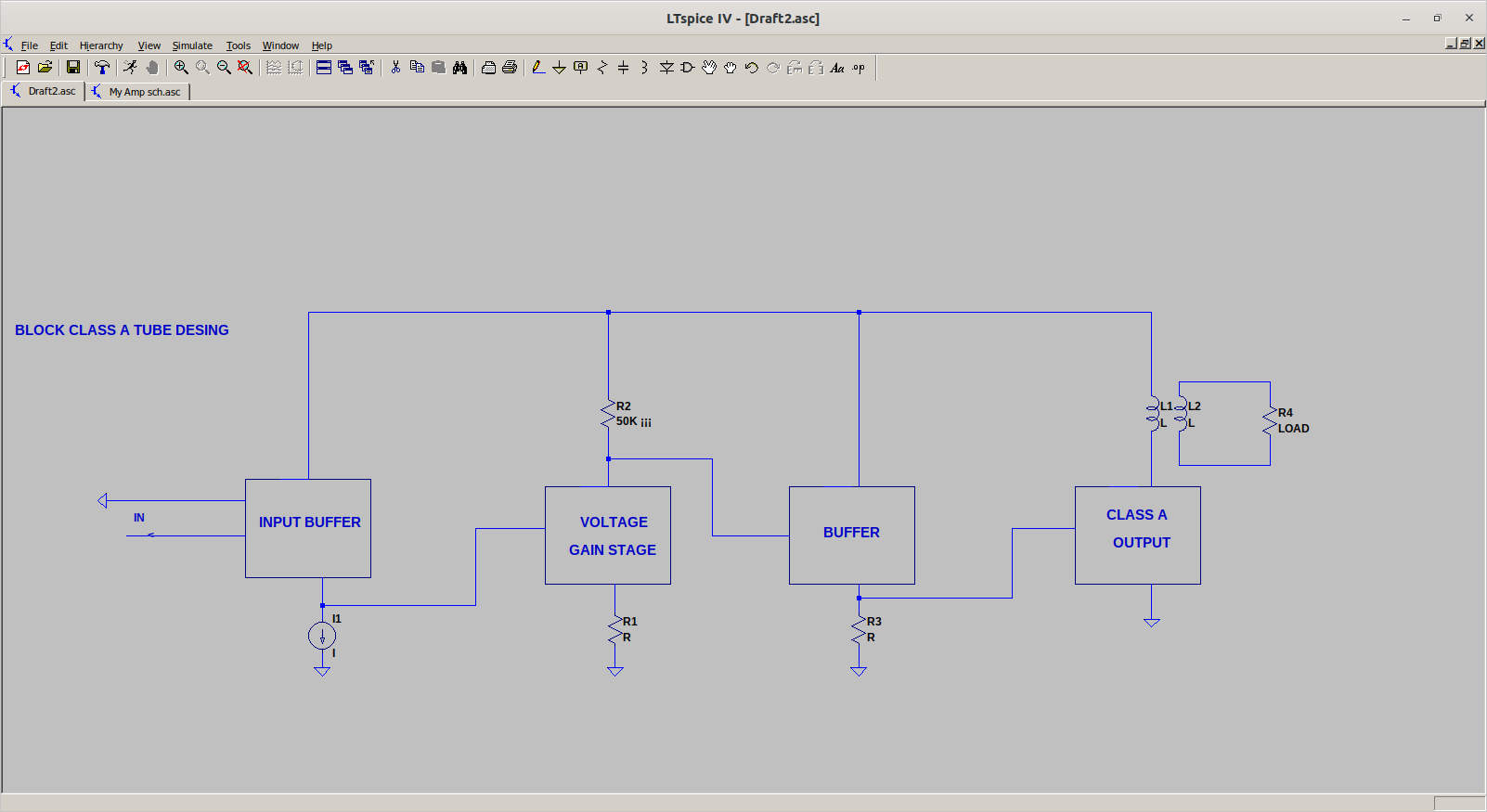

This is the sch of the best amplifier (tube) I have ever heard:
For a long time I have been thinking why and I have found several causes:
1-Tubes are very fast
2-Have very high current gain
3-Low and Linear capacitances
4-Non feedback
5-Single ended design , one device per stage
BR

I'm sorry I forgot that people like discussion about nonsense
Your design is non sense.
With or without global negative feedback, it can have very low distortion. Dr. Arto Kolinummi proved it in his book. But, some designer use without global negative feedback to achieve very high slew rate because they do not understand to achieve very high slew rate using global negative feedback. Usually amplifier without global negative feedback have very high distortion, because they do not understand how to achieve very low distortion without global negative feedback.

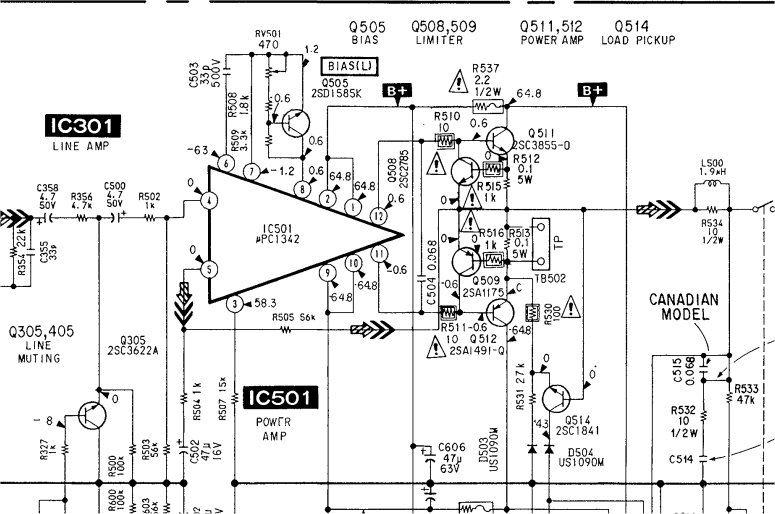

I have be honest , I have been busy with better loudspeakers and simpler
amps. I fell in love with the TDA1342 (below) after repairing a couple sony amps.
Went further to add (and reverse engineer) the JVC "super A" type
bias control. So cheap , what I got was a blameless type PPM non-switching
blowout proof amp. This is why those sony's last for 30+ years.

Glad to see your back.
I have found a DIY A post here with a schematic of JVC super class A chip VC5022
équivalent de VC5022
Is it interesting for you guys?

That is the uPC1342. Here is the datasheet:
