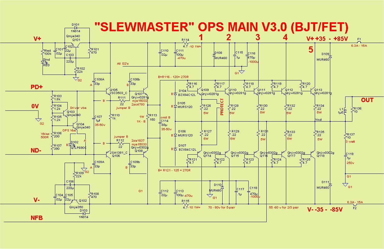

BOM for the welder 5 pairs version
Hi

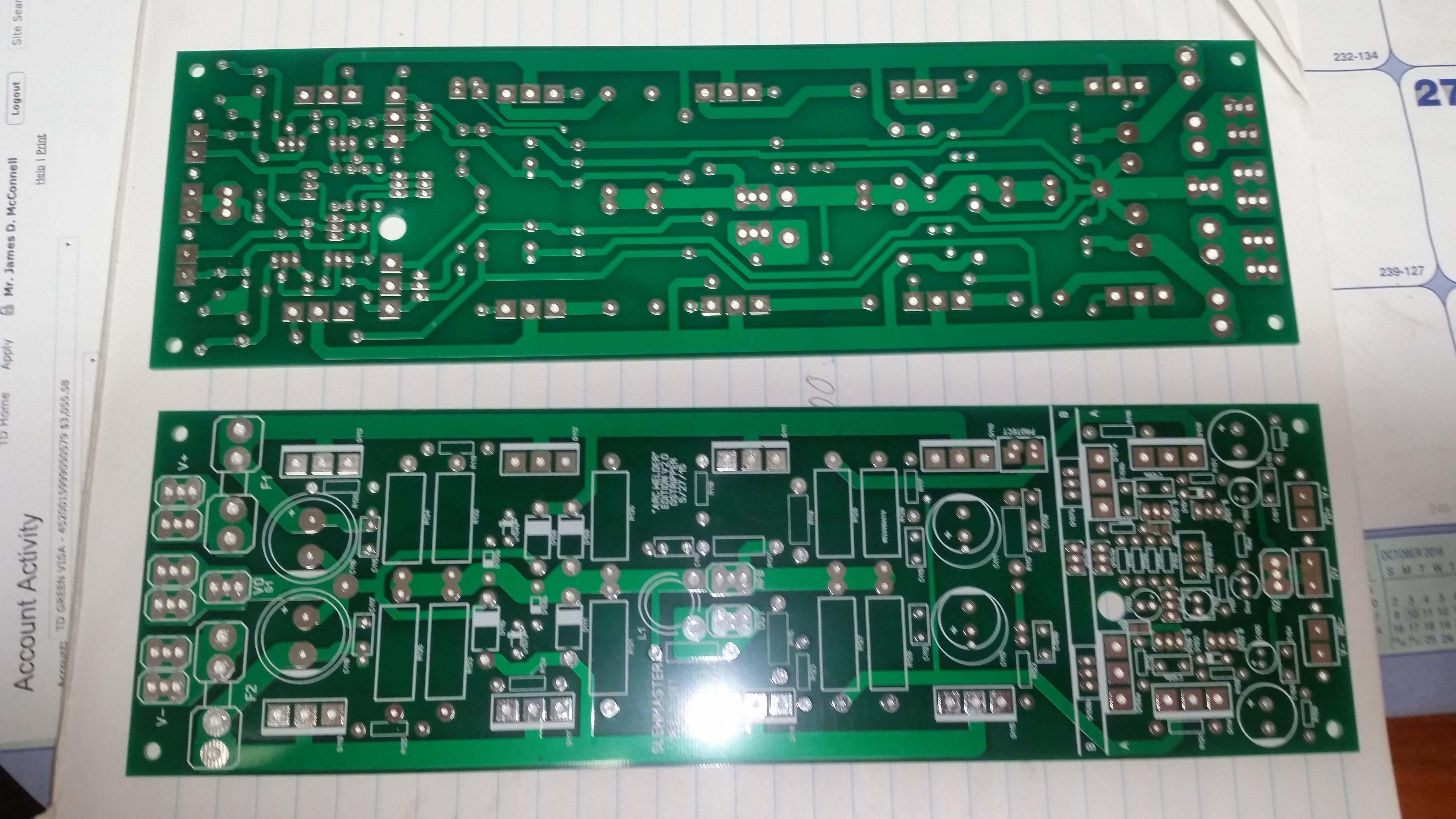

Can someone point me the right direction to find the correct BOM, close up pictures of stuffed PC board, circuit etc. for this (welder)version, please see attachment.
I have the schematics many parts marked with red.
I know these PCB can be used with mosfet also, I am interested only in power BJT-s.
I want to place some order on capacitors and I got confused.
