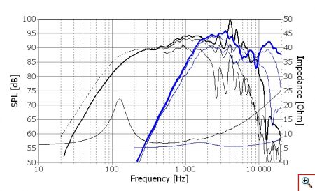

Wow, the response measurements at troelsgravesen.dk look terrific! Seas' own data shows some more variance at 0° though.
The breakups peaks at 6/8/9kHz are from the woofer.
They should have used different colors for the woofer and tweeter curves!
Definitely but it still doesn't look as smooth as the troelsgravesen.dk tweeter measurements. Maybe he measured slightly off-axis and the peaks/dips can only be seen with the mic dead center? Guess this would be a good sign in favor of the driver's performance?
Stretch the upper response of the seas measurements to the same size as the individual tweeter response and it smoothes it out. His aren't on a truly log scale.

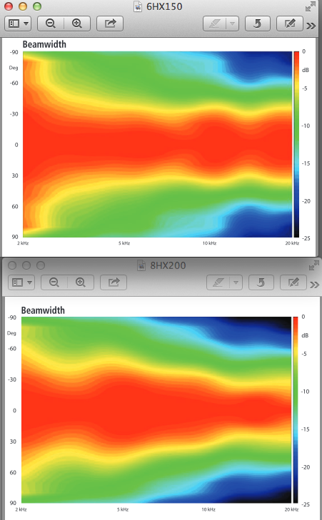

Useless data. The polar map is probably normalized and heavily smoothed.
Although the polar map is normalized and smoothed, I don't consider the data useless (as far as it goes) though extending the chart down another 2 octaves would no doubt paint an even less rosy picture.
It is apparent that the Faital 6HX150 has a fairly uniform 90 degree beamwidth from 20kHz to 4 kHz or so, widening to almost 180 degrees at 2kHz, while the 8HX200 goes from only around 50 degrees at 12 kHz and above to over 90 degrees at 5kHz, down to 70 degrees at 3.5kHz, then over 100 degrees at 2kHz.
Just from the charts, easy to see that if uniform pattern control from around 700 Hz up is desired, neither of these two coax really fits that criteria.
