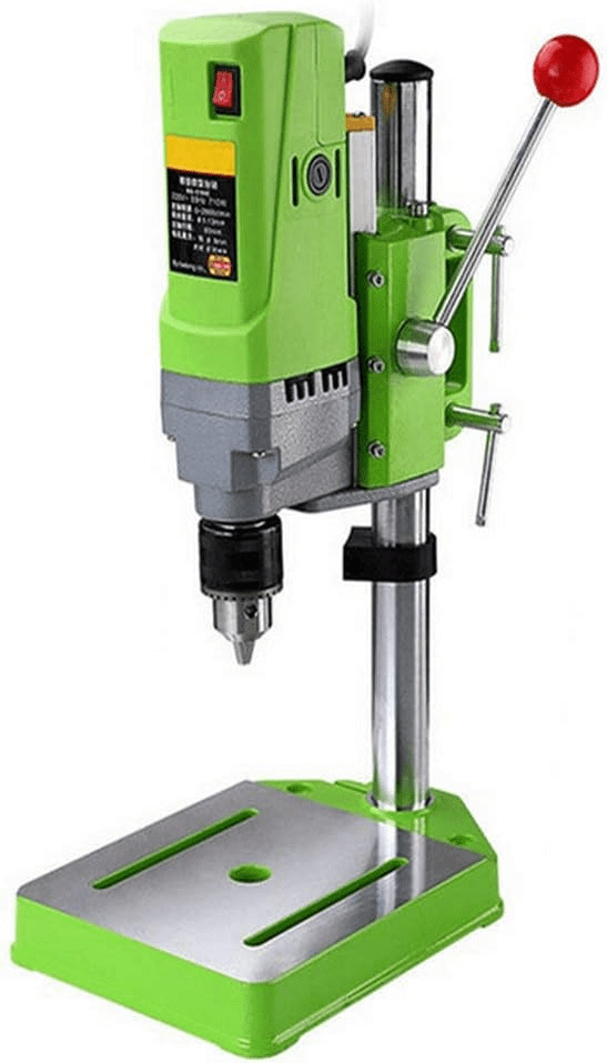

Here's another good inexpensive benchtop drill press, also Chinese made, for about $100. This is much better than a Dremel drill press, and IMO works much more nicely than any belt drive drill press I have ever used. Does a great job on aluminum heatsinks.

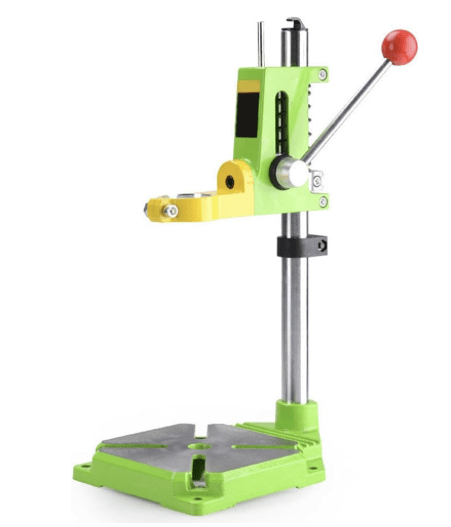

Heh. That's basically a cross between a drill stand and a drill press. Not a bad compromise.
There appears to be a drill stand version of it too (available at Bezos' Bookstore):
Handy if your power drill has an accessory collar that allows it to be clamped in the stand.

That is very tempting and I don’t really need it.Here's another good inexpensive benchtop drill press, also Chinese made, for about $100. This is much better than a Dremel drill press, and IMO works much more nicely than any belt drive drill press I have ever used. Does a great job on aluminum heatsinks.

Or maybe I do….
The Indian company Ralliwolf sold such adaptors in the 1970s, basically a way to use a larger than regular pistol drill on large jobs, a magnetic clamp was common.
Other stands / adaptors allow the use of a clamp where the extra handle fits...this is just a modified pistol drill without the grip, on a rack press.
I would rather buy a bench version with a regular motor, this has a series motor, they are not as durable as induction motors, and maybe get more speeds as an option.

I purchased one of these for my daughter a year or so ago.Here's another good inexpensive benchtop drill press, also Chinese made, for about $100. This is much better than a Dremel drill press, and IMO works much more nicely than any belt drive drill press I have ever used. Does a great job on aluminum heatsinks.
https://www.amazon.com/dp/B07ZBXD2MX?psc=1&ref=ppx_yo2ov_dt_b_product_details
The jacob chuck (most) will typically have runout in the 3 to 5 mil range (although I never measured it myself. She was only doing plastic drilling).
I use a mill to do accurate holes, with edgefinders and DRO's to get into the .5 mil accuracy range, using centering drills to start the hole, and either R8 or ER 32 collets to get great runout specs (.2 to .3 mils typical).
Using this small drill press, I would first pop a location using a spring loaded punch, lock the work into the press (it came with clamping) and center the hole using an edge finder point, then use a centering drill to start the hole, then use the final drill bit.
Drill bits, you get what you paid for. Too cheap, the cutting profile will not be concentric to the drill body. Smaller diameter bits will simply wander as it progresses, or the chipload on one of the flutes will be too much and the bit will break. Think of a chipload in the .5 to 1 mil range, with a chuck and tip error that causes the bit to load one flute at 5 mils, nuttin but heartache.
John
My point is not that this is a precision machining center, but that it is a pretty decent hobbyist benchtop tool at a price that is easy on the pocketbook. IMO, it punches above its weight, I' rather have one of these that any of the $200 and up belt drive drill presses sold by Harbor Freight and the like.
