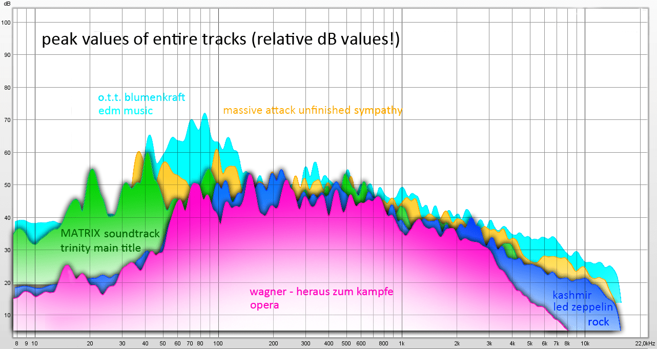

Crest factor isn't anything you negotiate in or out. It's simply a figure of "how average level and peaks relate" in a piece of music. As you are obviously not ventured in the more theoretical part of audio and speaker building and don't understand your own requirements, I suggest that you:

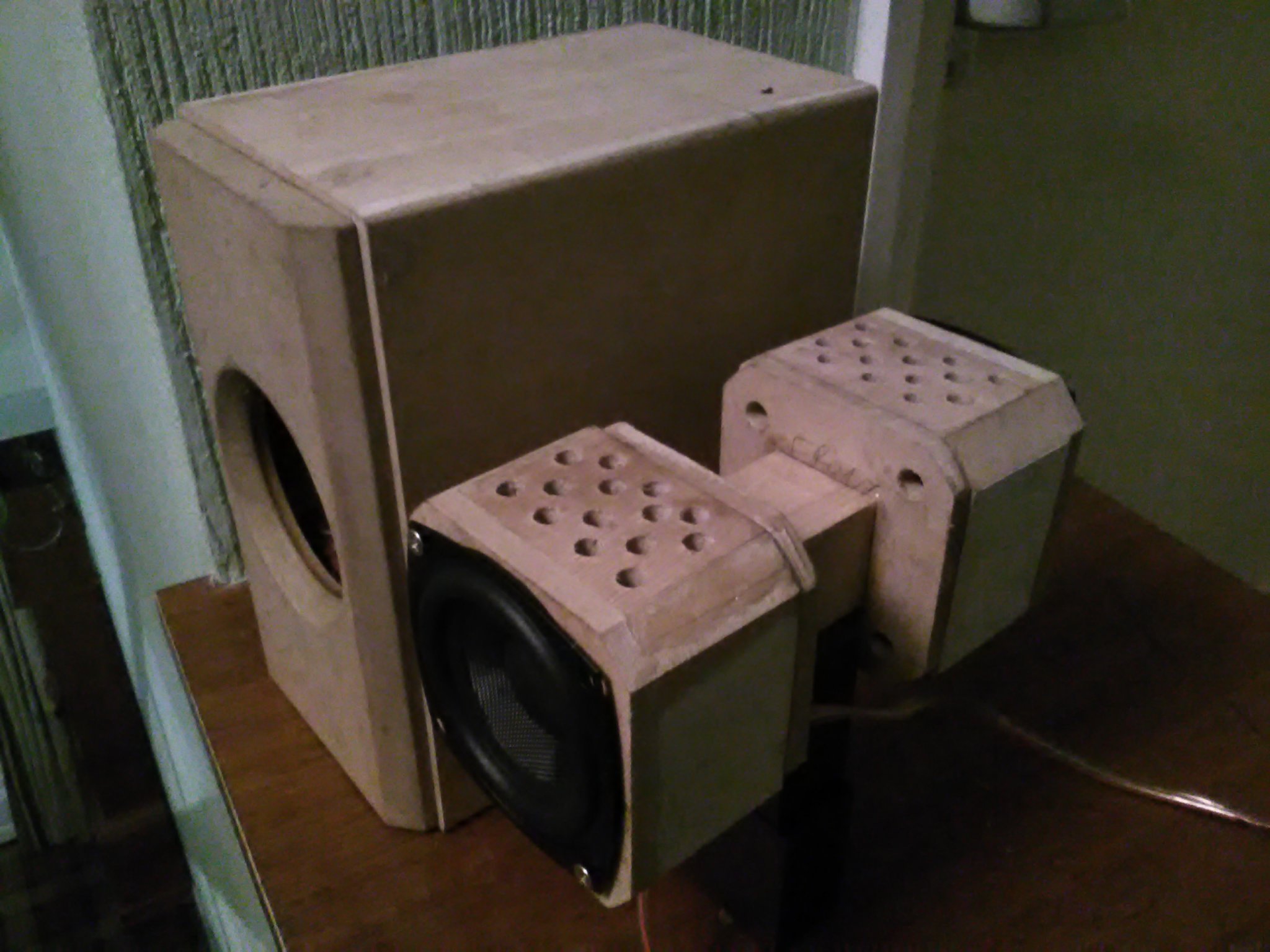

I have attached a picture of some speakers I made a while ago, for two reasons; the speakers use two 2.5 inch woven glass fibre drivers mounted back to back to cancel out reactive forces, the front is used full range, the rear comes in at below 1,000 Hz to fill out the bass.
The first reason is at first the sounded mediocre, but I recently tried them again after moding the amp ( greatly increasing the power supply capacitance ), and they sound much better - if you want to drive a few 3 inch drivers hard at 50 Hz, it's not only power ( watts ) you'll need, but also a stiff power supply. the other reason is if you have a lot of 3 inch drivers working hard, all mounted on the front, that's going to shake the cabinet. The only thing I can suggest is you have something like one of these, working full range, but standing on s stack of similar speakers ( all made in one tall enclosure ) coming in at 100 to 50 Hz. You seem to make no mention of whether they'll be close to a wall.
Yeah the bass SPL/extension is just physics, related to sound wavelength, and proportional to volume displacement our transducer does. Here is handy chart one can use to quickly estimate closed box woofer system SPL capability at certain frequency per available volume displacement https://www.diyaudio.com/community/threads/volume-displacement-for-spl-chart.5668/post-55869

I mean typical drum kick I mean electronic one or from hip hop or EDM music is near 50hz, I can hear it perfectly fine on my speakers and perfect bass, muddy but it's there and no distortion.
Is mud considered part of distortion as well? When we say the word distortion, do we mean pop, crackle rattling sound from the cone or does very muddy sound also means distortion? So when you guys say you will hear distortion, maybe I’m already hearing it in a form of a muddy sound.

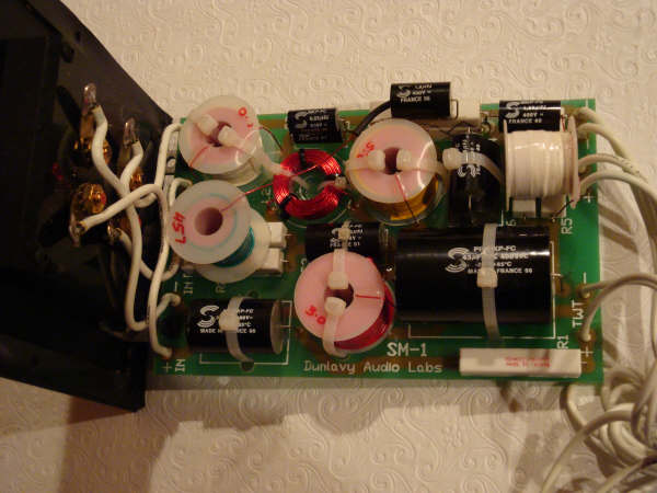

Last issue to resolve, can we please go back to Dunlavy SM-1 crossover. Can anyone tell or at least estimate what type of set up is it.
I’ve looked at typical passive 2-way or 3-way crossovers, they do not have as many coils, so my gut feeling he is not running both drivers together up to the tweeter and then simply crosses them, perhaps it’s something similar to my attempt of 2.5-way maybe different crossover points then what I want to do and no gain on low end or maybe he cut off the high and mid range to match the low end as well.
What can we extract from that picture.
I don’t care if it relates to my case or not, the logic is still the same, either cut everything down to the level of the low end and see how loud it is and how much color is there or slightly boost the low end till it’s max excursion.
