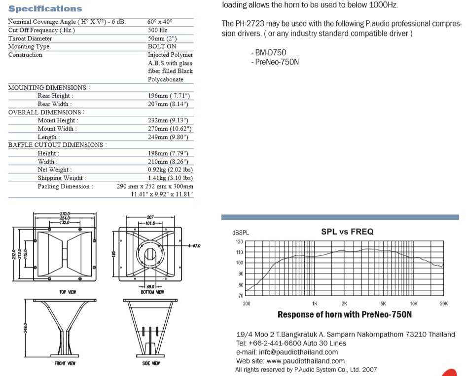

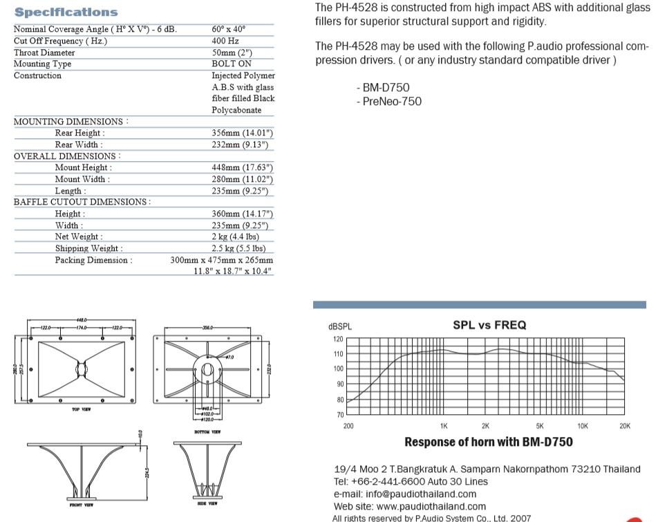

In my research so far, the P-Audio horns with 2" throat appear to be close to either the Eighteen Sound XT1464 or the Faital Pro LTH142. I'm interested in a quality DIY solution for my home, using the proven B65WBAC25-4 mid/tweeter along with DSP to set crossover from the mid/tweet to 2 woofers around 500-600 hz.
I think as the horn/baffle gets smaller (10" in width) I may lose some of the low-end directivity control that a bigger horns can achieve. Here is one question: I'm thinking two small (4" to 5") Woofers with sealed backs, mounted nearer to the mouth of the horn wall can work for a smaller point-source speaker, compared to mounting the woofers on the baffle - but am fooling myself into thinking that a small-ish 10" horn can control directivity below 500 Hz and provide a point-source experience comparable to a larger horn?
If directivity can't be controlled much below 500, is the point-source experience worth chasing? at what point does it make sense to give up on the Unity/Synergy idea, and place the woofers above and below the horn instead of attaching them to the wall of the horn?
Finally, I am curious to learn what folks think about either of the horns below, mated to the SB Acoustics SB65WBAC25-4 for a tweeter and 2 SB Acoustics SB12PFC25-04 4"woofers.
Thanks! - Six.

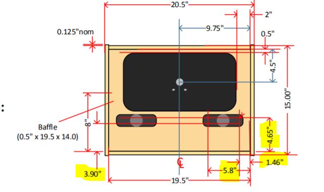

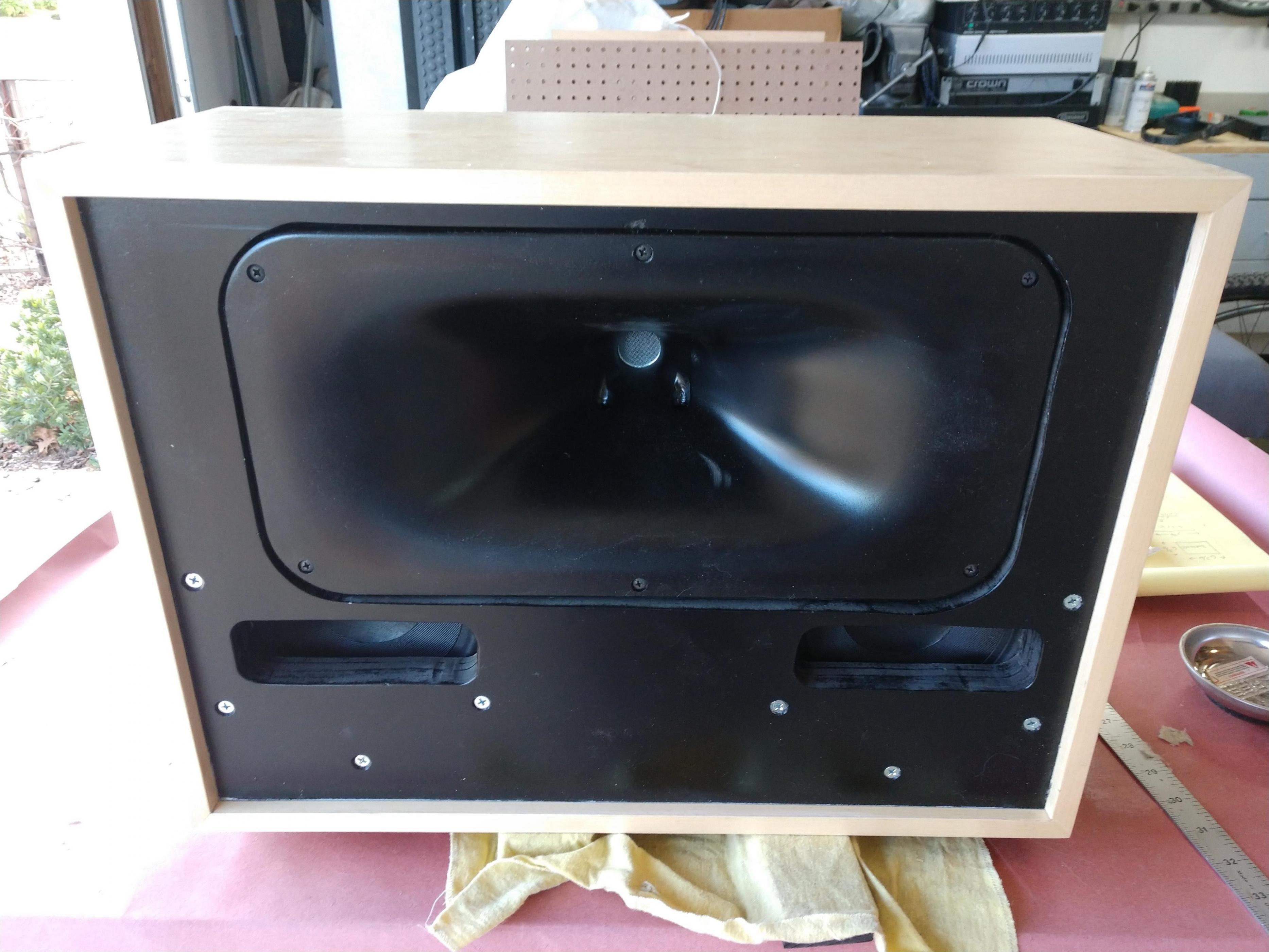

I'm building a pair of sealed SmallSyn's. I'm stuck at the dimensions/layout of the woofer ports on the baffle. Are the dimensions in the plans the outside dimensions of the ports or the drilling locations for the 7/8" corners of the ports?
They are the centers of the drilling locations. The size of the ports isn't critical, by the way, wavelengths where they are used are long. Just don't go out to beyond where the driver gaskets will be. And for best vertical pattern, I wouldn't let the height get any taller than in the drawing, want the centers as close as reasonable to the center of the waveguide. Too narrow height might possibly restrict air flow (though not likely).
That drawing is for 0.5' plywood side panels for minimum size and weight Be careful to make sure the back is well braced, maybe more than shown in the plans. My original ones were actually done with 3/4" ply, and seem quite dead, though.
