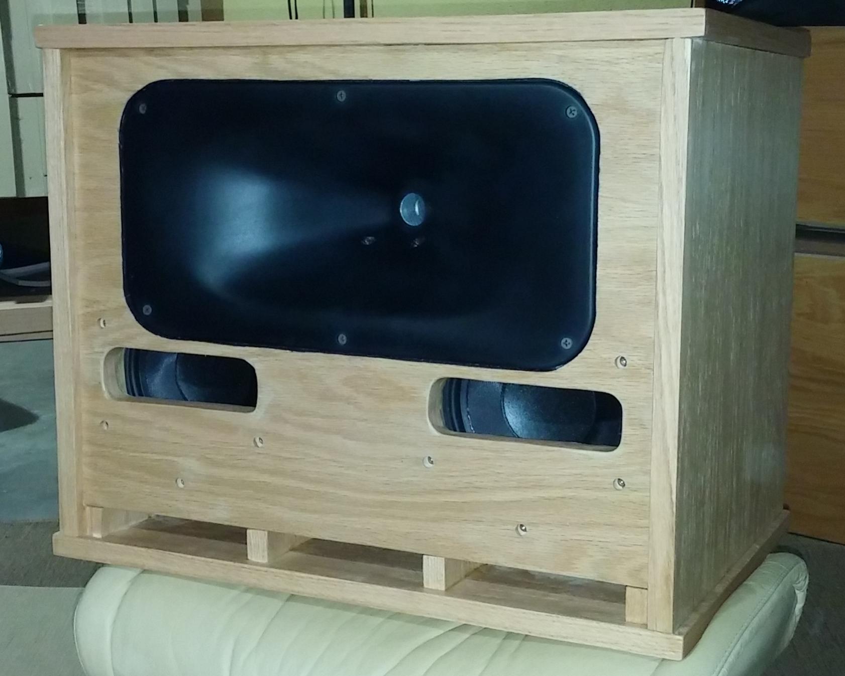

Anyway, here is a photo of the shelf ported cabinet still with bare unfinished wood. I finally got around to mounting things into it temporarily to adjust the port length.

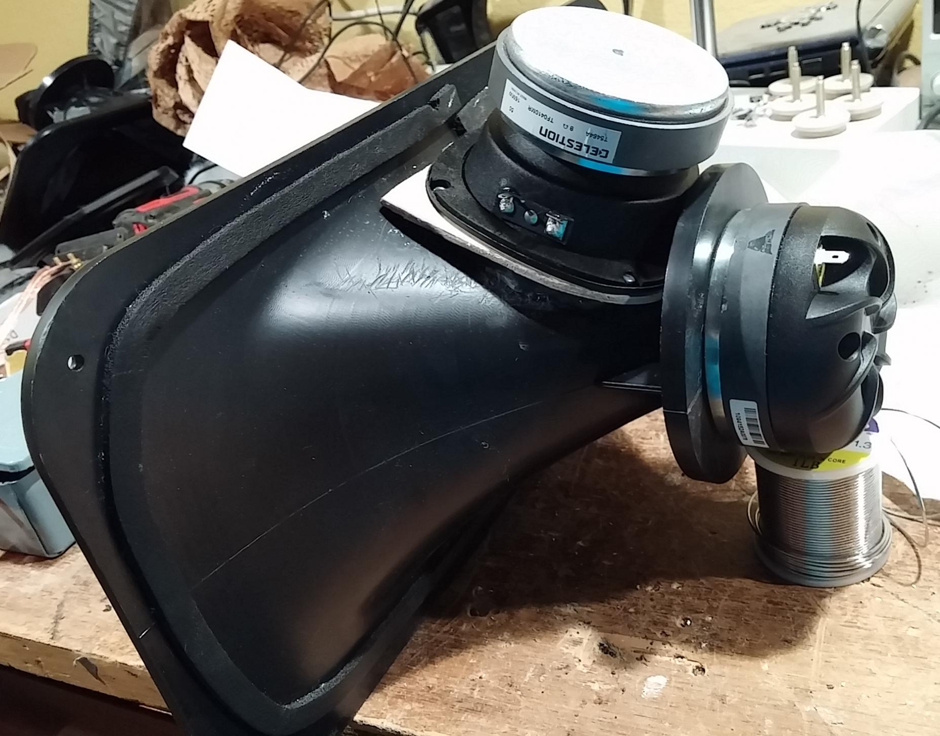

How hard would it be to adapt it for the Celestion you're using in the other Synergy Horn you've made?
That CD is still available I think?
I bought me a pair of BMS neodymium CDs, but was a bit bummed when I took them apart and realized there's a 90 degree bend in the design, that can't be good for HOMs.
The Celestion might be the best option for under $100
I was just looking at some of the crossover sims from earlier when I was using the Celestion still. It's not as smooth, and has a bit of a fight going down low enough, but not really bad.
It could be made to work, but it's hard to get enthused about taking all the driver design measurements again to get the delay exactly right, re-optimize for off-axis again, go outdoors for polars, all for something that won't be quite as good as what I already have. It's not like the world is falling all over itself to build up sets of these at the moment (only a few people have even heard them).

On a less depressing topic, are all of your measurements posted taken with the baffle recessed in the cabinet like that?
Yes, but it's only recessed 1/4" (6.3mm), for grille foam. The shadows make it look deeper than it is.
It's a concession of appearance (for domestic living room) over performance. But, realistically, the waveguide pretty much keeps high frequencies away from the edge, and 1/4" is too small to do much down below 800Hz where the waveguide is losing directivity.

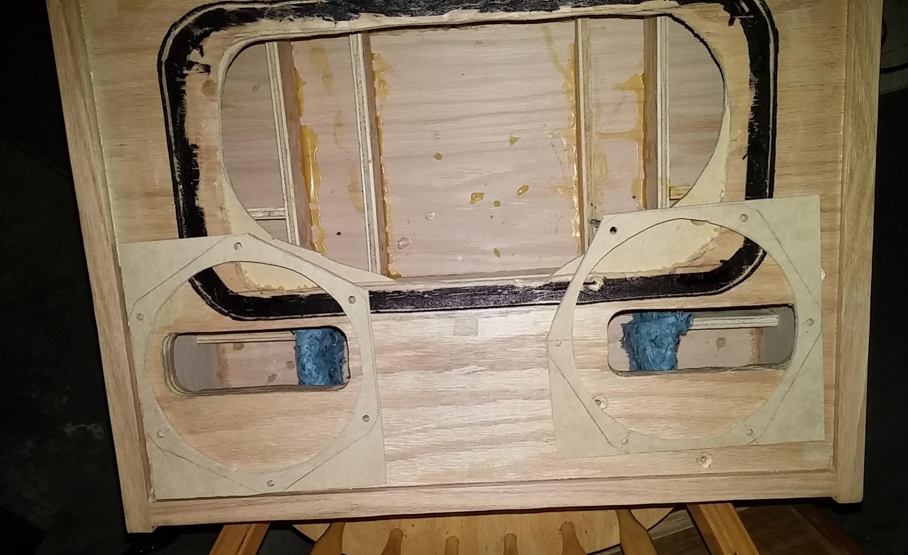

I have quite detailed drawings (attached) and some photos of the ported version, was going to go back and make similar drawings for the sealed (though I haven't yet). The sealed box is much simpler, though, not hard to figure out -- I just made a box and then added 2" high stiffeners so there were no unstiffened rectangles more than 7" on a side (leaving room for drivers of course). If I get the driver issue resolved (I have a pair of DNA360s on the way to try), I may still build another set of the sealed. Will probably use 'complex braces' for that, to make assembly a little more straight forward.
Note: the woofers mount through holes in the front panel, using bolts (either allen type mounted inset, or flat-head) and nuts -- make sure you drill the holes for the woofers after laminating the front panel and before gluing up the box. And make sure the wood screws that mount the horn aren't long enough to punch into the woofer cones.

Also, here is a photo showing the internal braces/stiffeners on the sealed version -- just some 1/2" x 2" plywood slats, cut to fit on the back panel and to the walls. I just trimmed them to size, put glue on them, and forced them into place (and laying various heavy tools down on them to hold them down while drying where it seemed necessary). That could be done in a more elegant way, though -- I just did that because the back panel seemed pretty resonant after I first made the boxes. I also wedged stiffeners to subdivide the top,bottom, and sides, but I don't know if those were really necessary. Make sure you leave room to be able to get your hands behind the woofers for putting the nuts onto their mounting screws.
You can also see where I stapled a sheet of cotton insulation and layed several layers of it over the braces behind the woofers, so they wedged between the woofers and the back panels. Also (not shown) I had several sheets behind the tweeter driver so it wedged between there and the back panel, to keep everything damped and quiet. In the ported boxes, I used those extensible felt furniture gliders, and those were a lot easier to adjust.
Thank you for taking the time to respond so thoroughly. The plans are very well done! Bracing makes sense, as does the layering of the sub-baffles. The extending furniture gliders support the magnets of the driver and woofers?
