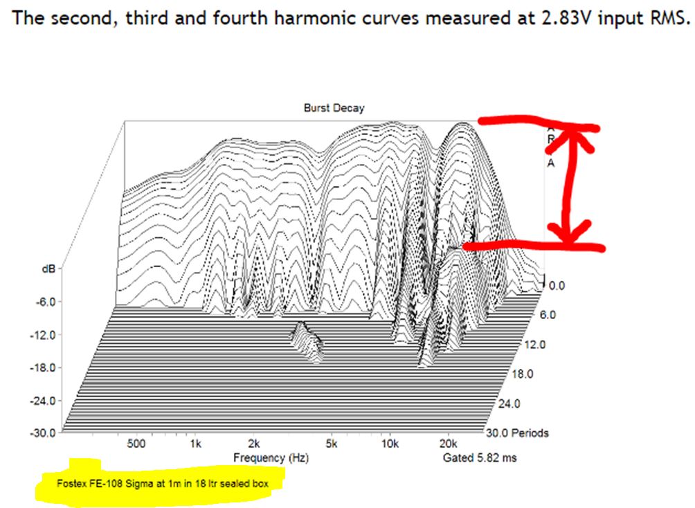

Sibilance is causes by resonances in the upper treble which can be measured by looking at various acoustical measurements. Mainly it will show up in a cumulative spectral burst decay but it will also show as anomolies in the off-axis response. A great website to how much one driver varies from one to another is the rutcho website. If you scan through the various drivers you can see the spectral waterfall plots that shows resonance (stored energy).
Loudspeaker Raw Driver Measurements
For example if we look at the older Foxtex FE108e∑ it has good decay in the upper treble.
Fostex FE-108 Sigma Fullrange Loudspeaker Measurements Data and Information Full Range

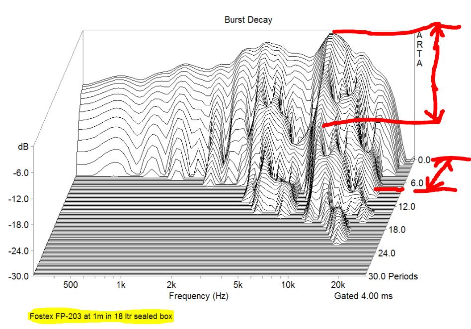

However if you look at a larger driver such as the Fostex FP-203 you'll see an unacceptable resonance at 10kHz
Fostex FP-203 Fullrange Loudspeaker Measurements Data and Information Full Range

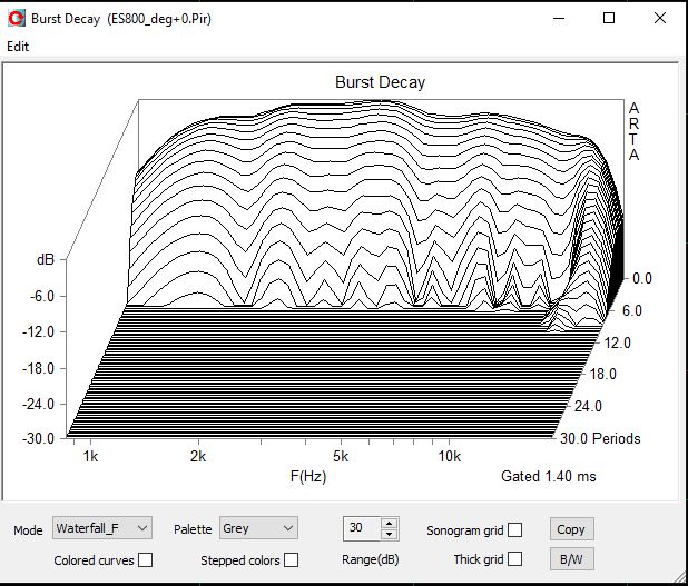

I should note that all of these fullrange drivers exhibit pretty average burst decay results. I've attached a burst decay in ARTA that would be considered by most to be very good.
