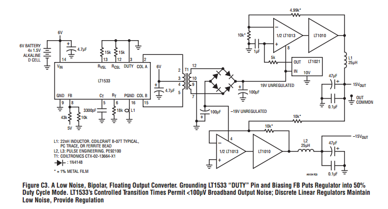

That one has some similarities with the Silentswitcher....Nice schematic and ultra low noise/EMI. In fact a very nice chip with good specifications. LT3042 would be a good companion.
But no 115V/230 mains input...I suppose adding a 6V transformer, rectifier and filter cap for 6V DC is no real problem but apparently the classic transformer is heretic in audio Since mains fed without transformer is forbidden at diyaudio.com we might as well make this a classic/SMPS combo so with the dreaded transformer as there is no other possibility for DIY. I sure see some possibilities here. Adding a third output voltage seems no problem with an LT3042 set at 5V connected to 6V directly.
http://www.mouser.com/catalog/specsheets/213664es.pdf
5V @ 0.2A plus +/- 15V @ 100 mA max. that's a whopping 4W. Low power rules I was planning to stay away from this thread but I will put some time in this.
BTW the transformer in the schematic IS split secondaries but it's not drawn like that.

An R core transformer has relatively high primary-to secondary capacitance. Wether this is acceptable or not depends on the whole system.
Use a transformer with split secondaries and LT3042 regulators. The "duty cycle" pin controls...
I see very important possibilities missed in this schematic. With center tapped push-pull topology at switching off a very high and fast impulse is created. This wastes power and generates EMI. Instead of this a simple series LC resonant coupling could provide low loss, low EMI, low primary to secondary capacitance and low droop at the same time.
I dealt with only the transformer section, since I think the main purpose of the circuit is isolation. Why not to do it well then?
Data sheet of LT1533 specifically mentions it was aimed for greatly reduced conducted and radiated EMI... To my surprise the chip is designed in 1998.
"It" you mean the slew rate control. But I talk about the power converter topology. "Reduced", yes, compared to hard switching solutions, but I talk about soft switching, resonant converters. In this millenium hard switching PSU is out of the game when low EMI is important.

I repeat: ZVS, LLC. If you prefer perfection over simplicity: full bridge. This can already be better than the LT solution (both in terms of EMI and efficiency), but you can further decrease EMI by CM choke, shielding, symmetrical transformer, RF grounding.
The 100 uVpp as they measured (in differential mode voltage, after additional filter) doesn't describe EMI compatibility. Common mode current is what counts.
They say only minor increase in loss. But what does this mean? I found one overall efficiency spec in that datasheet:
