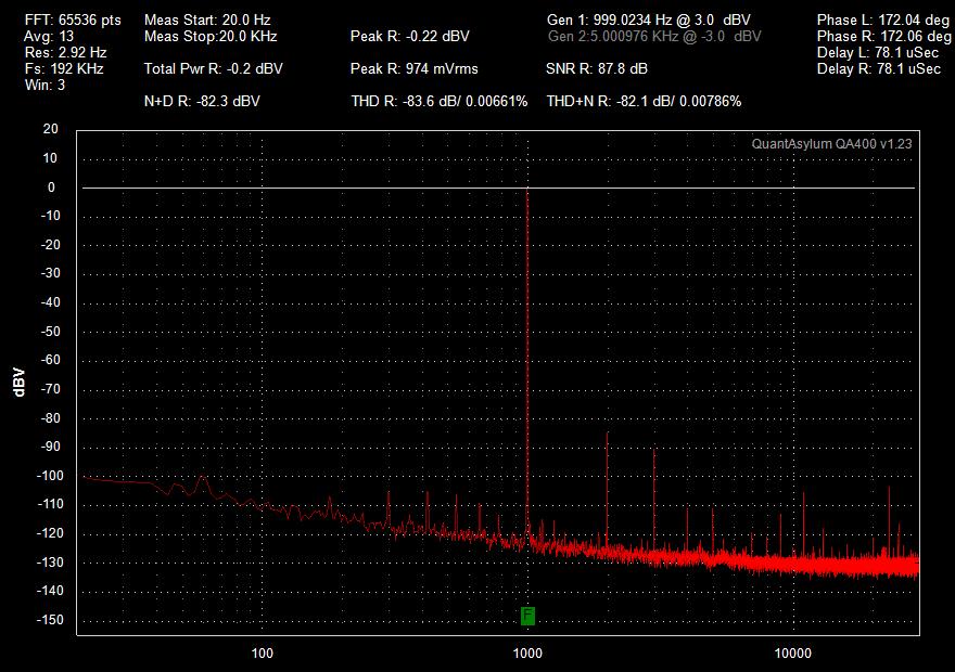

I actually used a flatpac on a juma inspired F5:
F5 with 2SK2013/2SJ313
Measured really well too (attached).
I think the ripple was up around 200kHz if I remember correctly.
It is kind of a little off-topic, sorry, Juma.

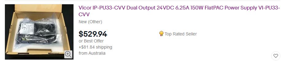

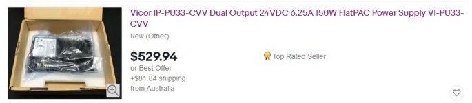

Hi Anchan,
those flatpacs still look kind of pricey - I mean, people around here scream about intolerably expensive Lateral MOSFETs for about 5 bucks a piece, let alone $500 for PSU... :cannotbe:
(today's ebay screenshot)

Yeah that's totally insane pricing. Not sure what's up with that ebay seller. But as Pchw mentioned, they are possible to get for $60-70, even less than that sometimes. If fact if you search for flatpac right now on eBay you'll see many for that price, just not in dual 24V configuration. You kind of have to scout around from time to time. Of course they're never around exactly when you need them lol, but search around once a month or so they def turn up cheap.

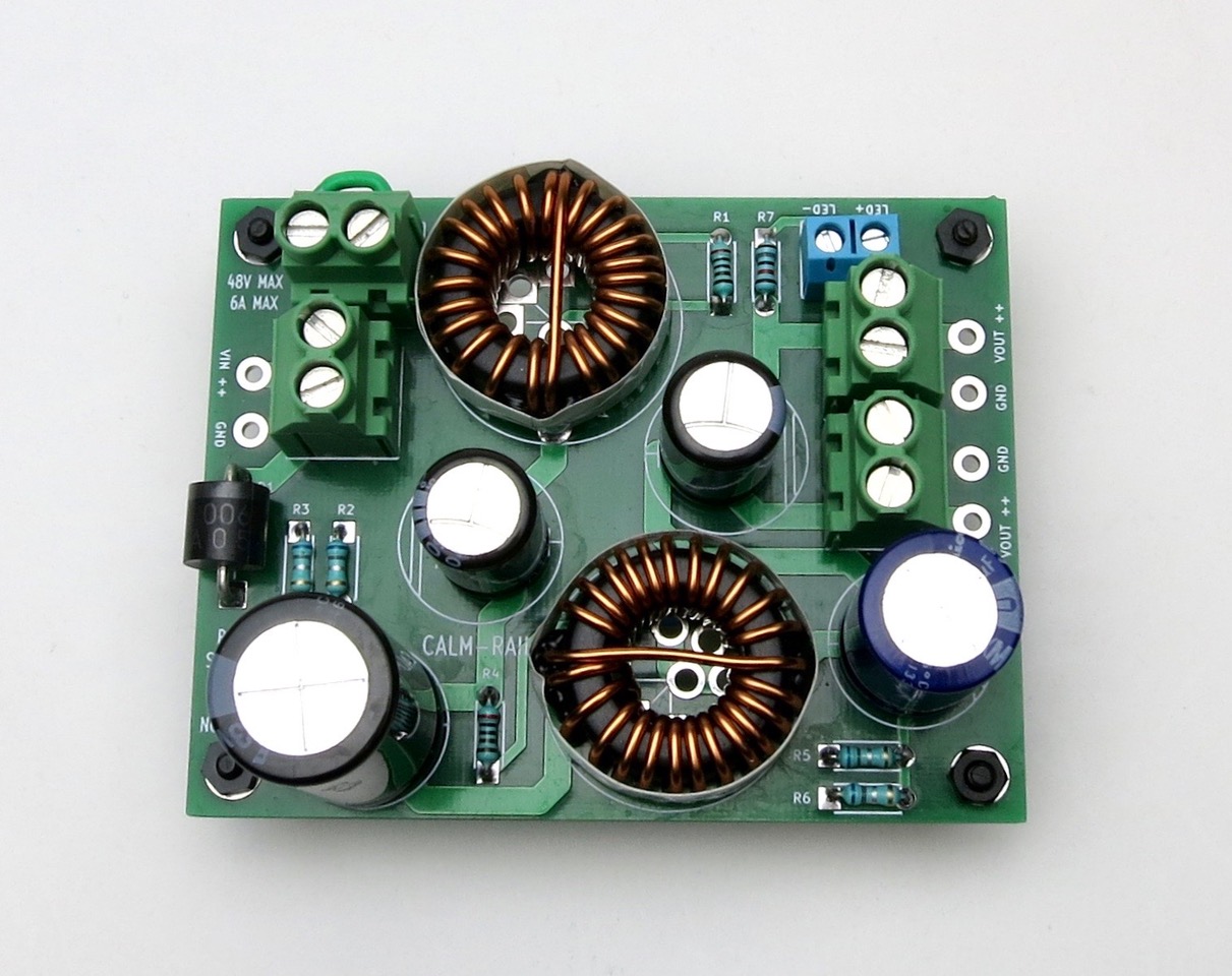

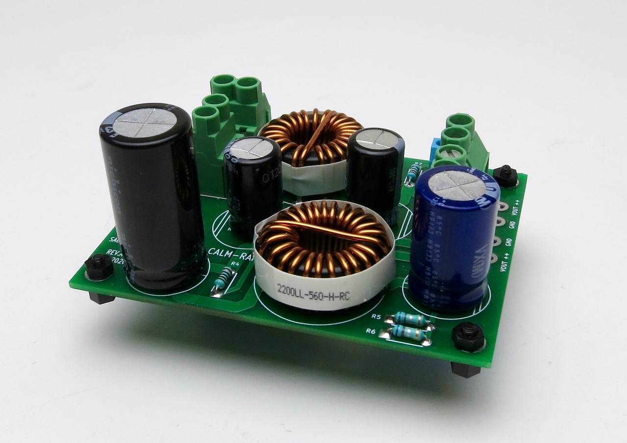

Got the higher current four pole filter ready for testing. PCB silkscreen says "6A max" but that's with the third best inductors. With these first best inductors, the ones shown in the photos, it'll handle 9 amperes just fine. Total in-to-out resistance is about 0.04 ohms.
It's still a prototype and it could need revision(s). But it's an example of what is possible to do.
