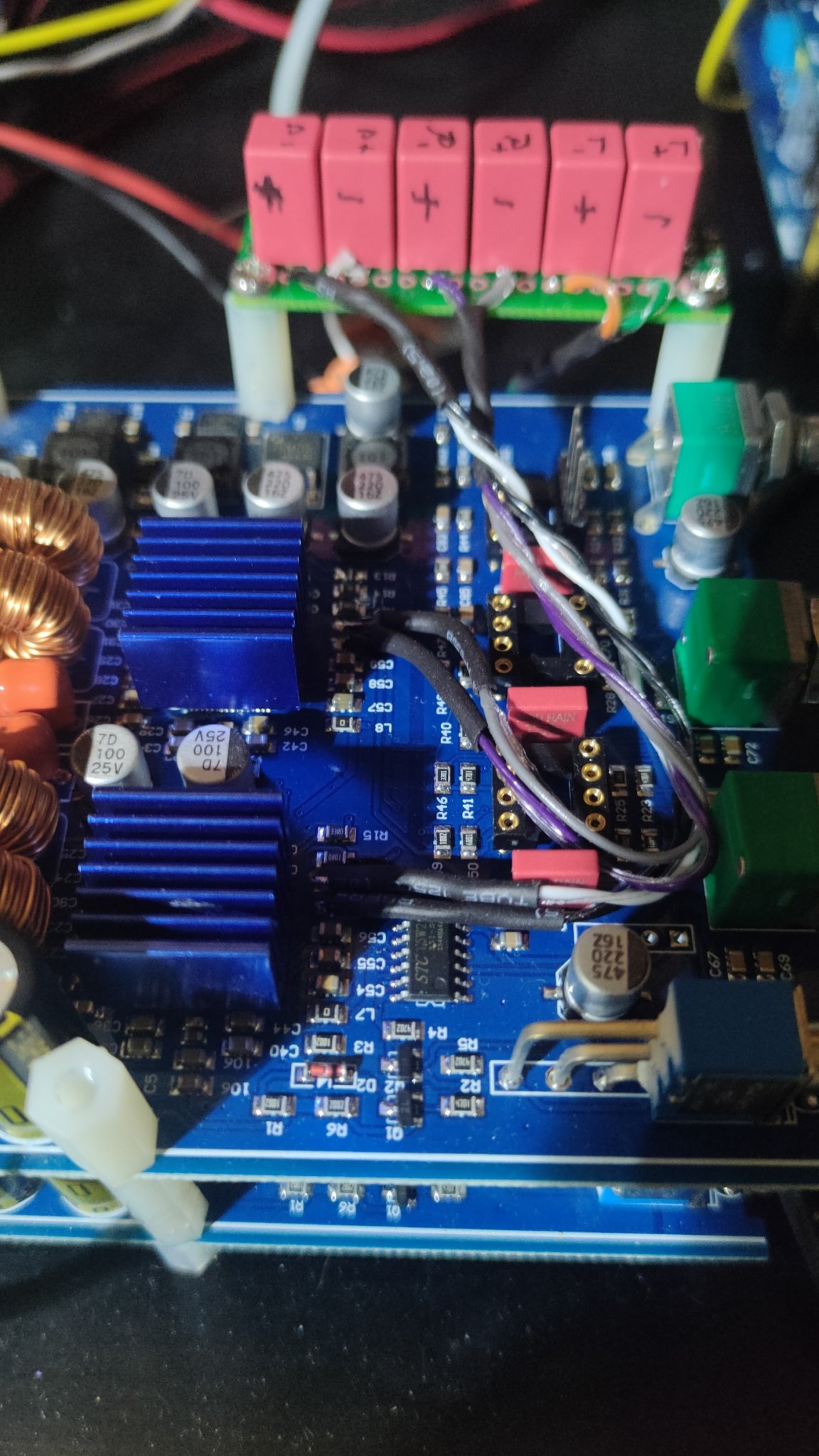

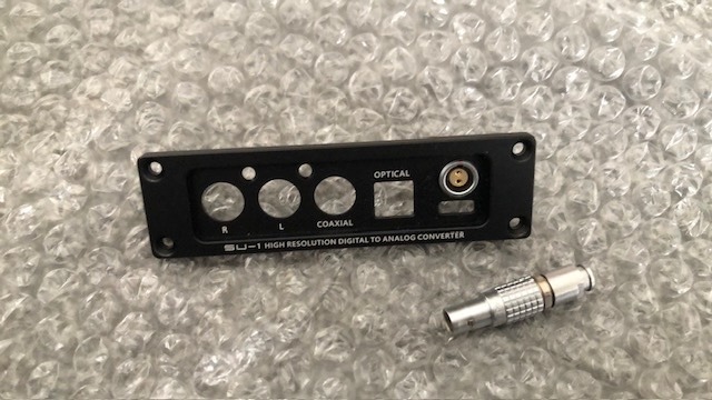

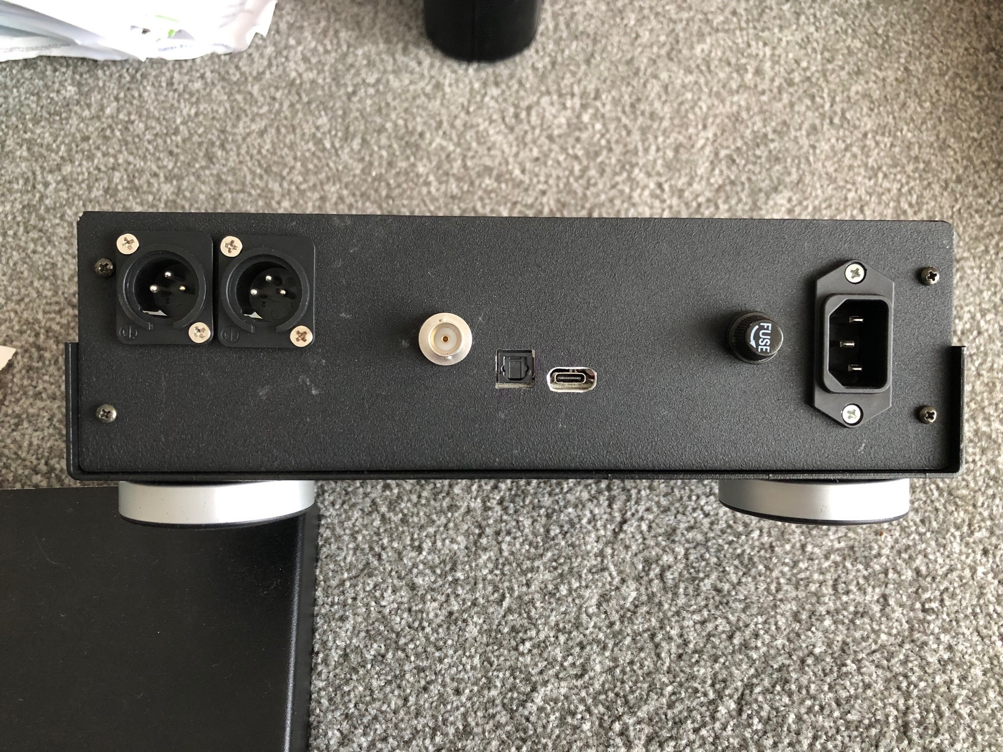

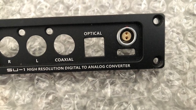

After a period of health issues and thinking diyaudio should better be left to fresh new DIYers (where are they?) I decided to ask if my diyaudio.com account could be enabled again. As doing nothing and not being able to do much creates boredom one returns to old habits but then adapted to the situation. A brand new but damaged AK4493SEQ based SMSL SU-1 (defective output stage) was about to be recycled but then I thought to do something useful with it. Also left were a pair of Haufe quality 1:1 line transformers worth more than the entire DAC. This way the output stage is nearly completely passive and also now the possibility occurred to have balanced outputs via XLR. I added a SPDIF transformer and of course USB bus power was interrupted and a very good ultra low noise linear PSU was used instead. Since there was no opamp output stage anymore the original internal +/- 12V switcher was sent to where it belongs. On the 5V input pins of the retired switcher a Molex KK was fitted to power the power on LED.

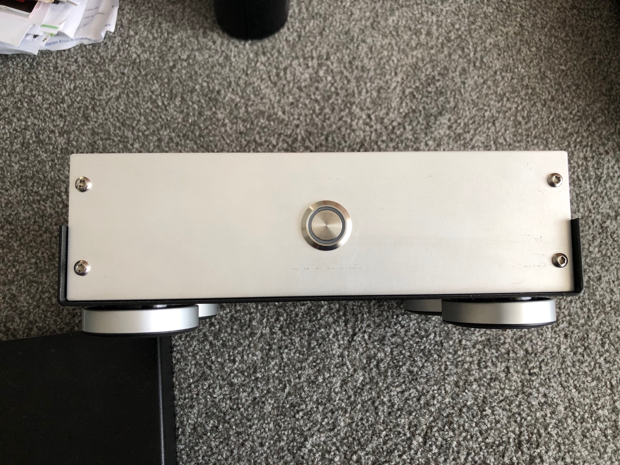

All work was done with hand tools. All functionality of the SU-1 is retained except the source indication LEDs that are located on the main PCB are now invisible. The power switch switches the device from standby to powered on with a white glowing ring and a short touch switches inputs.
Publishing is only to show what can be done to make a SU-1 really shine. Due to my non optimal situation a perfect esthetical finish was not possible. SU-1 absolutely benefits from an external linear PSU anyway. Although it is still in testing phase (and not 100% electrically safe, I know) it already sounds better than an Eversolo DMP-A6. To solve is a slight humming issue when no music is playing.

The minimum to have SU-1 performing better (arguably as many things are already excellent measurement wise) is to interrupt USB bus power and to add an external linear 5V PSU preferably with excellent connectors and not the miscast DC jacks "because these are standard". They are standard because they are cheap, not because they are good. Just like USB bus power is cheap and not the best way, switchers are cheap but often not the best way etc. etc. The influence of having clean power in the total should not be underestimated.
On the other hand even simple quality parts today are often more expensive that the device itself. At least that is the situation here. It all depends what challenge the owner sees in getting the best out of a device.

What is the reason for this? Removing the mute chip from the signal path? And in general, how does the SU-1 behave without this chip: any noise, clicks when switching frequencies, something else? Thanks.To solve is a slight humming issue when no music is playing.
I've had a similar idea to use(repurpose) the little SU-1 DAC. I'm toying with the idea of incorporating it into a custom preamp that would then allow for digital inputs, along with analog. It's so small it would comfortably fit into another enclosure as well. I could then include a better analog PSU into the design. Maybe I'll make it a 2024 holiday project. 🙂 At $79USD it's a true bargain. BTW, tariffs (consumer tax) are likely coming (to USA) so better buy our China parts now. 🙁
To clean up the signal path and as things was broken between the output and the dac chip on his DAC, this had to go also. A semiconductor relay at the outputs are never welcome but sometimes necessary due to blips and blopps when e.g, changing Fs or switching off an on the unit - thats why they are there. And thats what you will get most probable if you remove them.What is the reason for this?
I certenlky concur on the benefit if a silent and steady power source - it is important. I changed the Vref caps to the double size and found that as important as the power source. I also decoupled the power to the OP-amp with a couple of 10uF Wima.
They now sound very nice indeed - I use two in an active 2-way system.
