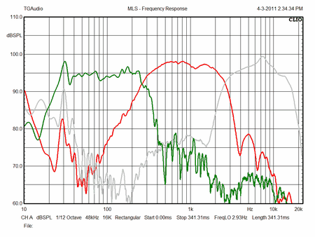

Troels has measurements. The woofer is 10" sealed (acoustic suspension)
http://www.troelsgravesen.dk/SnellA3i.htm
Nearfield of individual drivers. Room response remains a mystery... (30Hz peak must be room mode)

Yes it is the room response + loudspeakers here, so hard to see but where the acoustic cut off is. He has a 17 (or 20?) squaremeter room iirc. All his loudpseakers are tailored in room for the bass as far I know, so we don't know really cause soundcard delay doesn't allow measurement really below a certain threshold (200/300 Hz ?).
He uses a grossly approximation of room gain from a ScanSpeak Excel spreadsheet. He doesn't use REW to measure room response alone as far I am aware of... (and even so the excitation of the room whatever REW is certainly not an easy precise task. Needs high spl level and capable drivers in thelows for that)

The measurement in my previous post is true nearfield with long gating. Notice that also mid and tweeter responses show similar peak at 30Hz
"Nearfield response of drivers driven from crossover. Disregard the relative level between drivers as I was only interested in rendering possible points of crossover. The bass response was measured with the microphone as close as possible to front grille. The bass upper roll-off more seems like 6th order acoustically from this measurement."

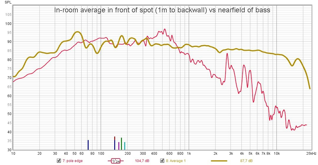

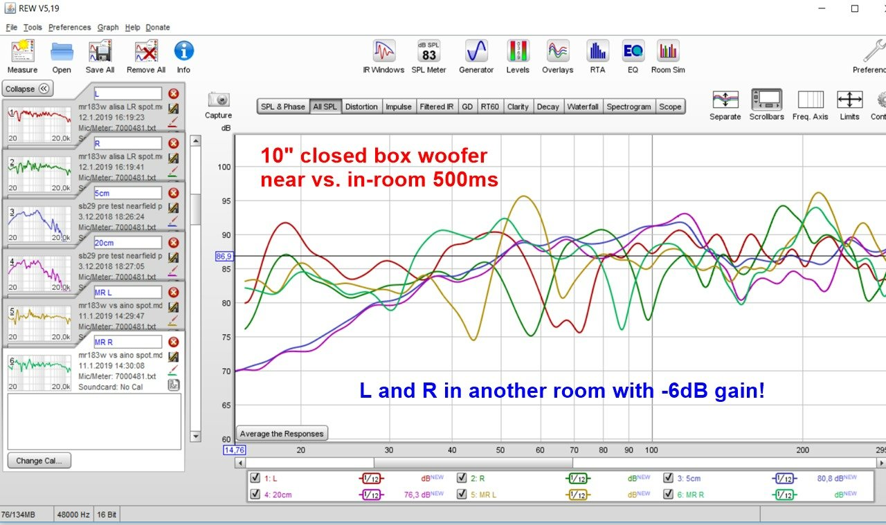

Here an example how my MR183 nearfield vss. room response look (SB29NRX)

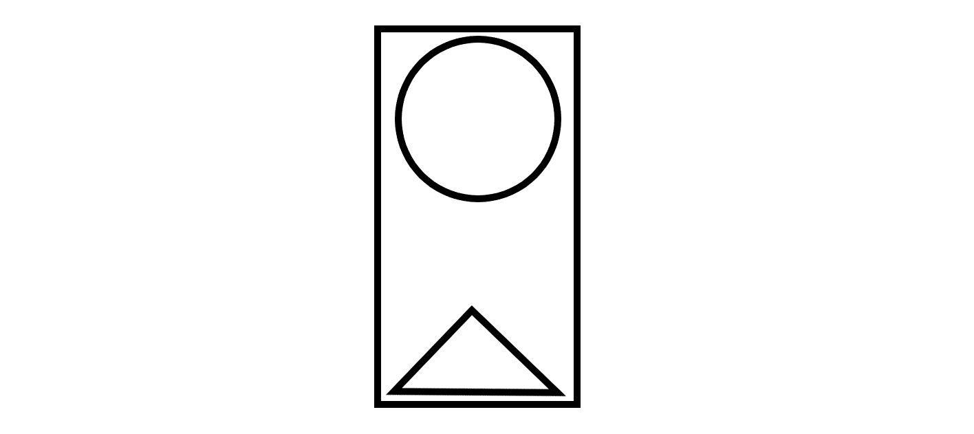

how about using 2 drivers, one at the top (close to the mid) firing forward , one at the bottom firing down.
That's what I proposed before like a Kef 104/2, Kef 104/2 has a central rode but you can use the fixing screw holes for the task to allow close coupling and vibration cancelation.

6 Th order ? Is it a band pass or a fire wall stiff filter ? I wonder....
I think Troels surmises it's a combination of the crossover plus the slot loading, which I'm not sure this is even the right term. It's not a substitute resonant port... but you know what I mean.

About 30Hz peak in TG measurements, it must be ambient noise that induces a room mode.
Slot height in downfire - it makes basically a waveguide like effect. Perhaps one can calculate it with Hornresp ( I am not smart enough). But another effect comes from the nearness of the wall - no front-wall interference nulling but delayed max amplitude in impulse/step response which is easily corrected with dsp by adding delay to mid and tweeter unless the xo is very low alike a subwoofer.
Another interesting trick is used in D&D 8c - put woofer(s) on the backside of the box! So, this kind of speaker calls for dsp and a competent installer who makes in situ settings based on measurements! D&D and my AINOgradient xo at 150Hz, Snell and my MR183 around 250Hz.
