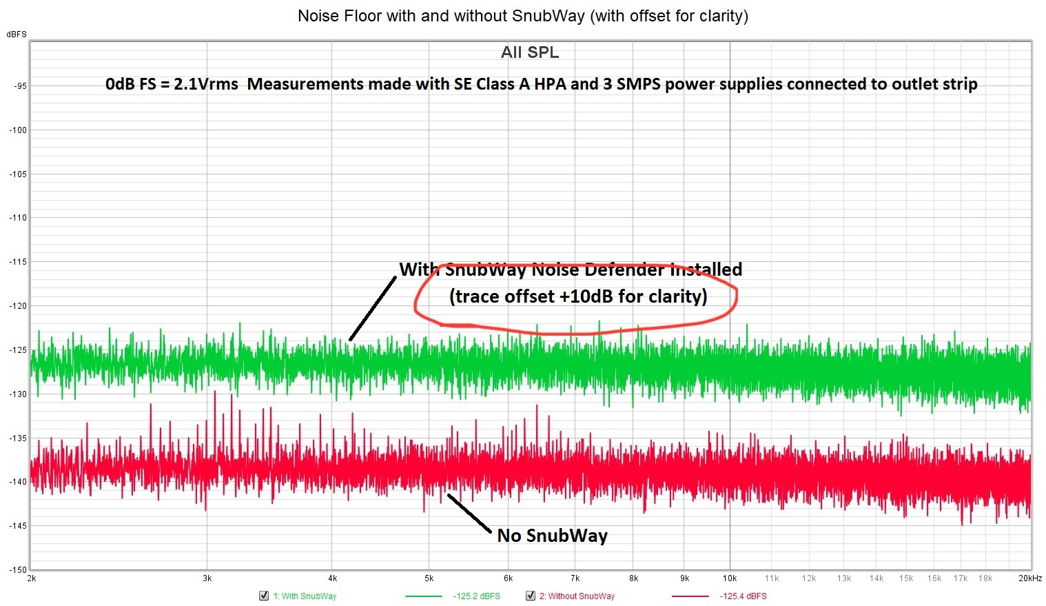

Recently, I have made tests using a spectrum analyzer to look at the noise floor of the audio output of real devices to see if the noise floor can be improved by plugging in the SnubWay. I had a small SE Class A headphone amp (LuFo Lite) repaired and so I thought why not look at its noise floor. I was pleased to see that there was some 3kHz to 5kHz “grass” on the noise floor that was subsequently cut down by the SnubWay.
Above is a photo of the test in progress. You will notice the funny lampshade on the LuFo Lite (needed to cover the bright halogen bulb acting as resistive loads in the signal path). Here is the closeup of the noise floor cleanup:

Here are technical details of the testing:
Spectra were acquired using 256k length data sets acquired at 192kHz and FFTs processed with Blackman Harris 7 window function with 16 averages. Focusrite 2i4 USB audio interface and REW software. 100kHz 8th order passive brick wall filter on FFT input to prevent data aliasing from high frequency content. FFT scale: 0dB FS is 2.2vrms.

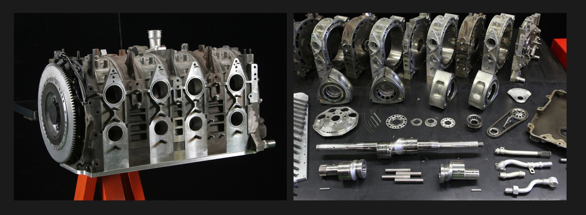

Great design, love the rotor profile, loved that car as well, never a P fan so the 917 was impressive, just did not like the brand.
Reminds me of a short track oval race car built in my home town in the 70's. Aluminum monocoque chassis, 4 triple cylinder 750 Kawasaki engines made into a pancake engine, twelve expansion pipes, stupid fast, ear bleed loud and not a pleasant sound in the least. One race, stomped all the regular and very high tech V8 powered cars, permanently banned. Guy never paid for the one off chassis build, I knew the amazing builder.
