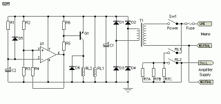

Could we use an AC/DC Converter instead of that transformer and rectifier stage? Like ;
https://uk.farnell.com/tracopower/tmpm-10112/psu-pcb-mount-10w-12v-0-83a/dp/1772176
I never saw these kind of converters which use for soft start product? Is it has any disadvantages ?
Best Regards
Tracopower has temp. and overvoltage protection.When we use it on soft start that mean our amplifier transformer also has these protections?
