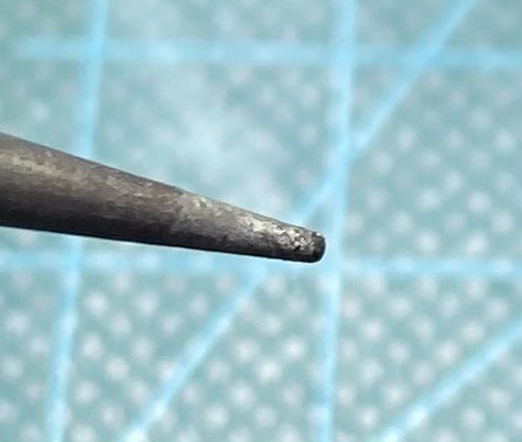

I’m getting great joints with the tip temp set to 325C. Solder flows well and 0805 and leaded components soldering well. I turfed the old bit and put a new one in - the high temps really ruined the coating on it.

Reading your posts has made me look again at my tip temperature settings. Consequently, I realised my current 350C is a leftover from when I was using lead-free solder.I’m getting great joints with the tip temp set to 325C. Solder flows well and 0805 and leaded components soldering well. I turfed the old bit and put a new one in - the high temps really ruined the coating on it.
When I switched back to SN63 leaded solder, I didn't reduce the setting accordingly (lead-free typically needs around 10-15C higher temps than leaded). While I'm getting good results, the flux tends to burn off quicker than I'd like so I'll drop my temp back down to 325C for my next run at soldering. Lets see how we go.
Bonsai, What tip(s) are you using or have tried?

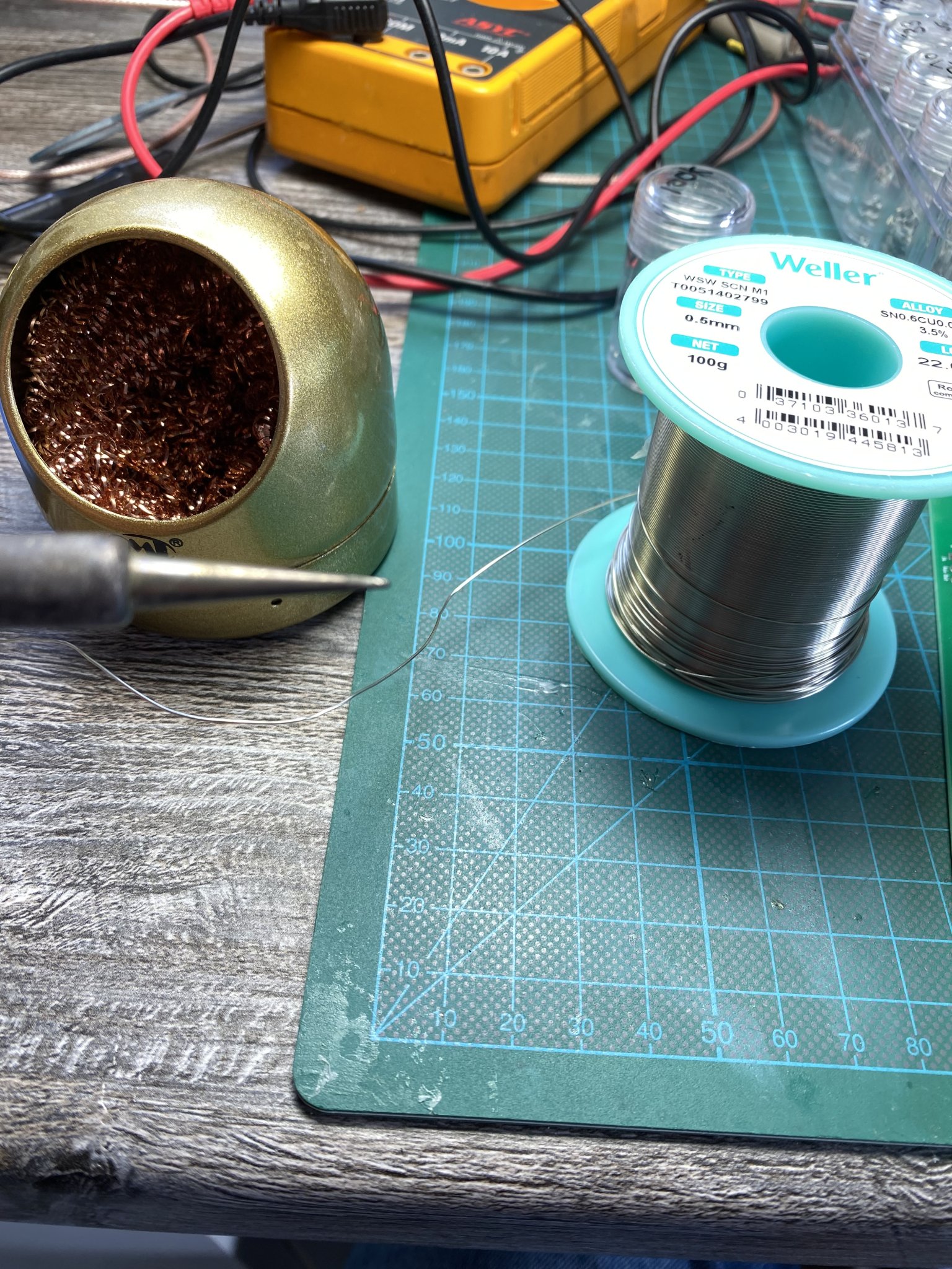

Bonny,
I see your problem. You are holding those two soldering tools wrong. They will work much better if you hold the thermally insulated handles during use! 😉
Andrew, try the 3mm chisel for SMD It works great for 0805 resistors and capacitors. Also for SOICs and SSOPs - using a drag technique you can complete these two packages really quickly and neatly. Have a look online for this.a conical for SMD and 3mm chisel for THP.
