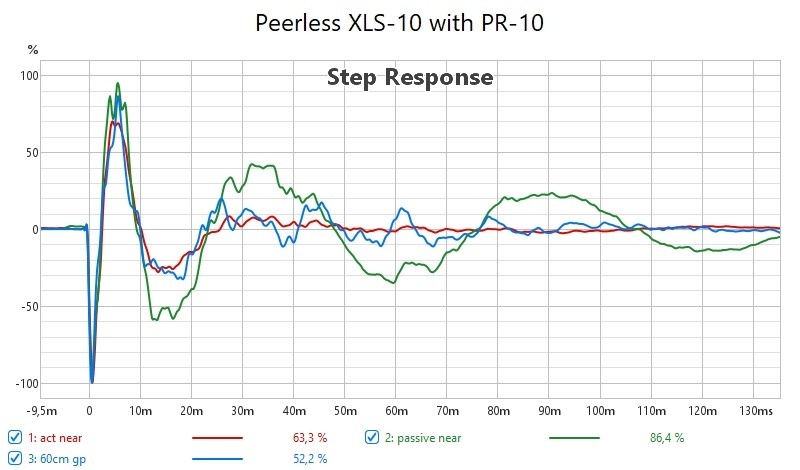

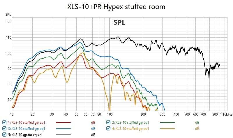

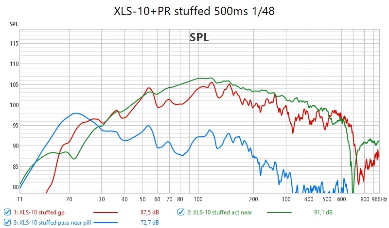

In this case it's more about knowing and understanding the limits and boundaries.
You leave a bit of performance on the table by limiting the system by the PR excursion (again in theory).
Since the woofer has the potential to do (a bit) more.
There is no right or wrong in that.
Like you correctly said, each system, design and idea has its own set of limits.
