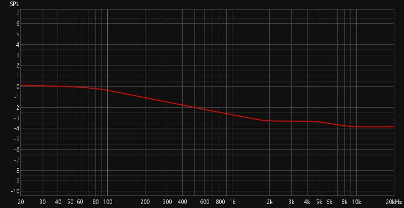

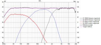

Harman room target curve lands somewhere in the middle of your two options above:My simulations of baffle layout show that I get an acceptable response using either a midrange Sd of 50 cm^2 (4" driver) or 80 cm^2 when paired with the chosen tweeter. There ARE small differences in directivity, but those differences are within the margin of error of the simulation, given the sim is preliminary.
I have not built a cabinet yet, and I have not even defined the exact driver spacing on the baffle, although I have a rough idea. So all measurements, simulations, and calculations are preliminary at this point. As @DcibeL said ...

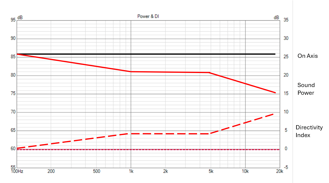

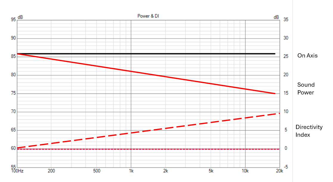

Every decision I make restricts my future choices and options. So I simulate at every stage to make sure I am not locking myself onto a path to nowhere. As I get new information and data, the sim becomes more refined and the margin of error goes down.
At this point of the design process, I am trying to manage the power and directivity performance. The primary drivers of directivity for this type of speaker are (1) the directivity of the tweeter, which has a small waveguide, (2) the directivity of the midrange driver from 1k - 3k, (3) the size, shape, and edge treatment of the baffle, (4) The vertical spacing of the drivers, (5) the crossover frequency and slopes.
Once the cabinet is built and I start to take real measurements, 4 of the 5 directivity influences are fixed, and the crossover is the only variable left open. So I want to manage the power and directivity performance to the extent possible.
There are two styles of directivity I consider desirable. With a large waveguide tweeter and a low crossover, this is what I aim for
With direct radiator tweeters and highly profiled cabinets, I can get a directivity performance like this,
Either style sounds quite acceptable in my room.

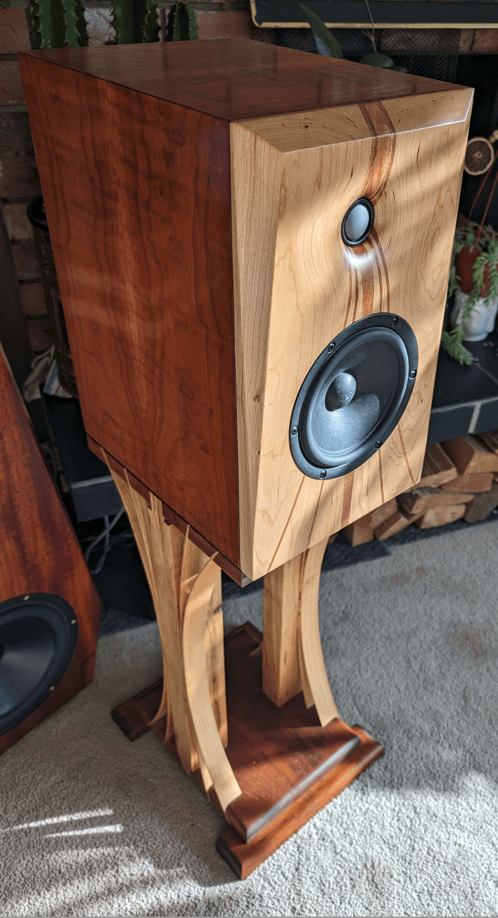

FWIW my latest creation is a 6.5" two way "bookshelf", shallow waveguide on the tweeter and some facets. I landed on a 2kHz crossover with the following power & di:
Full details on this speaker are here:
https://www.htguide.com/forum/forum/mission-possible-diy/953306-atari-it-means-to-hit-a-target

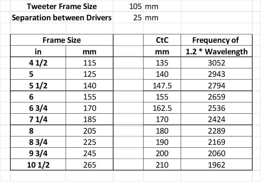

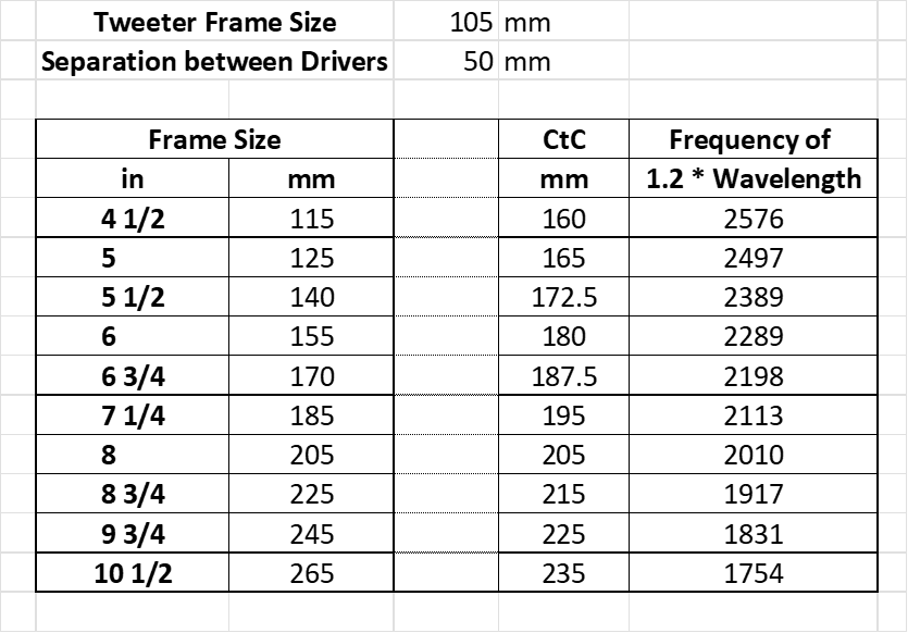

Hello hifijim and All,A little discussion about driver spacing.
My current practice for driver spacing originates with this post by Kimmo, and the following discussion.
https://www.diyaudio.com/community/threads/vituixcad.307910/post-6538511
Among the recommendations, there are two that pertain to the baffle design: (1) minimize baffle area around tweeter (2) CtC spacing between of about 1.2 x WL, although the actual recommendation is between 1.0 and 1.4 x WL. These two baffle constraints are equal in importance in my experience. Doing one without the other will give some benefit, doing both gives the most benefit.
Since being alerted to this important design consideration by @fluid and others, I have designed, built, and tested 3 non-waveguide and 1 waveguide systems using this guidance. In those four speakers, I have achieved my goal of good Power&DI performance along with good on-axis performance.
Maintaining good DI performance through the crossover region is one of the more challenging aspects of 2-way and 3-way non-waveguide systems. This means a DI curve which either steadily increases with frequency or remains flat through the crossover region until the tweeter directivity naturally starts to rise. In addition to the Kimmo guidelines, I use baffle diffraction simulation to help me decide the crossover frequency the approximate crossover frequency early in the design, and this process has typically driven me to a fairly low crossover frequency.
A low crossover requires a wide spacing, and it can look strange, particularly with a small midrange or midwoofer. At higher crossover frequencies, the 1.2xWL spacing is easy to achieve, and is often achieved by accident just by placing the drivers close together. Waveguides often force the CtC spacing to be wider, and this can be an unappreciated benefit to waveguides.

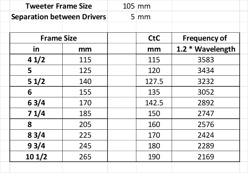

If a standard 105 mm flange tweeter is placed very near a midrange or midwoofer (5 mm separation), the chart below shows the crossover frequency where CtC spacing is 1.2xWL. As shown, a 4” driver could cross to a tweeter at 3.5k with the drivers almost touching, and the CtC distance would be 1.2xWL. For a 6” driver, the crossover frequency would be 3k. I think this is on the high side, but still reasonable.
I also show the results for a separation of 25 mm and 50 mm.
There has been a lot of discussion over the years about the audible effect of crossover frequency. There have been comparisons made and conclusions reached. However, most of these comparisons involved changing the crossover frequency while keeping the driver spacing constant. Thus, there are two effects changing, the crossover frequency and the wavelength effect on vertical polar response, which then affects the Directivity Index, Power Response, Early Reflection response, etc. The only fair way to isolate the effect of changing crossover frequency is to keep the CtC wavelength distance constant.
With this current design, I am using a small waveguide tweeter. The waveguide, although small, controls the directivity down to about 3k, as I showed in post # 6. This allows the crossover to be in the 3k range, which of course shrinks the necessary spacing between the drivers.

I am attempting to sort out this 1.2 X the WL center to center thing in a way that it makes sense to me.
I believe that there are more variables at play than the crossover frequency wave length and the C to C distance.
When you apply the 1.2 X the WL center to center thing to the crossover between a woofer and mid-range driver it becomes a bit of a head scratcher. The center to center distance turns into 3 or 4 feet quickly. (a programmer’s sanity check)
When you make the assumption of point source drivers it adds a bit of perspective. *
Piston drivers are not point sources. Drivers have a coverage angle that narrows with increasing frequency, as the frequency increases they begin to beam. As the diameter of the piston driver decreases the frequency of beaming increases. In terms of frequency and octaves, as the frequency doubles the DI increases sharply above a critical driver diameter to frequency ratio.
Is 1.2 just a happy spot for the 6 1/2 inch driver and tweeter that you selected? What is the 1.2 C to C theory?
* Tolvavn.com/xdir has a widget that plots coverage lobes at a input crossover frequency and a input C to C distance between the drivers. Driver diameter is not variable that is included in the calculation.
Thanks DT
Woops... Sorry for the confusion, and you are correct: 1.2xWL at woofer/midrange frequencies (200 - 600 Hz) are huge, and unnecessary.When you apply the 1.2 X the WL center to center thing to the crossover between a woofer and mid-range driver it becomes a bit of a head scratcher. The center to center distance turns into 3 or 4 feet quickly. (a programmer’s sanity check)
The best CtC distance is 1/4 WL or less. Going a little larger is still acceptable, up to about 1/3 x WL But if that kind of close spacing is not possible, then the next best option is 1.2xWL.
So at typical woofer-midrange crossover frequencies, it is easy to get 1/4 x WL or less CtC spacing.
Again, sorry. I should have been more clear.

I am not sure I can explain it adequately. Three years ago I was reluctant to accept it because it looked so strange. Only after a lot of simulation, followed by building and testing a prototype, did I accept this strange looking layout.What is the 1.2 C to C theory?

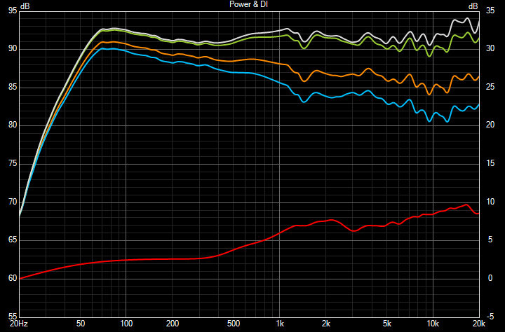

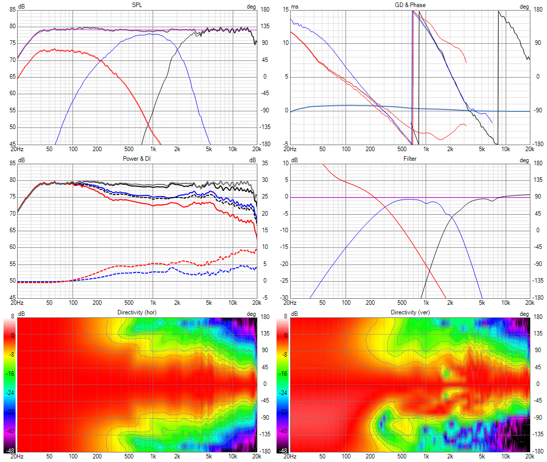

I can show you an example of a speaker with and without the 1.2XWL spacing between mid and tweeter.

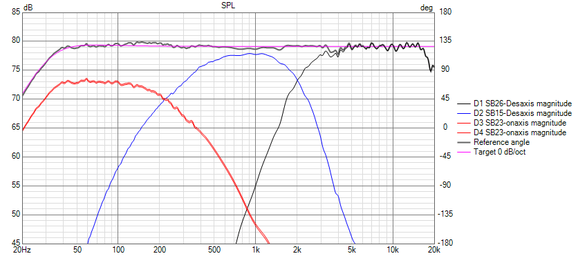

This speaker I made a couple of years ago, and it was the first one I designed with an emphasis on managing directivity from the earliest stages of design.
The baffle around the tweeter is small. It has 1.2xWL CtC spacing between the mid and tweeter, assuming a crossover frequency of 2k. And yes, it looks a bit odd. The crossover between woofer and mid is 300 Hz, and there the CtC spacing between the lower woofer and the mid is about 1/3xWL.
Here is the 6 pack charts for this speaker
The DI curve (dashed red line) has no big jumps or reversals. It stays within +/- 1 dB from 400 Hz to 6k. This allowed me to have a both a flat on-axis curve and a very nice sound power curve, which also means the ER curve and the Predicted In-Room curve (dashed black line) are very nice as well.

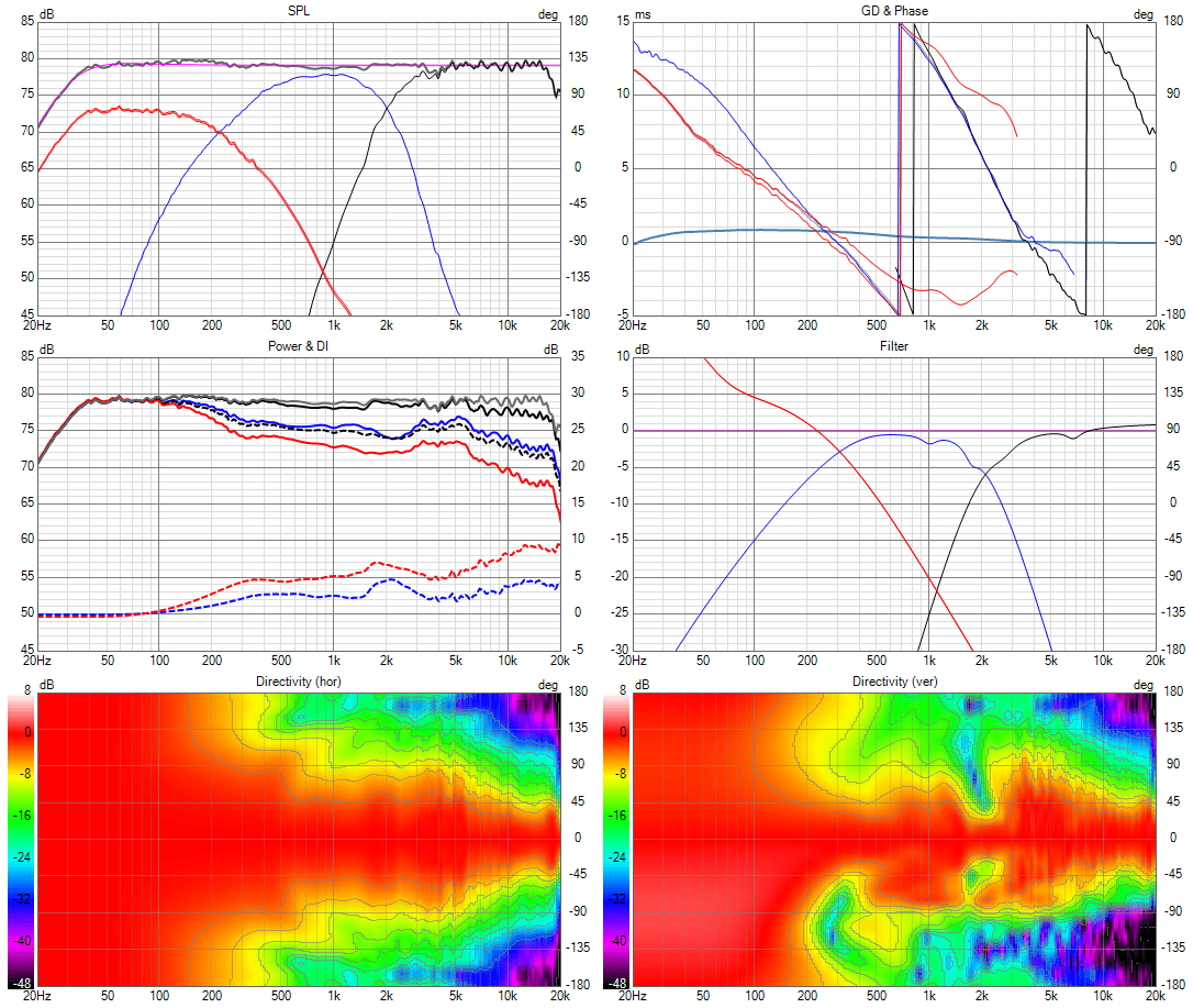

Now i will simulate what would happen if I positioned the mid higher on the baffle so that it would be touching the tweeter.
Now the DI curve has a 2 dB hump at 1.8k. The ER and PIR curves have a dip at the same frequency, and sound power curve has a wide depression from 1k - 3k. Notice the vertical polar response, this is where the change is. There is a deep null aimed at the ceiling at 2k, and this causes a drop in the ER and power curves. Now I don't want to make too much of this, it is a small change, and this kind of change has a small audible impact. Overall, the objective measured performance is still very good, and with the right positioning, the second hypothetical speaker could sound the same as the first. But I believe the first speaker (the real speaker) will be easier to position in the room, and less sensitive to placement.
Does this make sense? Sometimes I fret about providing too much detail, or not enough.
j.
