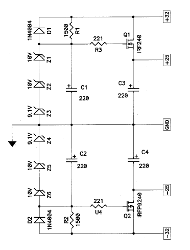

Hi Christer... or someone who can explain..
i need to build a regulated psu.
the zener strings need to be 30V-35V for negative rail and positive rail,
if i replace those zener with red led with 1.85V each led,
that will need 18x red led each rails.
if i use 18x red led with 1.85v
compared with 3x 10v zeners.
which one will results the better.
thanks.
As you have fairly constant current in your Vref chain and not current draw into the mosfet you could just:
1) Have a 30 - 36V zener with a 10R on top followed by the electrolytic.
or alternatively
2) Use a current source to drive into a wirewound resistor to give you a very quiet Vref with the the electrolytic in parallel
I tend to use option 2 mostly
mike

Q2 is upside down.

I thin a 12V zener has got much lower noise than using 16 x LEDs
12V zener reference requires about 5 LEDs which is definitely greater than 0.4uV.

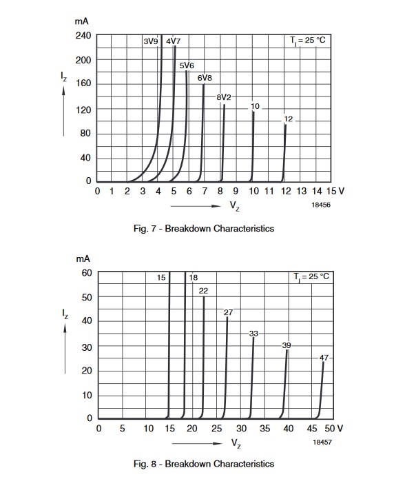

In the meantime he replied why this single Z2V7 specimen only had a voltage of about two volts in the test: it was specified for 80 mA current and used with less, so smaller voltage.
He also sent me some interesting curves from a diode reference book, these may indicate that a 15 V avalanche type apparently has the steepest operation (note the different scale on both diagrams).

Very interesting!
With my diodes I have at hand, some time ago, I measured the slope with a curve tracer, and for low voltage true zener ones the slope always are curved like in the ones show in your post, and with high dynamic resistance.
But the one with lowest dynamic resistance I measured are a old 6V2/1W from Philco with nice round case (like some old Fairchild). All the higher voltage ones measured higher than it.
About tempco, some literature about it mention the "mixed" ones (5V6-6V2) having almost zero tempo. Having built some simple LDO PSU using 5V6 zener in series with a Ge Vbe (the transistor for first gain stage in CE configuration) resulted in a basically zero tempo in practice, and almost zero tempo for a Si Vbe.
Again the tempco will varies with manufacturer I suppose.
For curiosity, I measured some old NOS SiC LEDs from ex-USSR and these have very curved slope with high resistance, and the "normal" old russian red LEDs (these with partial metal cased) have surprisingly low dynamic resistance, but the winner are always the old HP monolithic early red displays (vertical line like the 15V zener of your post; <1 ohm).
