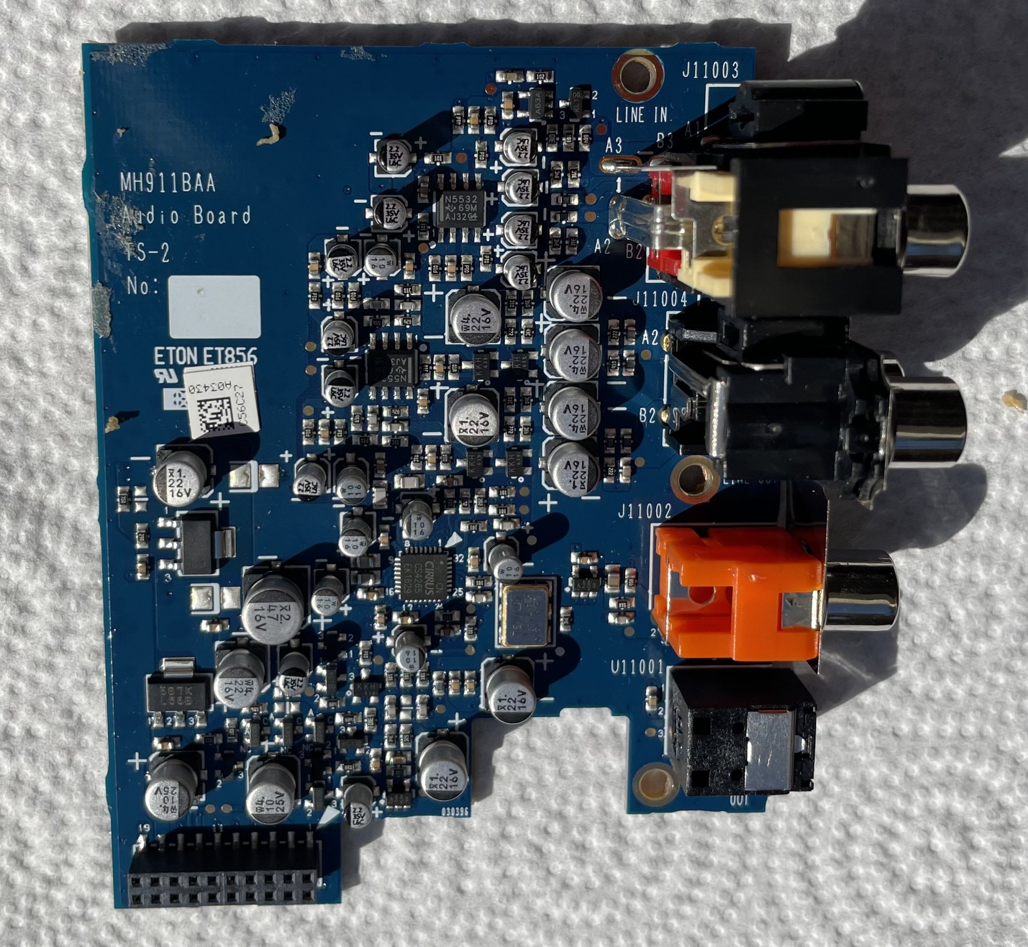

Hi Kenalker. I used an oscilloscope to trace the circuit. I started at the Cirrus Logic chip (link: CS4265). This is the DAC chip that converts digital signal to analog. That analog signal is then amplified. I monitored the analog outputs from this chip and could 'see' the audio signal being output properly from this chip. I then traced it to those two capacitors. I don't know the exact role they play (maybe they shunt high frequency signals to ground). In any event, they are between the DAC chip and the NE5532 OpAmp chips. I wasn't able to detect any signal on the input of the OpAmp chips, and found that replacing both of these solved the problem. As I mentioned here in my earlier post, this fix has worked many times for me.
The first thing to confirm is whether or not the digital signal is working (which you have done). If the digital output is working, then I'd strongly suspect that these caps are the problem. If it isn't working (as in one of your units) then you've got some other kind of problem. I would try to swap the main circuit boards in your two devices to confirm that the bad device has a bad audio board. I once saw a device where the main board stopped sending a digital signal to the audio board. By using your 'known good digital' audio board you can confirm that the main board is generating a good digital signal.
The second thing... I would replace the power supply caps if you haven't already. Based on age alone they are likely to fail soon, and these are cheap parts to replace. The power supplies operate using high frequency SMPS power supplies, not just AC that's been through a transformer and rectified/smoothed. Poor caps could be letting through high frequency transient voltage spikes that you might miss by looking at voltage levels.
In my experience, over 90% of the bad/low/no audio problems are these two caps, but I have also found a few devices that I wasn't able to repair. The best solution I found when I couldn't repair was to use otherwise dead devices. Sonos created a lot of those back when they bricked devices that people upgraded to S2 (before they changed their bricking policy). There were a lot of those devices offered for parts on ebay a couple of years ago, but they are much less frequently offered now.

Hi Zimmi10. Are your replacement caps the same capacitance rating (they look large)? If they are correct, then double check the soldering. These pads are extremely tiny and hard to solder well. Check for good connections, but also check that there aren't any accidental bridges to nearby components/traces.I have changed those 3 capacitors on the power supply board and those 3 on the analog board
Before I had a low volume, now no volume!
Any advice?
It may be helpful to use TP1018 and TP1022... These are test points for the two negative legs of the two capacitors... You can solder the negative legs to these points instead of the original points...this works well when the replacement caps are larger than the original ones.

You should also replace the power supply capacitors. There are 5 electrolytic caps in the Zp80/Zp90 models and they all degrade with time. Try those first.Here's my Sonos Connect (S2 compliant) main board. Same very low analog out volume. Any reccs on which capacitors to replace?
If that does not work, then replace the two capacitors circled here, and you should be back in business. I have done this on multiple devices successfully. Note that this will work only if you have very low output volume on the analog outputs but your digital works. If you have NO volume out at all on analog, then this fix will not work.

Replace the cap that is circled in the image attached to post #6 in this thread.
If that doesn't work, then you have a bad connection on one of the replaced capacitors.
Thanks for the reply, I had replaced the cap marked in post 6 with a 10uf 50v, I re soldered all the caps I replace and still have no volume. What else could be causing this problem?
