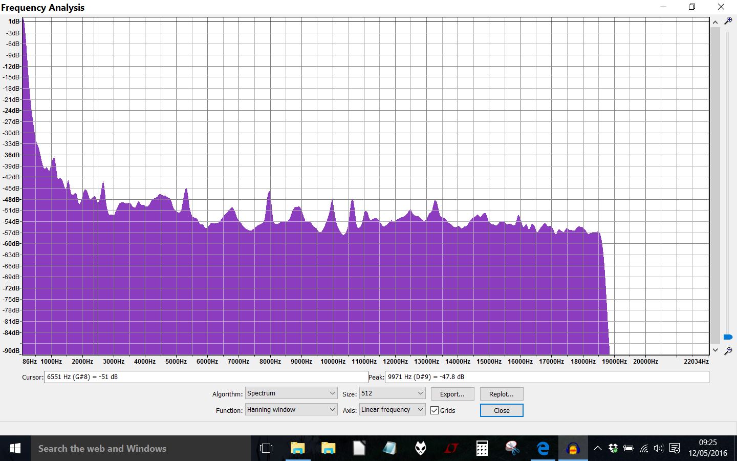

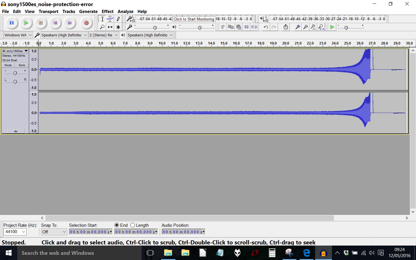

OK, so this is broadband noise generated 'electronically' for want of a better word... and that makes this look like quite a deep seated fault. My initial feeling is that while its certainly fixable, its not going to be an easy fix and it would more than likely require part/s unique to this model.
You would need an oscilloscope to delve into this in order to get some idea of what and where things were falling apart.
All that said, one check that should always be done on ANY unit is a check and confirmation that ALL the DC voltage rails are correct. There will be several in a unit like this with dedicated low voltage supplies feeding the various signal processing sections.
This shows the noise, how it rises and its frequency make up (wideband noise)

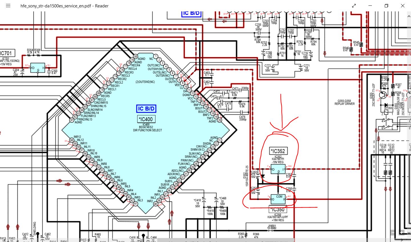

I've had a really good look at the circuit diagrams and my instincts tell me that this one is not going to be diy friendly. I didn't see a backup cap anywhere so it looks like this one uses what's known as NVM or non-volatile-memory.
Having said that, and considering your comments on the UPS issue, I would try two things. If its a case of binning the unit anyway then there is nothing lost...
1/ Measure the important supply voltages beginning with those on the DIR processor. The two supply voltages should be minus and plus 7 volts -/+ 5%. This DIR chip (80 leg SMD or surface mount device) seems to handle most of the processing and if that is suspect then replacement is the only way to prove it. That's not a diy friendly job, you would need to be experienced in working with SMD to successfully swap it.
2/ Years of experience tell me 'its never the big chip' and 95% of the time that's true. Something you could try... again this is risky. Leave the unit unplugged for several hours and then press some tinfoil over all the pins of that IC so that you are shorting them all out. That will remove any remaining charge and may allow a 'stuck' chip to reset when its powered back up. A chance in a hundred but it would be something I would do if it were on the bench in front of me.

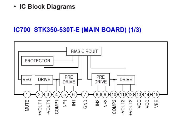

After 6 months I have switched the unit again. This time there was a mixed behavior of doing the same thing as mentioned above, but there were on/off cases where the "protect mode" did not engage. So, I have switched the headphones again and realized that then, the noise came out only from 1 channel and it was constant, not increasing. So the unit remained on...
So what I have just observed is this:
After 5-10 minutes of operation,
Almost all components are cold, including all power transistors, power supply is barely warm,
The only parts that are "very hot" and I mean untouchable are:
IC700: sony part: 6-710-828-01 description: IC STK350-530T-E
IC604: sony part: 6-705-468-01 description: IC BA33BC0FP-E2
The first one is an IC VOLTAGE AMPLIFIER
and the second, is a Linear Voltage Regulator IC Positive Fixed 1 Output 3.3V 1A TO-252-3
Just by instinct, there might be a chance that this IC700 could be the problem (this one also includes the protection circuit).
After a quick search I have found that this is an almost obsolete part but there might be some parts here:
EET Europarts: Sony IC STK350-530T-E
or a cheaper copy maybe?
http://www.ebay.com/itm/1PCS-STK350...2-Channel-AF-Voltage-Amplifier2-/131830318043
You can see that those Sony amps below use the same IC:
DH700STR, DH100STR, DG520STR, DE400STR, K785STR, DA1500ESSTR, DH500STR, K790
and this one for reference: http://www.diyaudio.com/forums/solid-state/98298-data-needed-stk350-530-sip-ic.html
What do you think?

It seems to me that you are continuously focusing on the wrong target ...Both of these IC are supposed to produce some heat Actually every part inside the amplifier is producing some heat the question is how much .....

Parts can run hot but they shouldn't be able to sizzle water as a general guide. If a voltage regulator is producing the correct output (and is also clean viewed on a scope) then it probably wont be faulty as such and its the current drawn from the following circuitry that is heating it.
I would personally suspect the STK module.. it sounds like some odd oscillation to me, and eventually it gets to the point where the protection activates. This protection seems to be part of the STK module as well.
