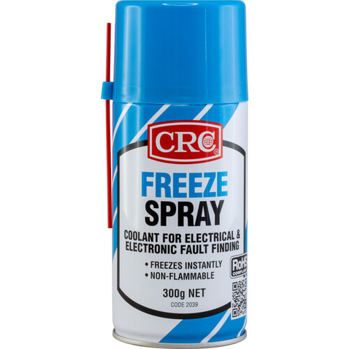

Thinking outside of the box, how about. troubleshooting with...
https://www.chemtronics.com/ultimate-guide-to-diagnostic-freeze-spray

Thank you all for the suggestions. As of now, this is what I'm going to try based upon the advice:
1) I'll try a bit of out of the box testing with some freeze spray and maybe a wooden chopstick to mimic some slight vibrations or pressure changes.. I hope it's a cold solder on where the epoxy modules connect. I'd assume the tech went over this twice given he called me pretty stumped.
