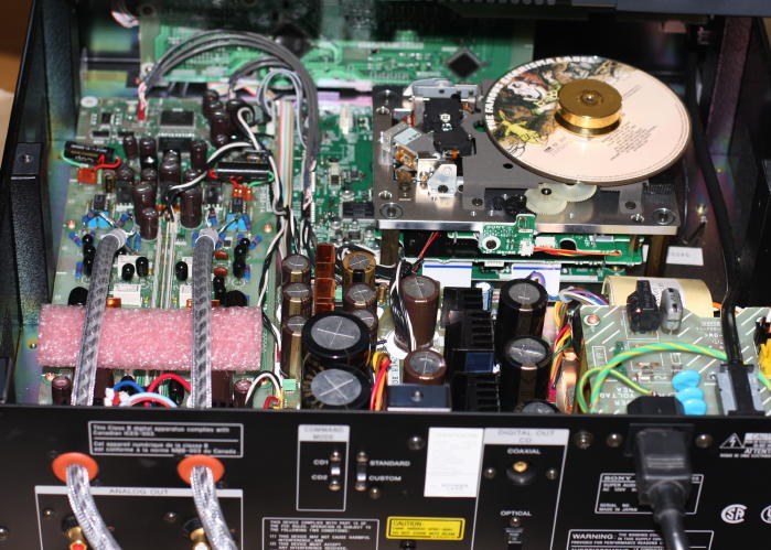

Tonight replaced the stock shielded sony output wiring with vampire tcss wire directly soldered to the rca output jacks, but for now I have retained the plugs and board sockets. Not sure whether this really made a difference or not, but subjectively it does sound slightly more open on the top end, very subtle and possibly not real difference, but no harm either.. 😀
As I have listened over the last two days I realize that this modification has substantially altered the performance of player - it sounds much better cold than it did, less impression of it "warming up" over a couple of hours of use.

I received the 10K resistors for the "mixing" diff amps last night, and had the opportunity to install them tonight. I very carefully matched them and ended up with matched pairs which matched to better than 0.074% theoretically giving a cmrr of about -62.6dBr which with the 1% resistors previously installed is close to a 30dB improvement with worst case resistors - they weren't matched, but they were better than 1% pair to pair.
Did I hear a large improvement? I was able to complete the mod in about 30 minutes, and the changes were fairly subtle particularly considering what these resistors cost so this part of the mod should probably be skipped. The Riken resistors probably sound a little sweeter and perhaps more neutral than most would realize. I think the previous mix was probably optimal, although I won't be reverting.
The player sounds very good, but until I can compare it to another one I am not sure how significantly it differs from the stock player. I do think it sounds more open, smoother and more detailed, but the power of suggestion is a strong thing particularly where the wallet is involved, and I am relying on auditory memory which is not particularly reliable..
Probably just as unreliable, but I have always preferred the back panel "normal" filter setting to "custom" - just the reverse of what I expected in fact. It sounds a hair "glassier" to me in the custom setting, and the mods have not changed this at all. It could be that something in my system does not like the additional ultrasonic energy in the output, or I could be imagining it.
I've included a picture of the interior of the player, not a very good one so no real detail is visible unfortunately. If you look very closely you can just see the sockets I installed for the LM4562 I/V converters which are in dip packages.

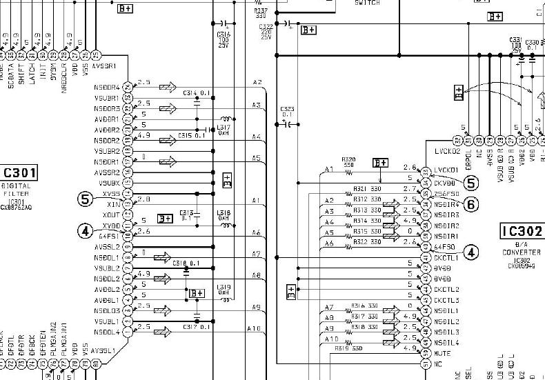

In terms of those 0.068uF I have reluctantly come to the conclusion that I would probably be leaving them alone for some time, one area where the larger film caps really fall down is in terms of their ESL, and even the longer leads required contribute to this - given the impedances involved at this circuit node this cap effects ultrasonic behavior strongly (not audio band) and so needs to be well behaved probably out to beyond the dsd sampling frequency in addition to needing to meet all the usual audiophile attributes.
I suggest taking an analog output FAR earlier in the signal path than the I/V opamps!
These are completely redundant and only add typical opamp colourations to the signal.
Look at the signal between the VC24 chip and the S-TACT, it is pure analog and a simple passive low-pass will turn it into beautiful audio. WE use 18dB/oct at 95kHz.

Thanks for suggestion, I would had certainly tried it, if I could figure out the connections from VC24 chip.
But, the output level here is probably much lower and I would need to use some active stage anyway as my line/amp combo offers 18dB only.
