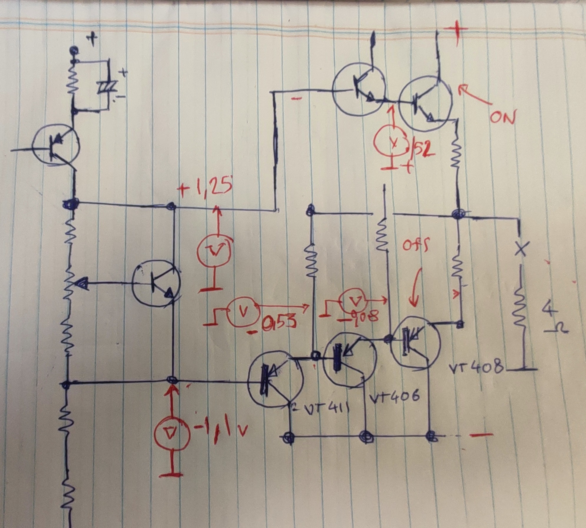

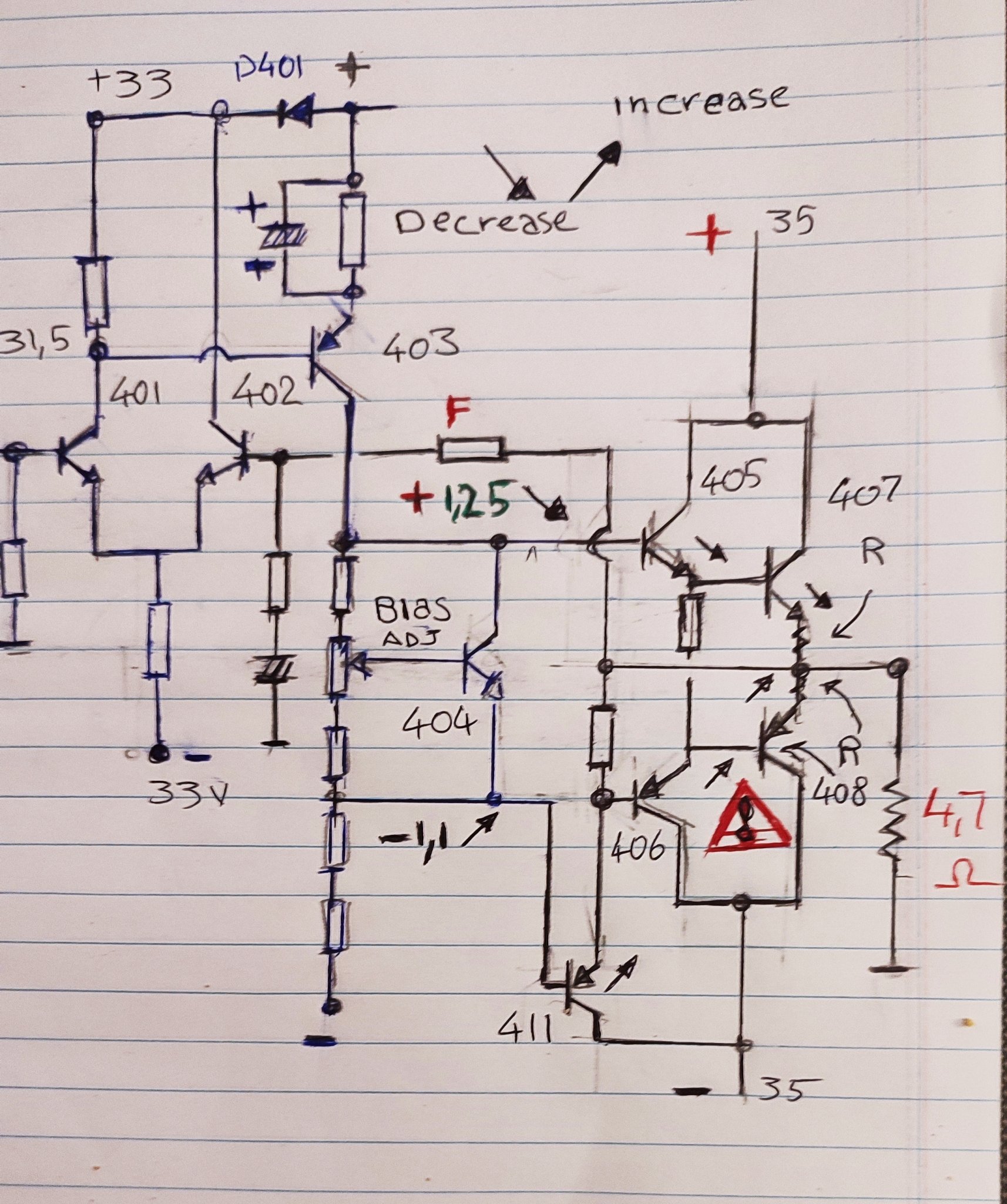

compared the voltages of both channels by focusing on the bases of the transistors. They are all the same, only when connect a 4.7 Ohm 5 watt resistor to the output of both channels, the voltage of the defective channel changed ....in picturs can see v+of c... vt 404 is decrease and -v of e is increase...so bias of vt408 go up and bernt.
The first time..... the Amp was working. And the CD was finished .... it was silent for an hour.Connected two speaker wires for a very short time....The amp turned off .... Fuses and a one of pnp power transistors ... burned. 😢

Assuming your sketch in post 42 is showing -1.1V at base of Q411, please report base and emitter of Q406, and Output--- without load.

. yesterday i remod vt411.... with no loade dc v =good . sound = good and normal
but if use speaker 4 ohm 1.1 v go down + .78 ......bias of pnp power transistor go up and burnt.

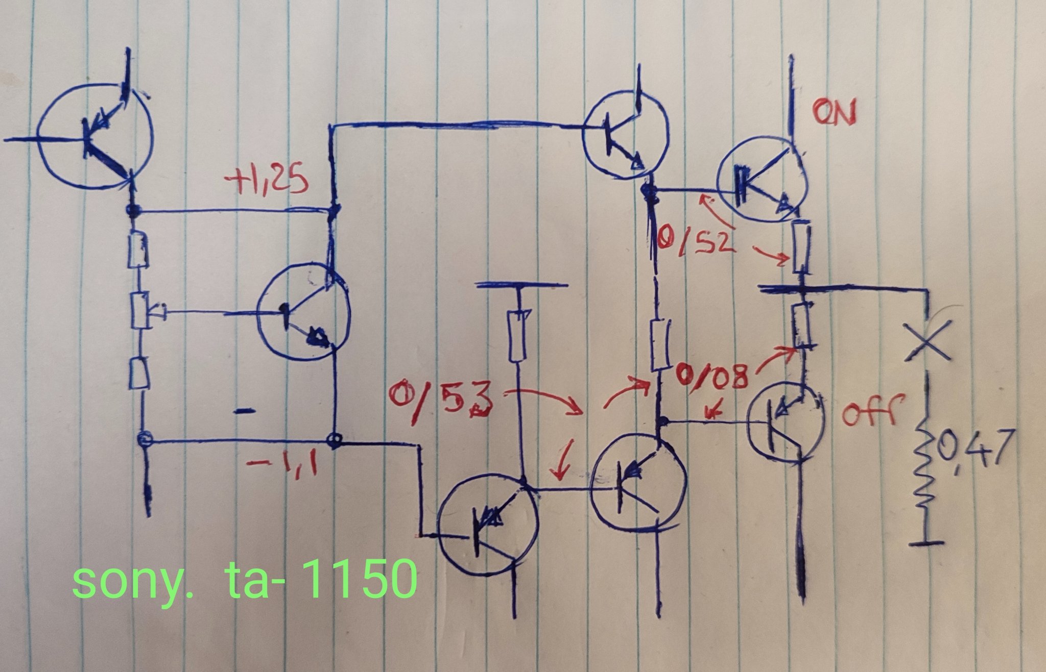

I don't understand your notation: "0/52" at Q407, and "0/08" at Q408. Would you explain, please? In the end, I would like to know voltage at output, and base voltages, emitter voltages, all with respect to ground.
The voltage across Q404 is +1.25 plus 1.1V = 2.35V. This raises the question is the spreader 2.35V controlled by conduction through Q404, or is Q404 not conducting but clamped by parallel path Q405 to Q407 to Q408 to Q406 to Q411? Would you observe where the wiper of VR401 is positioned? An alternate method is to measure the base-emitter voltage across Q404.
1,25 / -1,1 / -0,53 / ON / off are readable.
-908... +152... ???

There are five BE's in series. For proper operation (class AB) one should expect 5*0.6=3V as bias voltage: +1.25 to "-1.7" is 2.95 which is ok; 1.25 to -1.1 is 2.35 is to little.
In #1, the base of 406 is at -1.2V If the base of 411 is at -1.1V, it's cutoff completely.

please....... The main problem is the voltage change of
+ 1.25 in the transistor 403 ... when connecting the load resistance of 4 ohms and less. Yes. I wish Sony didn't make this device. 😢 I decide to add a current source to the bias circuit.

Yes, we've noticed, but it's still unclear what causes this.The main problem is the voltage change of
Can you clearify #47 & #49?

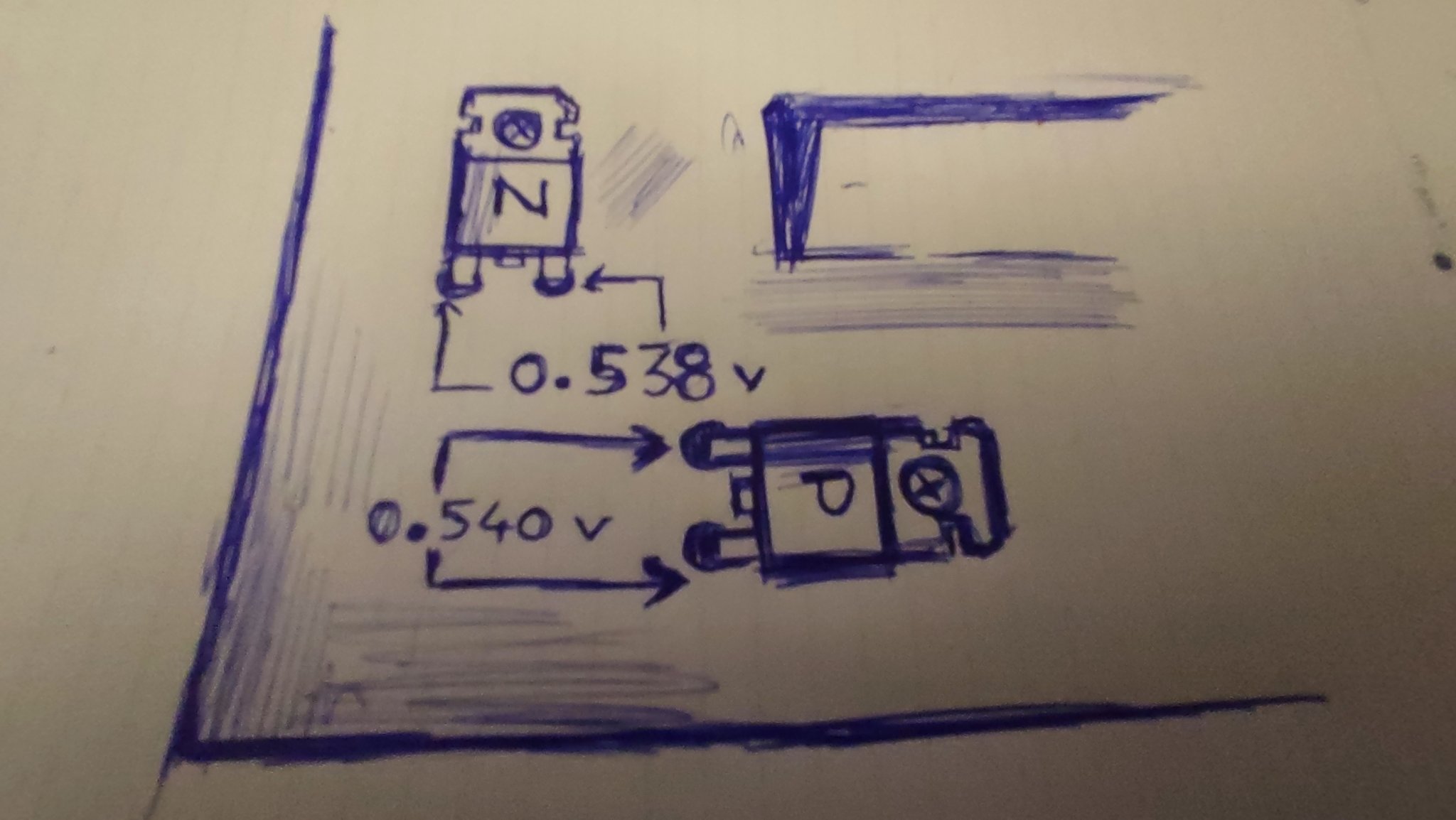

I removed the 311 transistor from pcb and connected the 330 Ohm resistor to 306 base. adjusted the bias. Everything became normal. Connecting a 4 ohm load did not make any changes.good ab class amp.😱😳😡 ..(311 transistor inL chanel.. L chanal has problem )
I don't understand this last comment. If I understand correctly, the Left channel is the working channel and has the 3xx series of part numbers. You have removed 311, rebiased current, and left channel behaves as desired. Did you intend " R channel has problem"?(311 transistor inL chanel.. L chanal has problem )
This is an interesting experiment, but you avoided discovering whether VT311 base (=VT303 emitter) would have settled at -1.7V once bias current was set correctly. Perhaps this mod is OK, but it's not what Sony intended and not a revision I would make. But this is your project, not mine.
