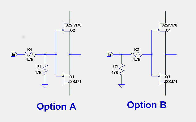

I have noticed all of the FirstWatt designs use the jfet input gate-stopper and input load resistor
shown as Option A below. Why is this done vs. Option B which does not attenuate the input level?
The F6 uses option B. I prefer that one as well, since it minimizes the connections and parasitics at the sensitive gate.
I have noticed all of the FirstWatt designs use the jfet input gate-stopper and input load resistor shown as Option A below. Why is this done vs. Option B which does not attenuate the input level?
When I laid the boards out, sometimes it works out with the resistor to
ground in front, sometimes after the input, probably because it's convenient
and really doesn't matter.
Then I go back and change the schematic.
I can do that.
