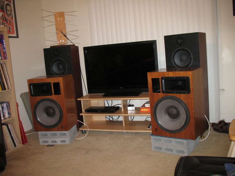

Zombie Thread!
Pi speakers rock!
I mean that literally, they play clean and LOUD!

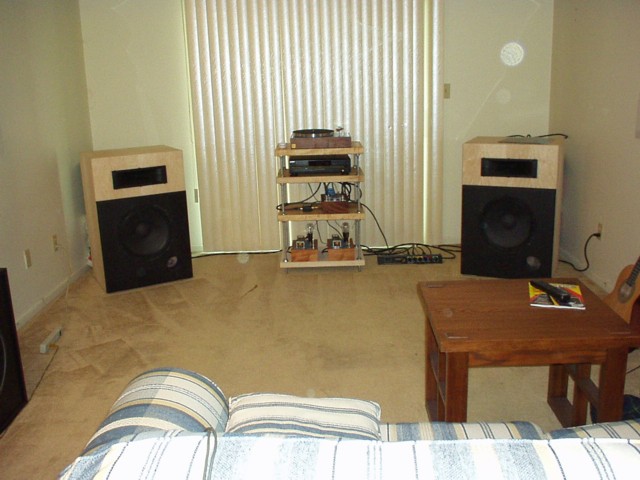

Over a decade ago (has it been that long!) I started with the old Theater 4 Pi which was a large, high efficiency speaker (15" and 1"compression tweeter) to mate with my 1.5 watt SET tube amp. A perfect match as they played deep and loud enough into my medium sized room.
I was hooked!
I've since played with the 1 Pi, 2 Pi and 3 Pi.

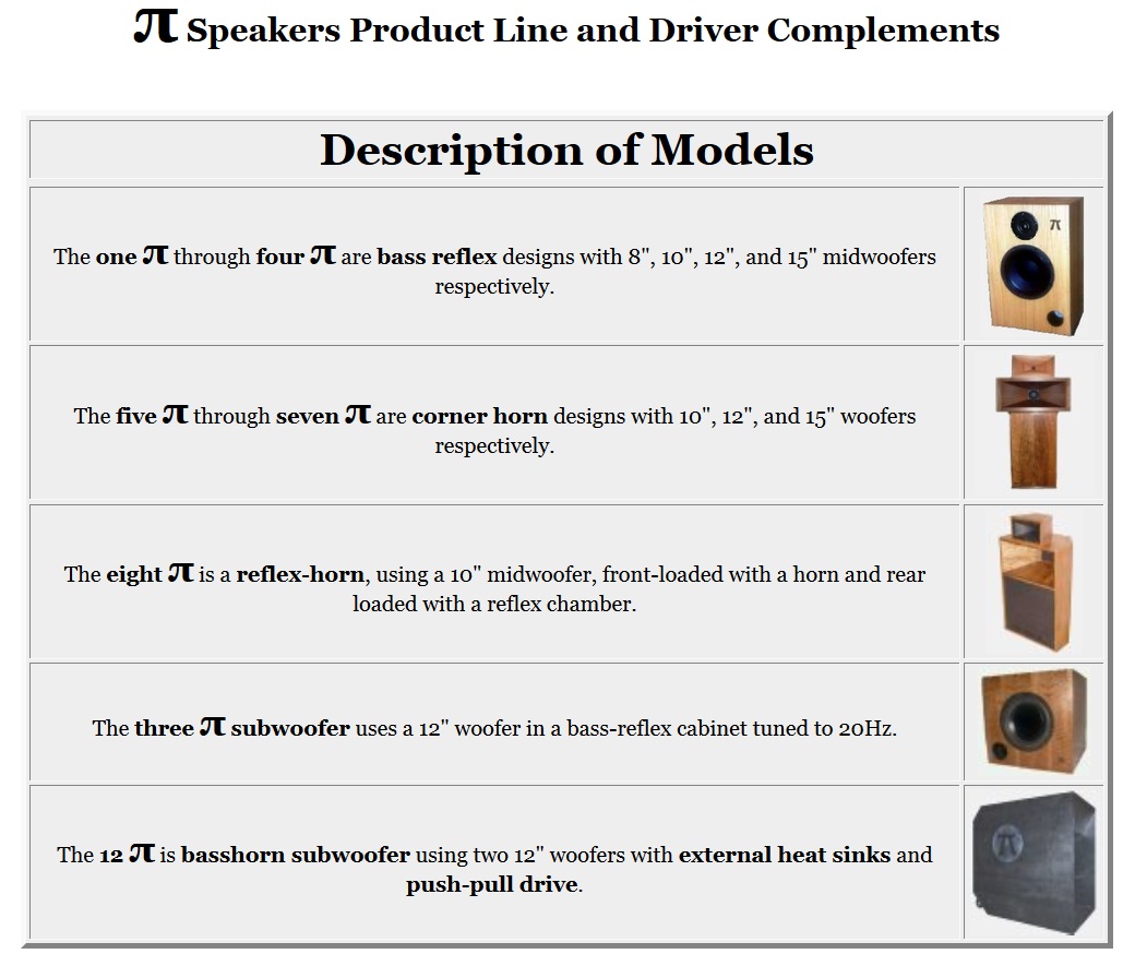

Wayne dropped the 'Studio', 'Theater', and 'Thermionic' designations years ago for a simplified 1, 2, 3, 4, 6, 7, 8 Pi speaker line. He also has the the 3 Pi subwoofer and the INSANE 12 Pi bass horn subwoofer.
Basically from 1 to 4 they get bigger and better as you up. The 1 and 2 Pi are 'just' dome and woof speakers with excellent on-axis response (see Wayne's response graphs) and the 3 and 4 Pi take it up that final notch with constant/controlled directivity (again, see graphs).
The 6 and 7 Pis are special and unique corner horns that you absolutely must consider if you have the corners (empty with ~5 ft of wall in both directions), type of room (wider than deep and not a thin rectangle) and WAF (they are big). The 8 Pi is kinda like a modernized Voice Of The Theater (VOTT) [I think] and the 12 Pi horn, well ... you'll have to see for yourself =madness.
I'll just come out and say it, the 2 Pi speaker (and especially the 2 Pi tower if you have the space, lower WAF and want some serious bass) are the best bang-for-buck in DIY audio. There, I said it!

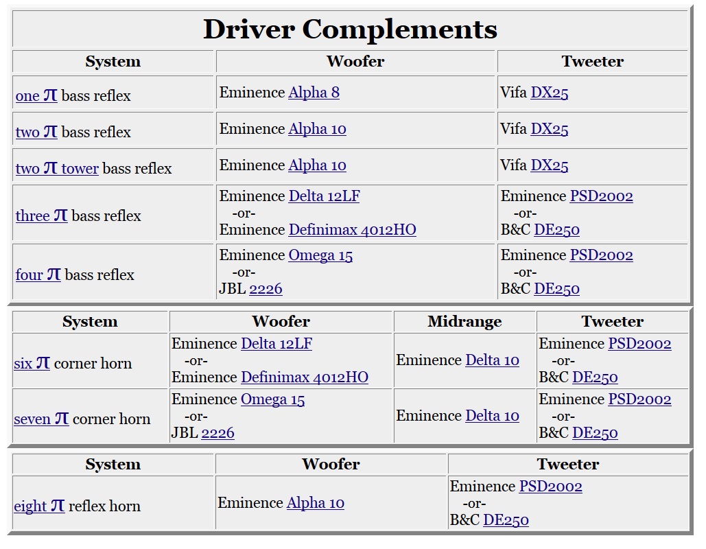

Here are his Description of Models and Driver Complements:
From:
Pi Speakers - Product Line and Driver Complements

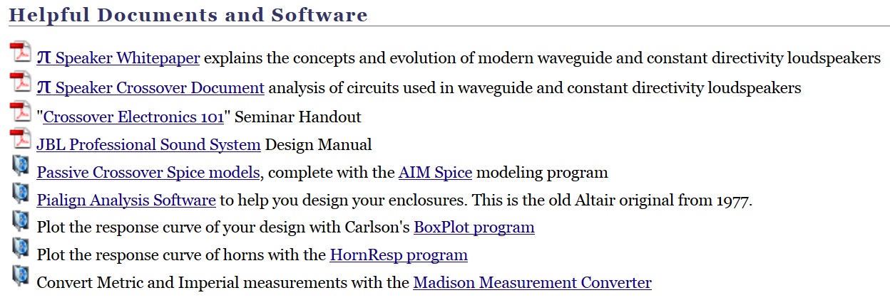

Links to some excellent info and software:
From the bottom of his Models and Drivers page:
http://www.pispeakers.com/Products.html
His own forum:
AudioRoundTable.com: Pi Speakers
And he recently did a lot of work to compile and organize his extraordinarily informative posts into an incredible FAQ
http://audioroundtable.com/forum/index.php?t=msg&th=17795&start=0&
