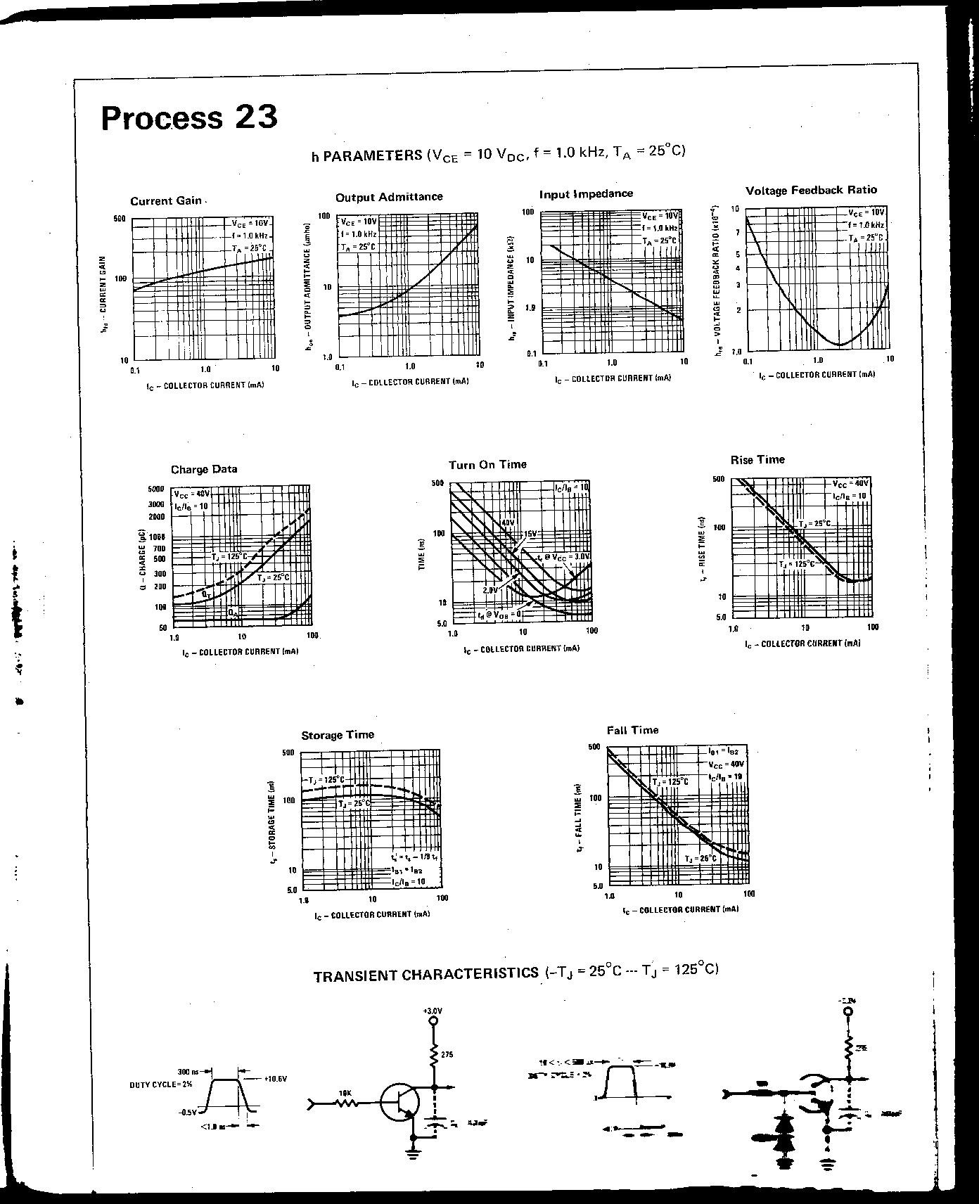

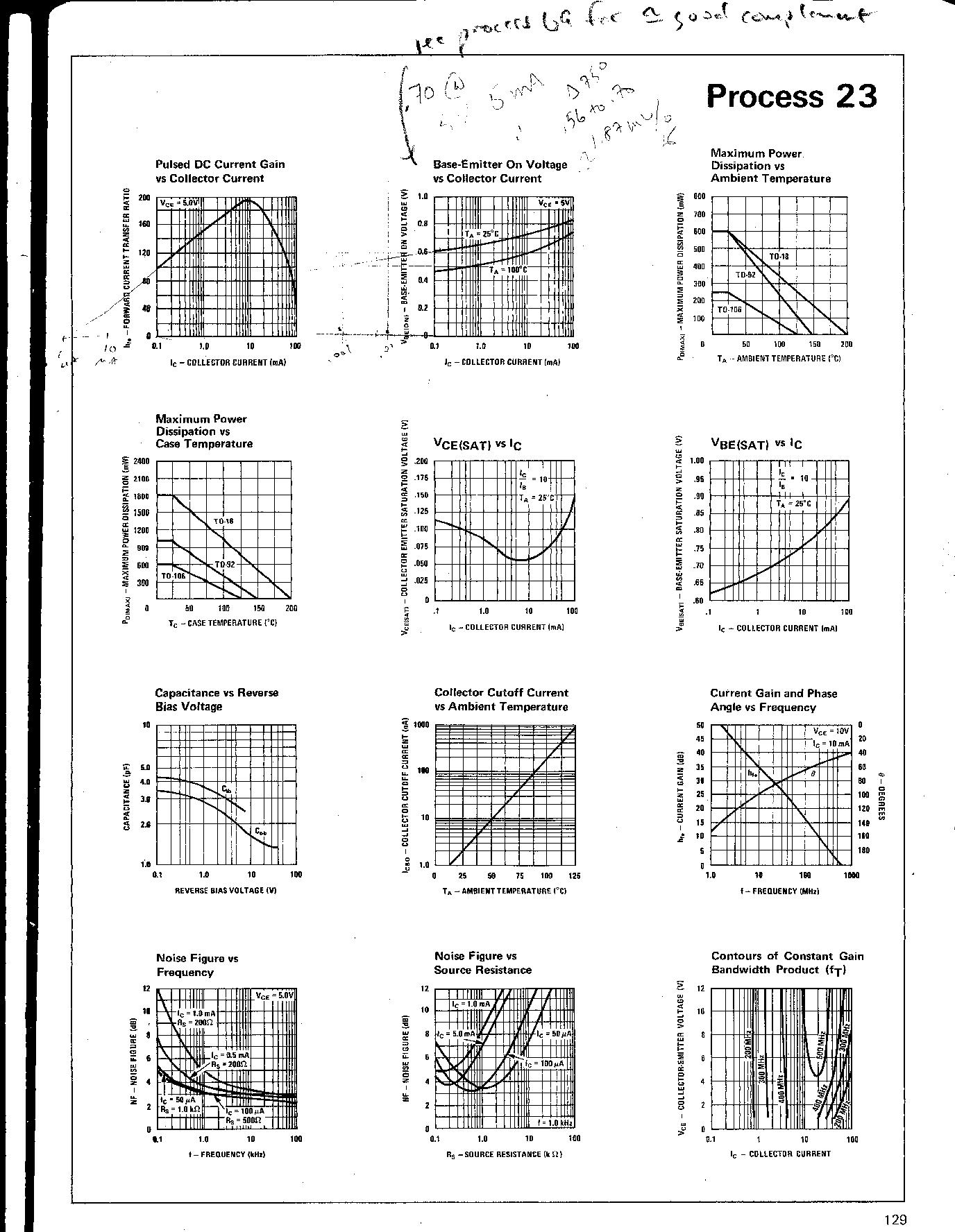

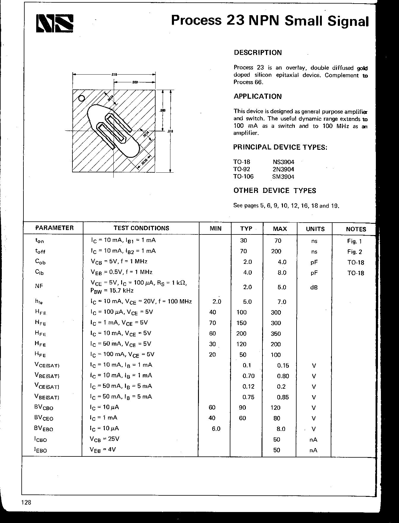

The pages I picked to show are for a process from which 2N3904 parts were selected, a garden-variety small-signal device that I used for years until discovering way-better things.
Note my pencil markings, at times trying to extrapolate the curves

View attachment 271324 This is a National Semi databook which actually had useful information. Unfortunately the parts were typically mediocre. They stopped giving anything like this much detail a while later, I suspect because of liability concerns (I took your curves and trusted them and then my arcilator blew up and I'm suing you!).

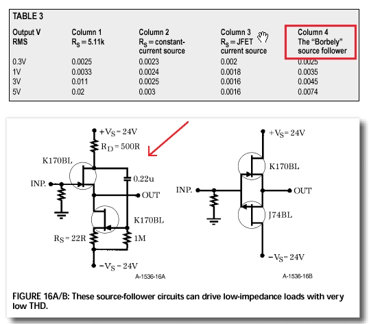

<snip>
And again, a very simple and obvious extension to FETs by the authors. But it was enough for USPTO![]()
I also wanted to raise the issue of EE "ethics'", if such thing exists. What drives those people who patent obvious topologies?
$$$ and only $$$?
Funnily, if that topology is US Patent #5,155,449
then what shall we say about this publication in AE 6/99?
Best,
Edit- John Curl gets credited for the other follower in the picture ;-)
