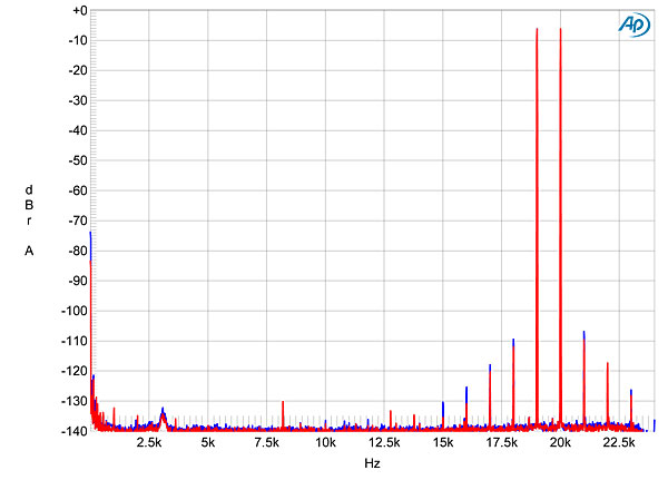

It does appear that Soulution Amplifiers have the measurement crown, Sound..?
The following sentence appeared in a review of the Soulution 710 published in October 2005 in the German magazine Stereo: "Lab chief technician Rolf Hähle has hung the test certificate for the Soulution 710 in a golden frame over his measuring desk." I wouldn't go quite that far, but the Soulution 710 is definitely one of the best-measuring amplifiers I have encountered. Color me impressed.—John Atkinson
Soulution 710 power amplifier Measurements | Stereophile.com
This amplifier channel's proprietary 12MHz-bandwidth zero-feedback voltage amplifier is sealed and potted to avoid prying eyes. 14 bipolar Sanken output transistors couple to a thick temperature-controlled copper bar. Schürmann explained how his circuit does not rely on common transistor matching to operate perfectly within tightly regulated performance specs.

The amp on the picture shows significant phase intermodulation: different heights of sideband strips.
Glad you mentioned that , then why the rave? very low distortion .....
Yes, low level of harmonics generated by intermodulation, but 5 microseconds of phase intermodulation is already audible as something artificial. Especially on stereo, when it means already uncertain stereo image localization. It sounds like paradox, but much easier measurable effects caused by Doppler effect in speakers is less audible! My understanding is, because human perception got used to mechanical alterations during long time of evolution, while electrical errors are something new in the recent life of each individual.

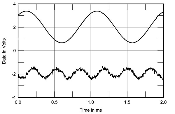

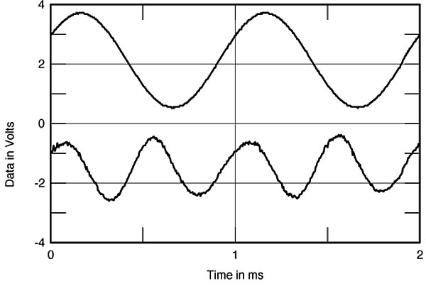

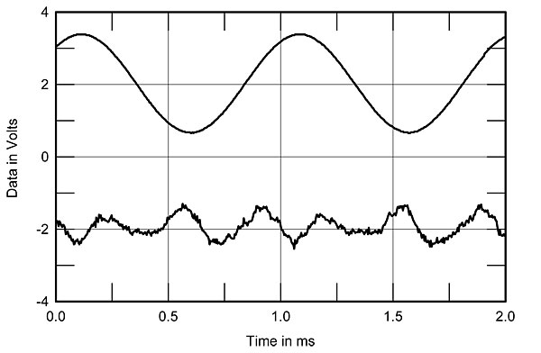

Wave,
What are we really looking for here as depicted in the below screen shots, what is good better , best !!!!
I would say the first picture is the best because it show the largest randomness, i.e. noise, versus a repetitive distortion residue. Secondly, the repetitive part seems to be mainly 3rd order distortion if I counted right, not that much of a problem. Interesting is that the repetitive part of the residue is neatly phase aligned with the fundamental. Could that be a clue to something?

With the third one being the worst ...? OK so better to have the random noise than for it to follow the signal as in pic 3 ...?
