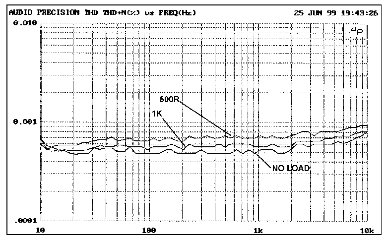

They are, please measure them...
I have no idea what you are talking about.
It is the Philips (and on-semi and others) datasheet that shows no distortion information whatsoever. While LM6181 datasheet on the TI site does not show the HD graphs, the datasheet for the dual part does though.
More critical perhaps is that the AD811 and LM6181 (et al) are characterised for distortion at 100 or 150 Ohm load. At 600 Ohm load or 2K load they perform much better and the performance of the 553X at 100 Ohm load is one they never bothered to publish (wisely so).
The OPA627, as well as AD811 and LM6181 are also quite aged parts (if not already discontinued) and not recent.
And why focus on GBW, why not (for example) distortion?
Oh I get it.
We cherry pick specifications that are either not given or not directly comparable or fail to show advantages and then make a big song and dance about it claiming "look, what he said is wrong".
You may find it more useful to actually measure said devices...

They both have higher THD in the audio band than the old dude....
At such low loads , surely that such high current op amps
probaly do better......

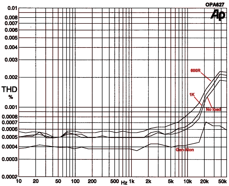

You are quite paradoxal since GBW product will inherently be a
parameters of first importance for perfs once we apply NFB,
do we , to those circuits , in the aim to reduce....THD !!..
At 1 khz , the NE5532 OL gain is still 100 dB while the OPA627
has collapsed to 85 dB and the OPA134 at 80db.
Now , at 20KHz , the numbers are 65 dB , 59 dB and 53 dB respectively.
Curiously , when restricted to audio frequencies , the NE5532 has higher
GBW product than those two well regarded op amps , it s only below 100 HZ
that theses "audiophile" products have higher gain and thus higher GBW product ,
exactly where it is not needed at all since at those frequencies
there was already enough gain and thus NFB available...
Basically , those two more recent op amps have higher DC gain
but lower AC gain and their linearity (read low THD) is due to better
manufacturing processes than the one available at the time of
the NE553X wich has notoriously slow lateral PNP transistors,
yet , it s still unsurpassed to these days for audio purposes, and when it is , it s only marginally..
"only marginally". Of course. As one gets closer and closer to perfection, in any endeavor, the margins get smaller and smaller for the effort/cost involved. That's the old 90/10 rule. The first 90% takes the first 90% of time/cost whatever, the last 10% takes the other 90%.

Please show your measurements... I find they have substantially less under identical conditions with 1K loads...
If a circuit has less THD than another (which the OPA627 has compared to the NE553X) then the implication is that it is more linear. If it is that while having less OLG than the other circuit, it simply means it is more linear.
It is not just marginally surpassed, but quite dramatically, once we get real circuits. But please continue to use if you like.
I use 553X in some specific applications (though not the direct signal path) where the relative decent specs and very low price make it an excellent choice. Heck, i have use for the TL081 at that in audio gear (but not to amplify audio)...
