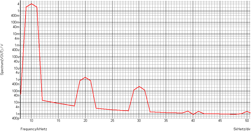

But that would be cheating as we are now discrete and no longer use Op-Amp's and we probably will have minor issues giving 0.0001% THD in an optimal setup on the testbench.
Such a THD figure is trivial with a discrete design provided extreme
care is given to layout and realisation.
See the graph below..

Indeed , the 0.01% to 0.00001% of THD due to amps or other
op amps seems for some people to have much more audibility than the
sometimes double digits of THD produced by the sum of two extremities of a chain
comprising a turntable on one side and the speakers on the other one....

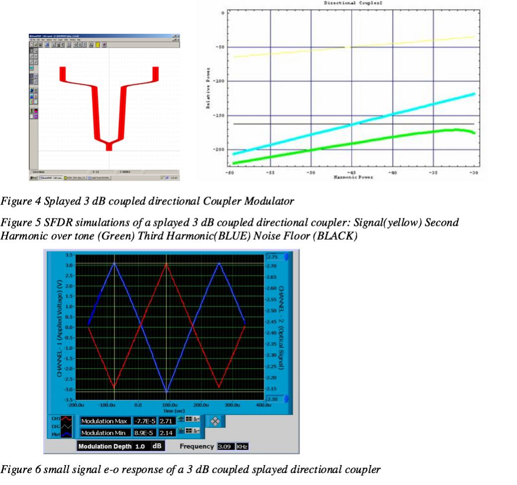

in Dimitri's circuit the input op amp supplies are bootstrapped to give a composite op amp follower with ultra low distortion - tested with 1 MegOhm input series R, 5 Vrms, > 20 dB attenutation of 5th, 7th harmonics "input nonlinearity distortion"
Sfdr
Indeed, , the 0.01% to 0.00001% of THD does not matter. But 0.01% of 2'nd only error vs 0.01% of the wide spectrum feels like one 100 KG speed bump VS 100 KG of nails on the same road for car tires.
Interesting point .01 % is a spur free dynamic range of only 40 dB; that is well above the noise floor and missing higher order harmonics. Can you actually hear a 40dB 2nd harmonic? I know I found ~.6 % clearly audible from 500 hz to 4khz.
FYI I have a designed and fabricated ~130dB SFDR splayed directional couplers for 40Gb optical transmission The triangle waves are quite precise (hopefully see attached) Bet the curvature in the triangle wave response would be clearly visible
