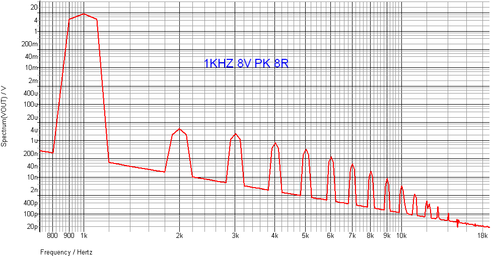

Your version is easier for me to get my head around, that's for sure. As yo have done this sim, I will try to copy that to learn the tool and the main reason, to learn how these puppies work. As I have mentioned, reading textbooks is a great step one. Nothing beats being able to ask a question. I really appreciate your efforts and the patience of the many on this forum.
What would the sim say if you slowed down the outputs and changed R18 (23 on the mod) to 680 and R21 (R12 on themod) to 470? I am switching to the Exicon EC-10N16, P16 pair. They have half the gate cap. from the Hitachi. So the above gives about 1M for f3. Would I not risk some output stability with the 100 & 68? I am going to fly the gate resistors right off the socket.
150 on the CM emitters. OK, I was guessing 100. Actually, I happen to have some. How about a .1u across Q8?, or Q12 in the mod.
THose 2SC1775's sure do have a LOT more gain.
I gather the output network is a "typical" ?
You have moved the compensation to the output of the first and second stages into the feedback loop. No more big DC load on the VAS Do I look at them, C8/R13 and C5/R13 as if they were separate?
Simetrix. Found it. Simple is good as I don't intend to do this for a living. I am already on my third career. This is far more fun as a hobby.
The original P FET gate 470R resistor is too high and this produce
an overshoot on the positive going of the signal when checking
with a square signal.
The input differential current is 0.6mA/transistor , hence the 150R
to create a significant voltage drop of 90mV that will allow the CM
to work correctly despite components dispersion.
Shunting the VBE multiplier with a cap can be useful , i didnt check,
in case wich a 100nF cap should be enough.
Depending on the device used a 100/220pF can sometime be connected
between base and collector of the said transistor to prevent local instability.
The compensation i used is TMC , transitionnal miller compensation,
wich has been vastly popularized in this forum by Edmond Stuart.
The relevant threads can be easily found and will provide quite
an insight about this original way of compensating an amp.
As for the output network , well you re right , it s typical ,
albeit the original should be enough..
As mentionned by Thorsten you can use dual die cases
that will allow for better current capability without drilling
the heatspreader , not counting the shorter electric path
wich is instrumental with power fets.
Just be carefull to first set the iddle current to 0 after such a mod,
although the Exicon fets have higher thresholds , one never knows.......
Does Simetrix allow for Fourier analysis?
Of course , here two exemples.
