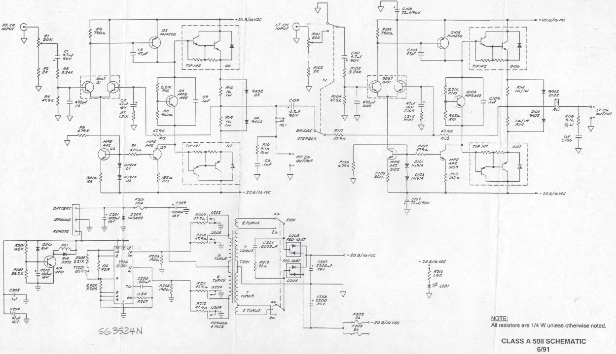

wadest if you can post a schematic of one of the MC power supplies and an example of the D series that would be great. Mine still works but if it ever blows that would come in handy.
soundstream early schematics
sheep, i'm sorry but i can't find a power supply schematic for either. if i run acros them i will post them. all i have now aere the amp schematics for the Class A 40 and the MC300. i wil send them.
sheep,Wade great can you post the power supply schematic for the CA50?
How did the D50,D100,D200 differ?
Do you have the schematics for them as well?

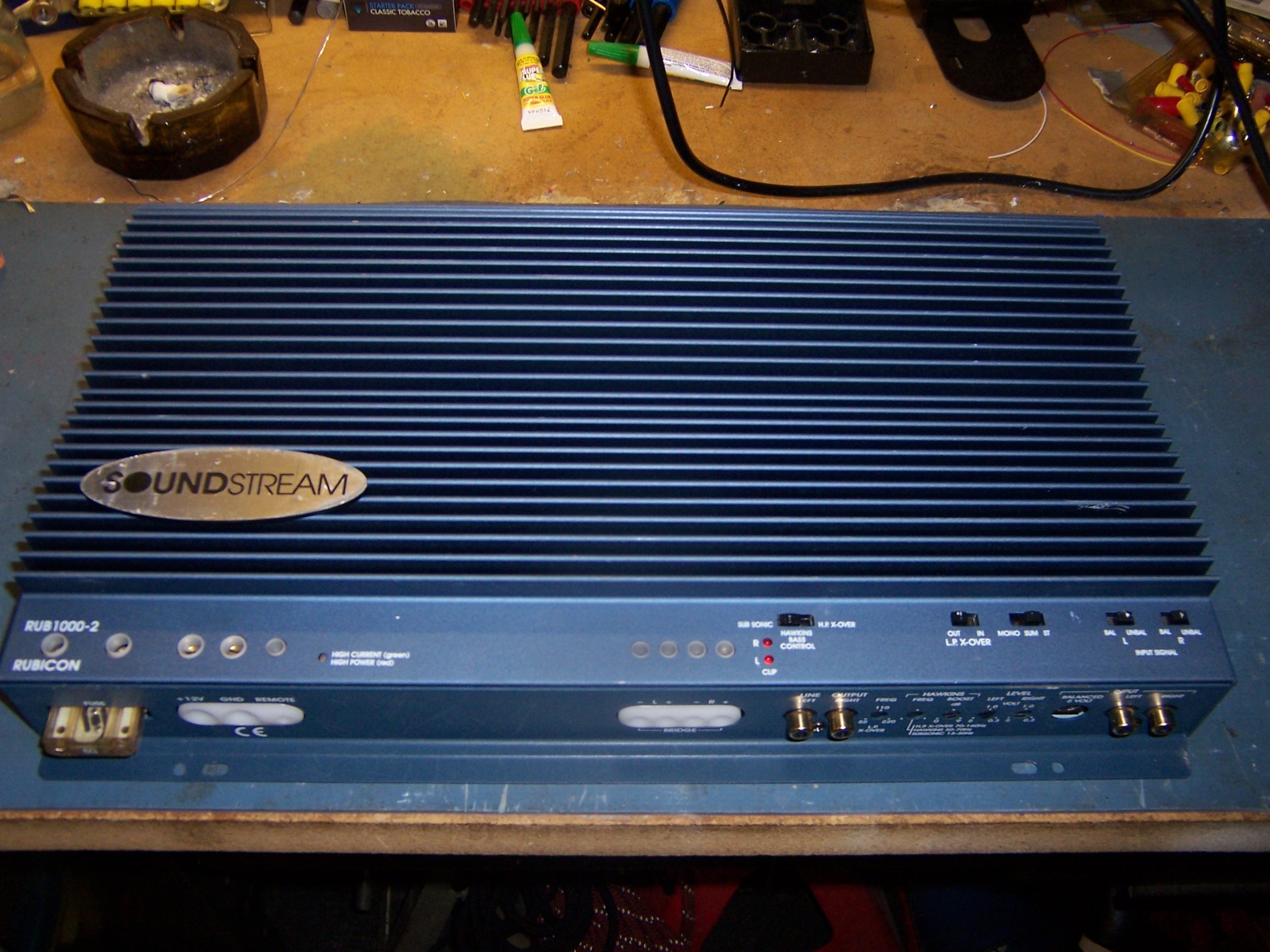

RUB1000-2
I'd like to thank everyone for their thoughts and thorough knowledge on switching power-supplies and amplifiers 🙂
I received the NOS made in Japan Toshiba final drivers from JR and FEB's.
I replaced all the capacitors along the audio path and on the FEB's with ELNA audio grade.
Replaced the 12v side of the power-supply with low ESR Panasonic caps.
Replaced the filtering side of the powersupply with Panasonic caps.
Replaced all the double diode's
Replaced all the MOSFET's with NDP7060's along with the 3.3 ohm gate resistors.
Replaced the 1k resistors coming from the PWM and the PWM.
Replaced the Zeners for the +/-17v and everything in its path.
Replaced all the op-amps.
Results....
Rail +49/-49
Op-amp power +16.7/-17
DC off-set Rt 3.5mv Lt 2mv
Idle current 1.5 amps.
Everything stays cold playing it on my studio monitors. (25amp power-supply)
Sounds better with the 2SC3281and 2SA1302 installed compared to the C5200's and A1943's. Could have been the new FEB's though!

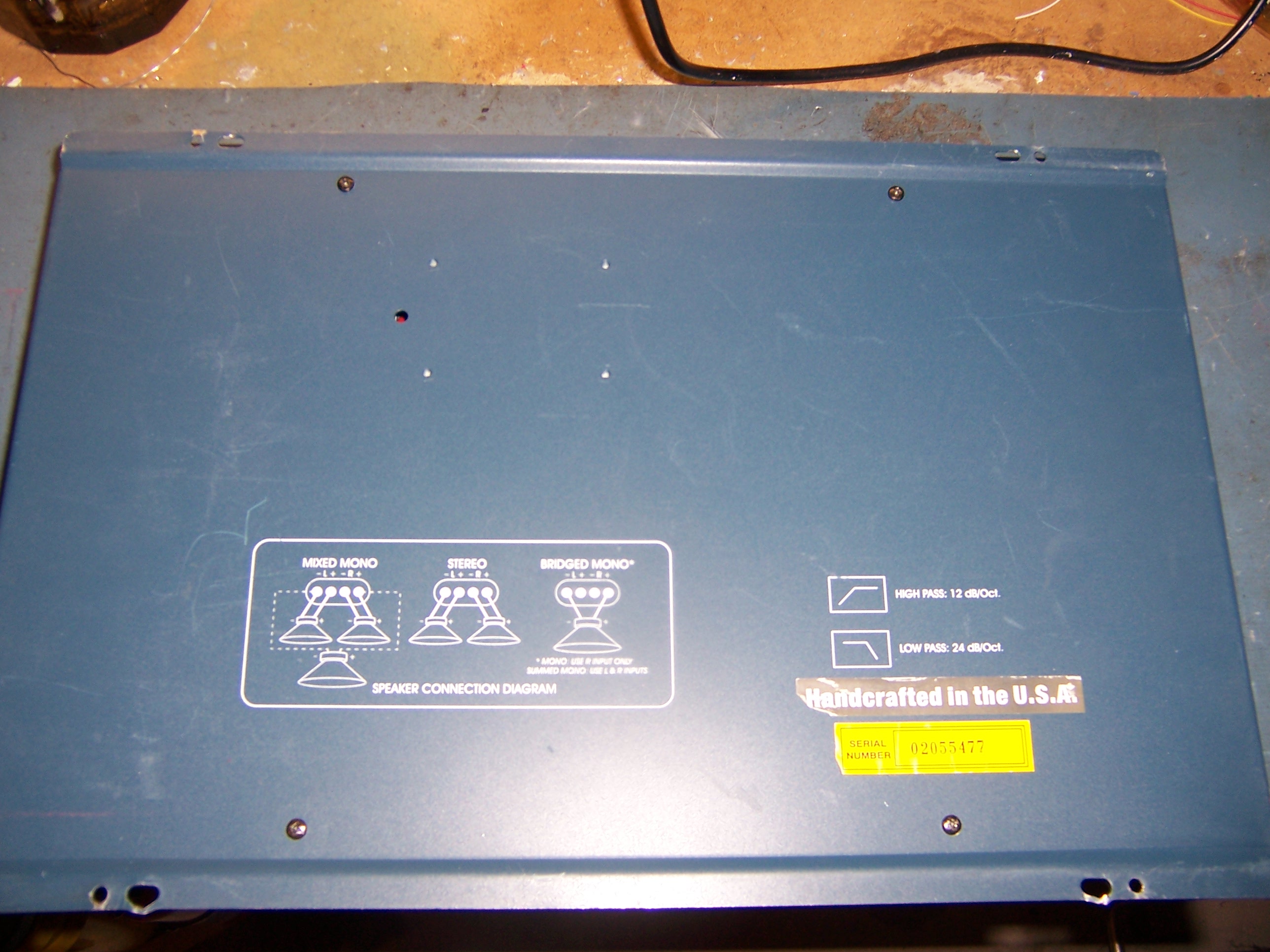

On the board it has DBERRY next to the board numbers (Any one know who this is?) and it does say Handcrafted in the US on the bottom cover.
Well, I'm glad I stuck with it and pretty much turned it back to a Rubicon 1002. Thanks all!

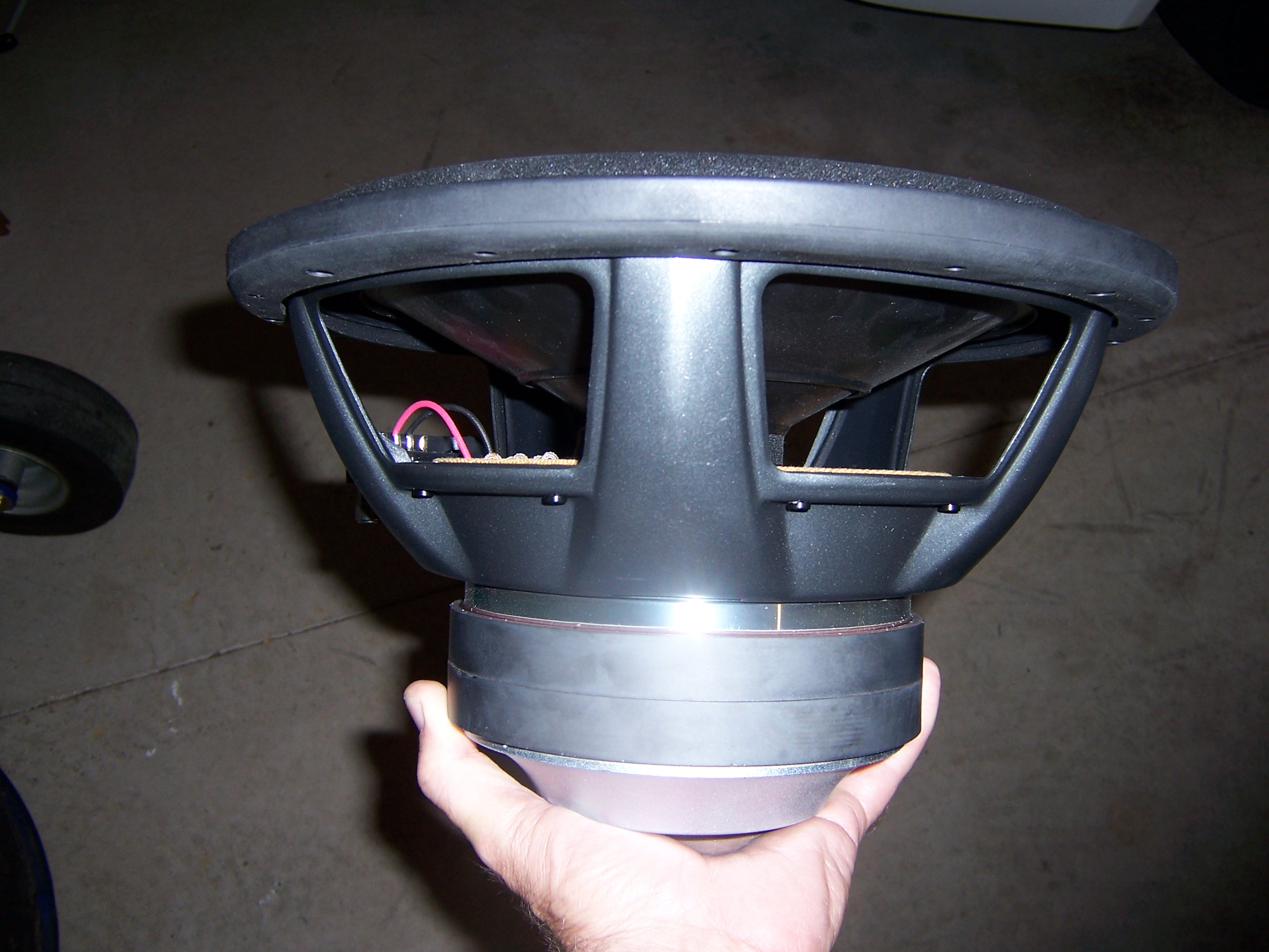

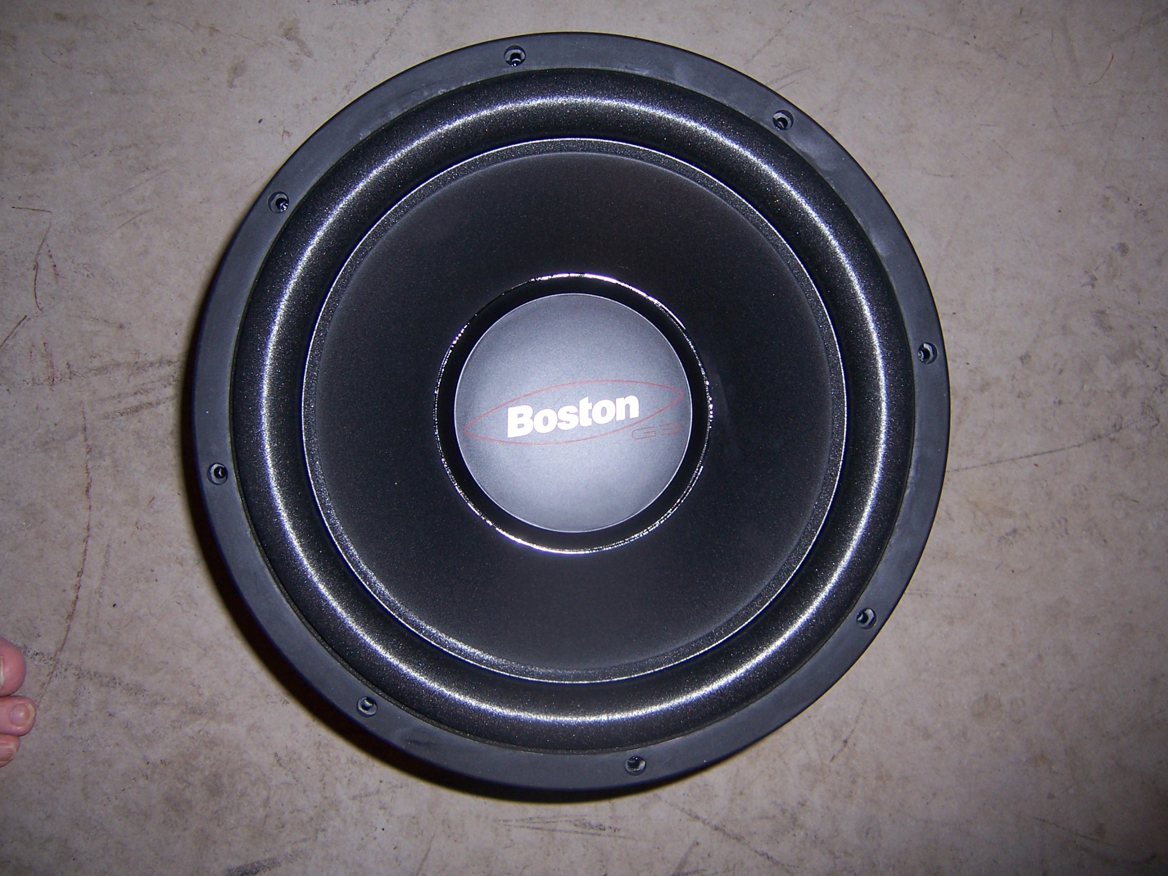

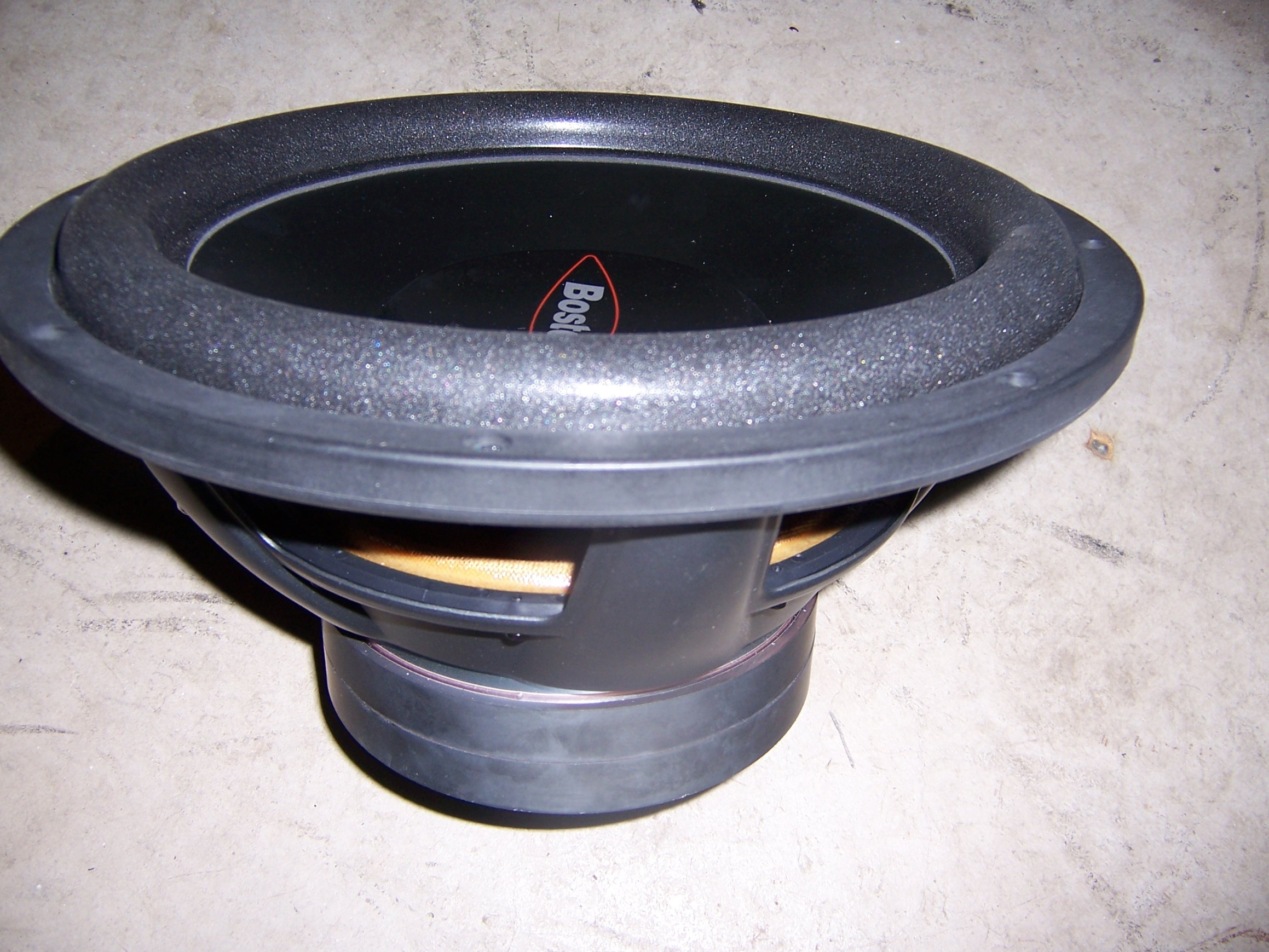

Reference 700s pushing a Boston Acoustics G312-4

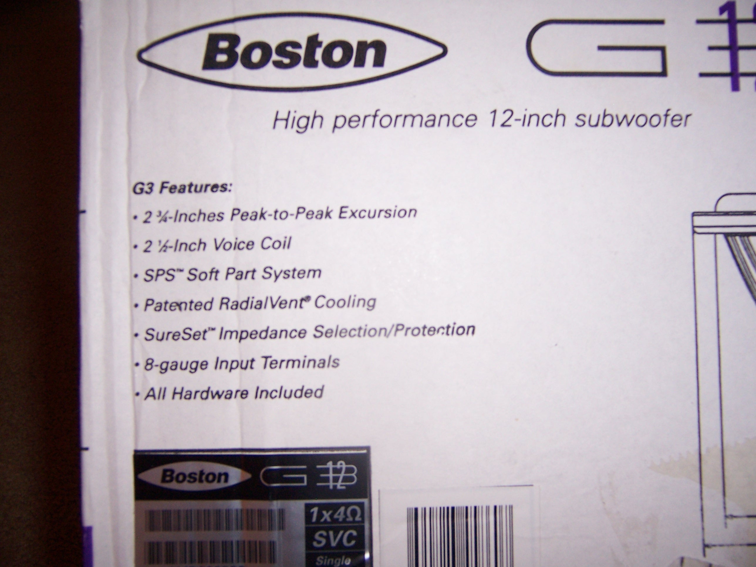

I was looking for a woofer that didn’t need so much power to run it like the Pioneer TS-W2501D4 10 inch I have, (rated at 800 W RMS - 2500 max). It could sure take a beating! Plus it was dual 4 ohm coils to add the extra heat.
I ran across this brand new Boston 12 inch woofer on E-Bay and won it!
The power to drive it says 375 W RMS with an X-max of 2 ¾ inches!
Only needs a 1 cubic ft sealed box…
Hopefully the Reference 700s will stay a little cooler pushing this thing.
Oh, $30.99!!! I know the guy wasn’t happy seeing go for so little. 😀
