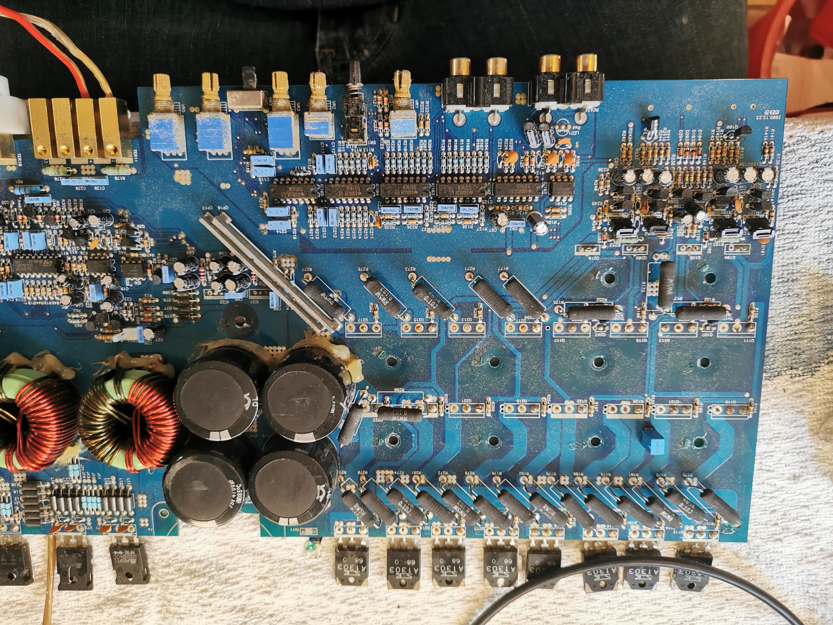

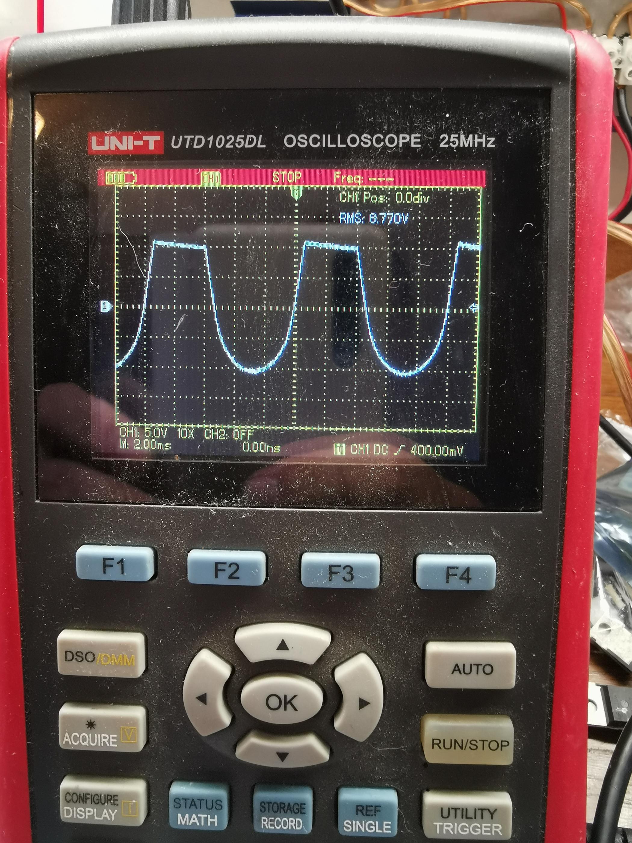

This one seems to work fine. If i connect a 4Ohm resistive load to any output,
and give a sine wave in the amp, the signal looks fine, but at the same time, the amp starts drawing current. Its the same on both channels.
Without Signal, the amp draws only 0,9 Amp.
With Signal, bench supply limit at 6amps.
Never had this issue..

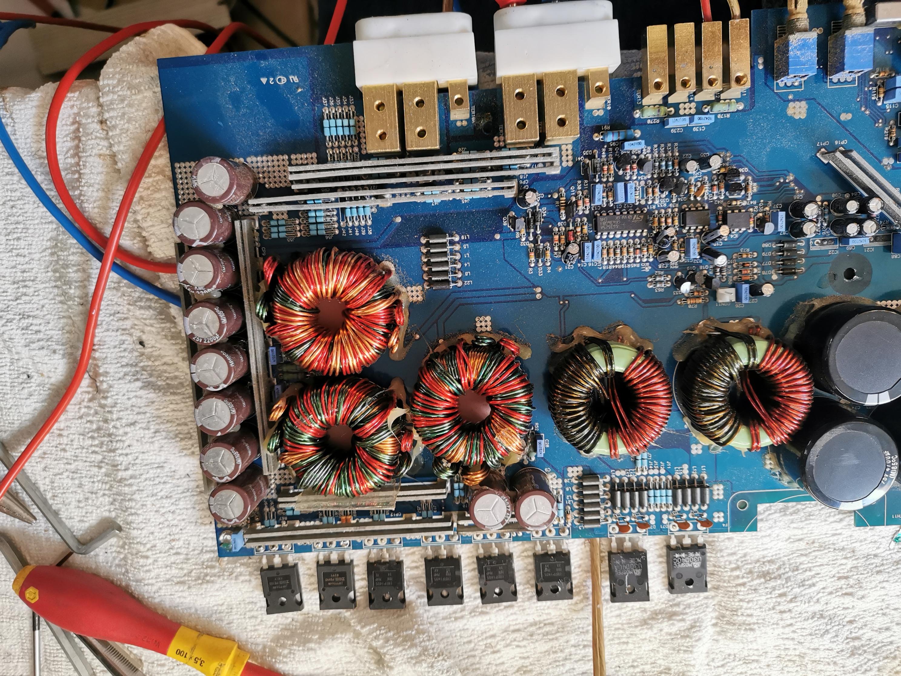

I think i found the problem. Its regulated ps with three banks and transformers. One bank is disorted.
As soon, the amp detect some load, the last bank will be added, but this one cause a short.
