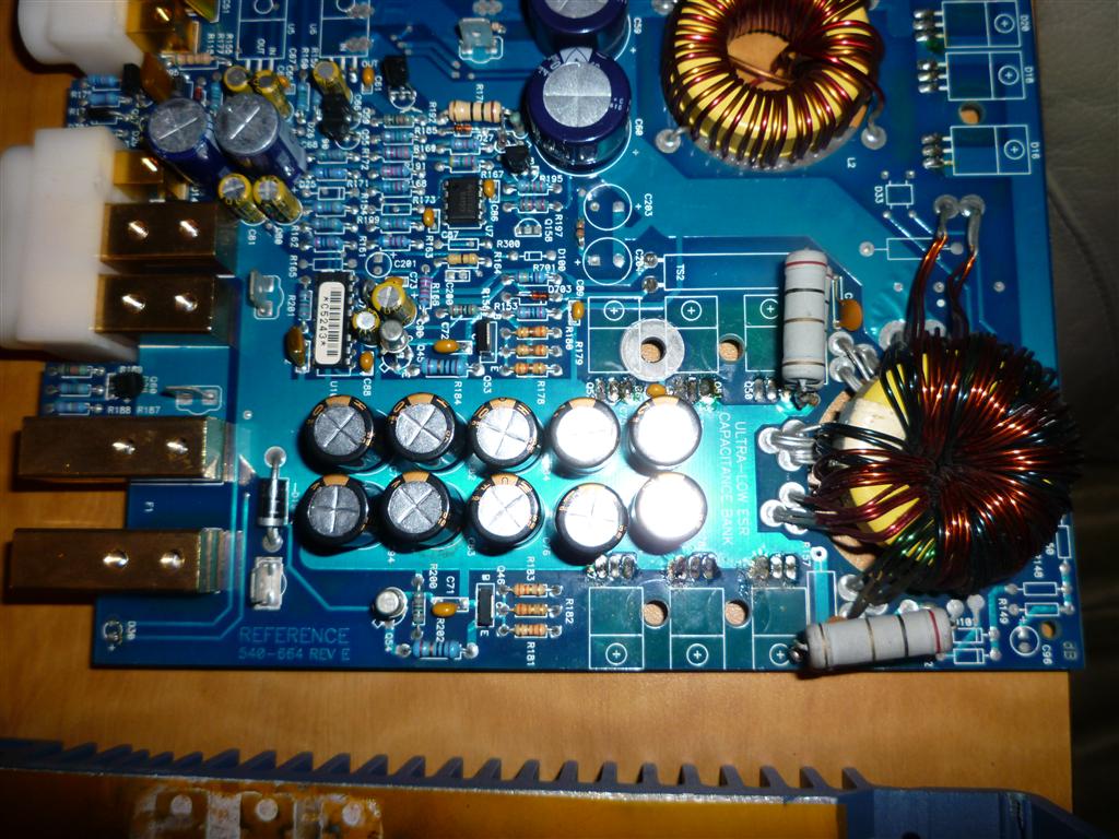

Im rebuilding this amp pretty much all of it since more then half the parts are missing off the board.
My question is There are 1 ohm resistors in the power supply section there are 2 of them.
In the reference 700sx they are using sandstone resistors but in the 700s whats there now is just regular resistors 5 watt but they are to long and big to make it look like a professional job. Wondering do i use smaller resistors like 2 watt or do i get the sandstone resistors (the lenght i need)
From the factory, lots of these snubber resistors looked less than professional. If it has a 5w, it may need a 5w. They run very hot and a lower wattage resistor may fail.

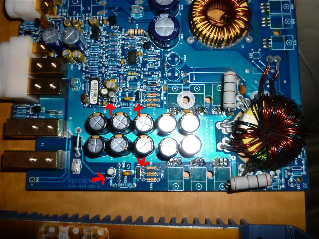

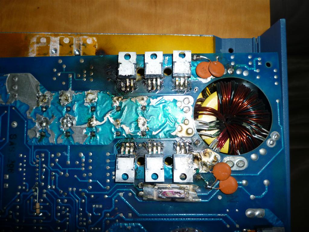

I have a 700s that was in a car I bought but non functioning. I took the back off and found leaking esr caps and blown power supply fet's. So I replaced them and upon testing it blew the Q47,48,50 fets again on the lead tied to the + side of the esr bank. Obviously there is a short somewhere. I did manage to get a schematic from SS but is it worth fixing and where is the likely trouble area. Any help is appreciated
Check the drivers for shorts/leakage.. Arrows pointing to them in the pics..
Also check the following..
All TIP102's and TIP107's fo shorts /leakage.. You should get nothng near 0
Check all gate resistors for the power supply fets as well..
I would start there if you havent already and if everything checks fine then we can go from there..

So it seems the drivers are bad. Trying to reposition Q53 for a better look at the p/n the metal back peeled off, obviously a goner
Gate resistors are gone, value should be 3.3 i'm reading 1.6-1.8 on r181-r183 and 16,open, 202 on r178-r179. Took a magnifying glass to notice the burn marks on them (getting old sucks lol) They might have been there the whole time.
A few of the power supply fets were smoked when testing it so they will all need to be redone.

I just checked the dual positive and dual negative rectifiers at D16/D18 And D13/D20 respectively. I am getting 0v both directions on the positive rectifiers D16/D18 and .42v/1.5V on the negative rectifiers D13/D18
TIP102 and TIP107 are the outputs they are on the bottom side of the amp..
Take the bad power supply fets out of circuit then re-check the drivers for the power supply fets..
Heres a pic of the drivers (red arrows pointing to them) but make sure you remove the bad fets before you test

It appears that one of the positive rectifiers has failed. Replace both of them.

With the power supply fets removed the drivers still don't test correct so they are done.

You may want to replace all of the rectifiers. SoundStream amps are known for being tough on rectifiers.
When you get all of the parts installed, clamp ALL transistors tightly to the sink and insert a 10-15 amp fuse in the B+ line. This will help protect the transistors if there is another problem.
