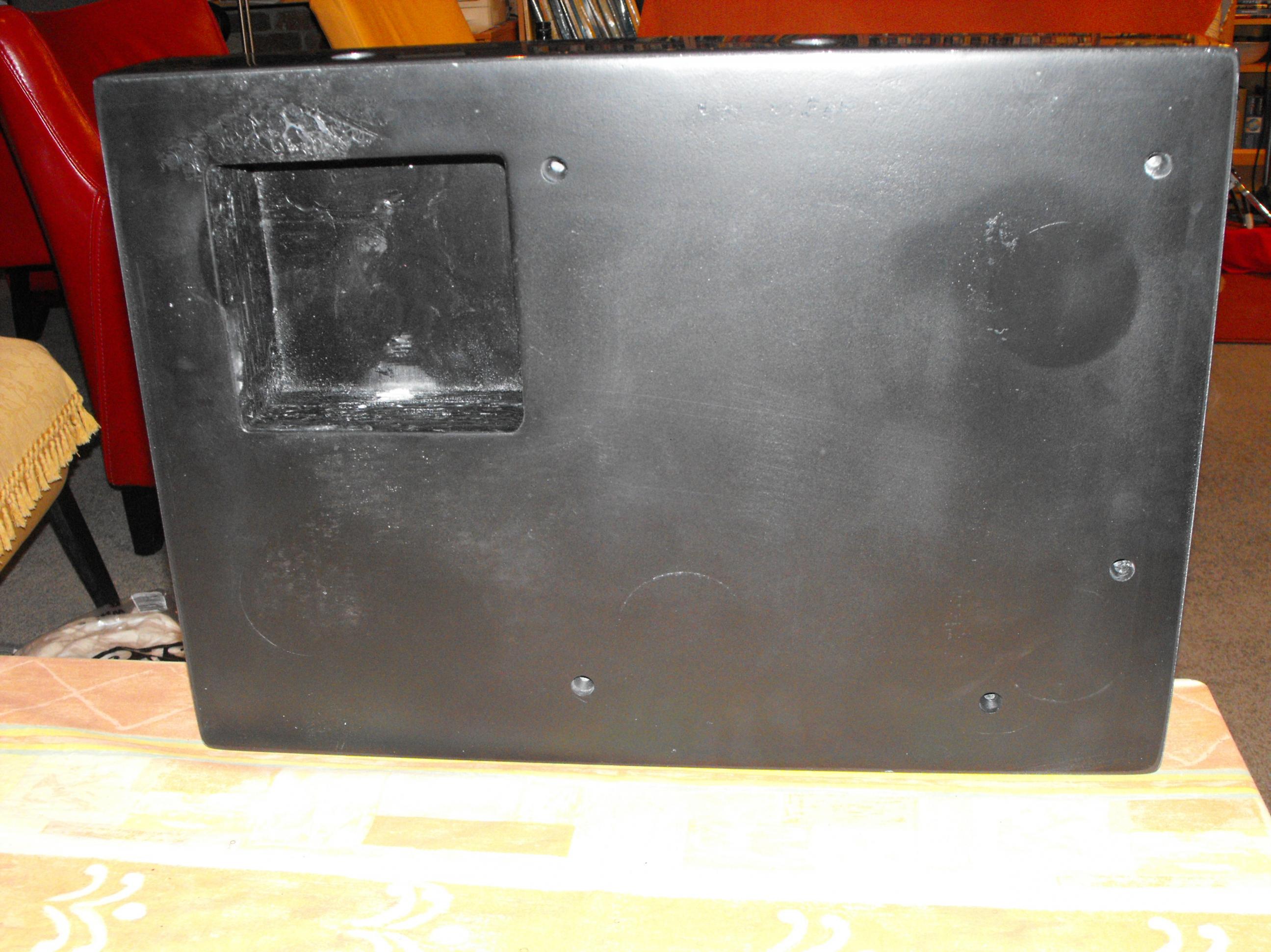

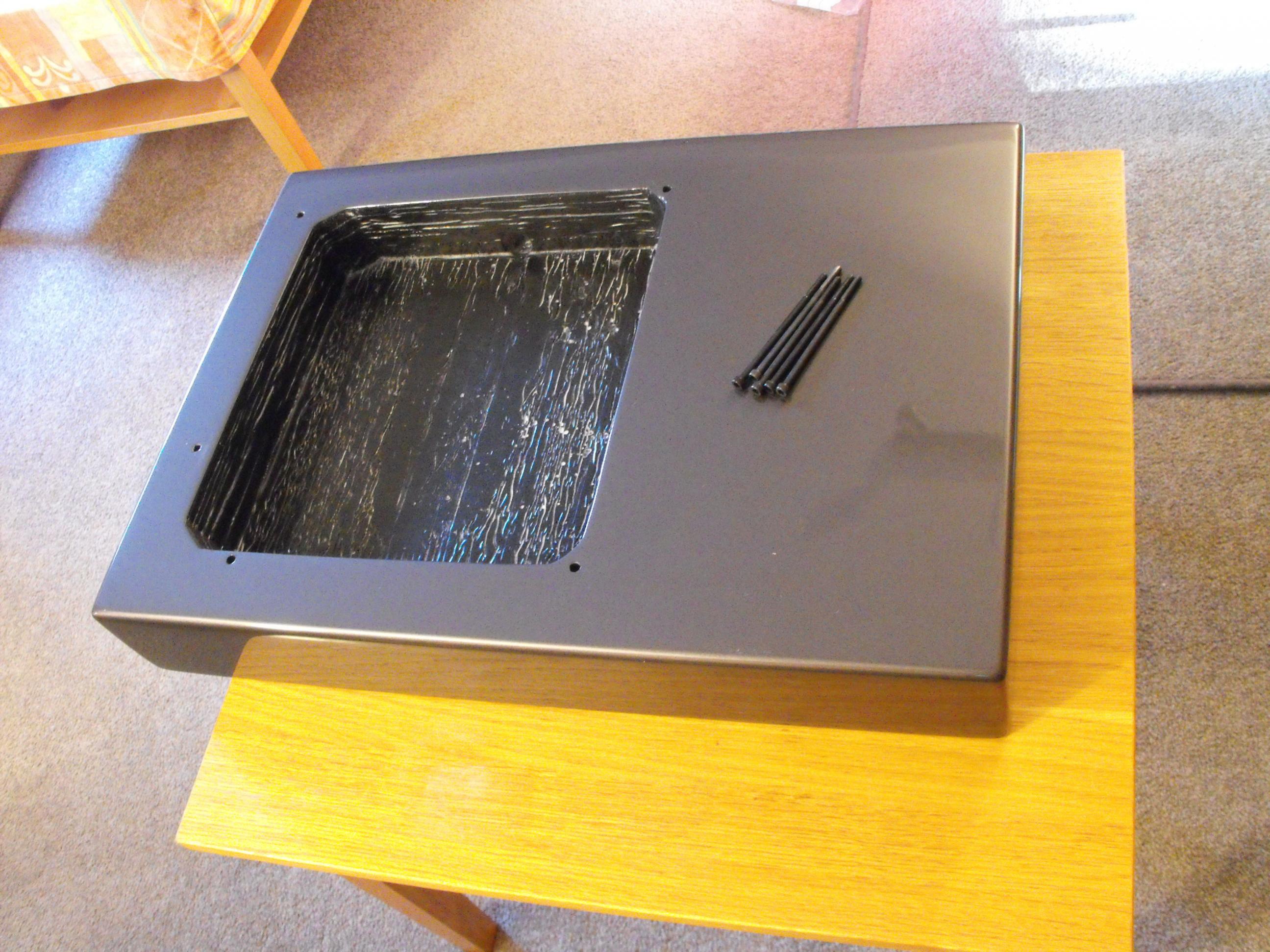

Isophthalic polyester resin and bentonite Plinth
Andy,
Look back a few pages (91), my posts start here:
http://www.diyaudio.com/forums/analogue-source/190735-sp-10-mkii-next-project-10.html#post3188192
I used Isophthalic polyester resin and bentonite (cat litter).
Rush

And now I'm doing a substantial re-design with a few improvements because of unscrupulous copycats.
John
Albert Porter's version of a SP10 mkII/III plinth have been something of an inspiration for me. Although I do not intend to end up with a shape that mimics those of yours and Albert's vision.
From the photos I've seen, the Porterhouse plinths are superb and unique. You have my respect.
Although I plan on using a "bearing sink" as has been shown in the Porterhouse plinths. And I will use gray iron as the material of choice for its high graphite content and dampening ability. But the rest of it I hope to be unique to my own vision.
Another thing to consider:
The SP10 designs are the property of Matsushita. Their design. Their vision. From long ago. For my money, that is where the credit really goes. So trying to make a buck by producing "accessory products" for this old design seems in and of itself a bit like the Ramora clinging to the shark.
Me. As a diy project this can be something to gain experience and a certain amount of pleasure/reward from. Reworking a 35 yr old turntable. It is fun. But I won't get protective about my work until I come up with my own turntable design. And I"m not there as yet. So that is why I'm willing to share my drawings and designs and projects over the web. Because, ultimately, the credit still goes to the owner of the original turntable design.
my2c
-Steve

Finalizing my plan for a first attempt and wondering about securing the SP-10 MK2 to the plinth.
I haven't been about to find any M5 bolts in lengths longer than 70mm and the plinth will be higher than that, so what are options?
Bolt to the top one or two layers only? This requires different patterns for each layer.
Drill all the way through with a very deep recessed hole to access the head of the 70mm bolt? Difficult to access perhaps.
Threaded rod with a couple of nuts on the end? This option permits a much longer length cut to fit but not sure about structural strength of the rod at this length.
I realize the answer will likely end up being a simple one but damn if I can come up with it.

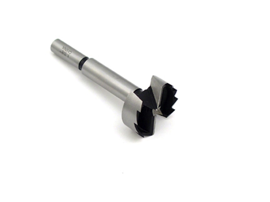

Use a forstner bit to adjust the pad the bolt head rests on. Put a stop on the drill press so they are all the same length.

I use 90 mm countersunk in the base. I like to clamp the SP10 through the full thickness of the resin plinth. This allows the bearing to be pulled down in contact with a bearing drain, which is 6 mm of sheet lead in my plinth.I meant 90mm long enough?
I got mine from McMaster Carr also.
Rush
If you don't know what a Forstner bit is:
"This 1 5/16" Forstner bit features a 3/8" shank and is machined from high quality carbon steel. May be used in a drill press and with extra care in a hand drill. These bits cut holes with clean sides and flat bottoms and will not burn if you stay within the recommended speed as stated on the box. The bit has a saw tooth rim to reduce heat and to minimize larger bits' tendency to burn. Overall bit length 3 1/2"."
1 5/16" - Forstner Bit-Traditional Woodworker
Rush
