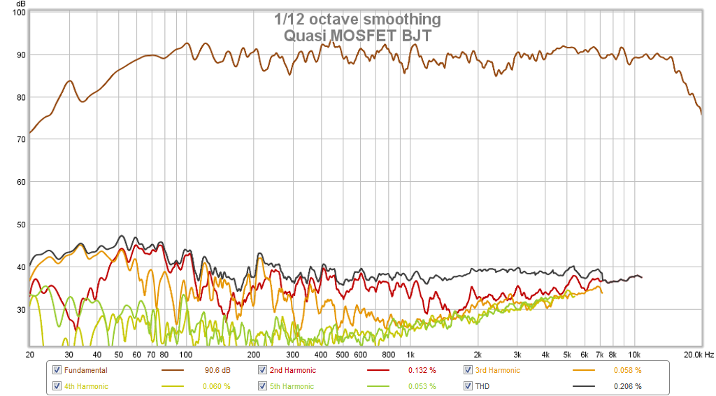

Usual frequency response with associated harmonic distortion levels for various harmonic orders vs frequency.
For example, this is what I usually measure for a speaker - in this case the VSQ amp with my 10F/RS225 FAST. <snip>
This is very good!
