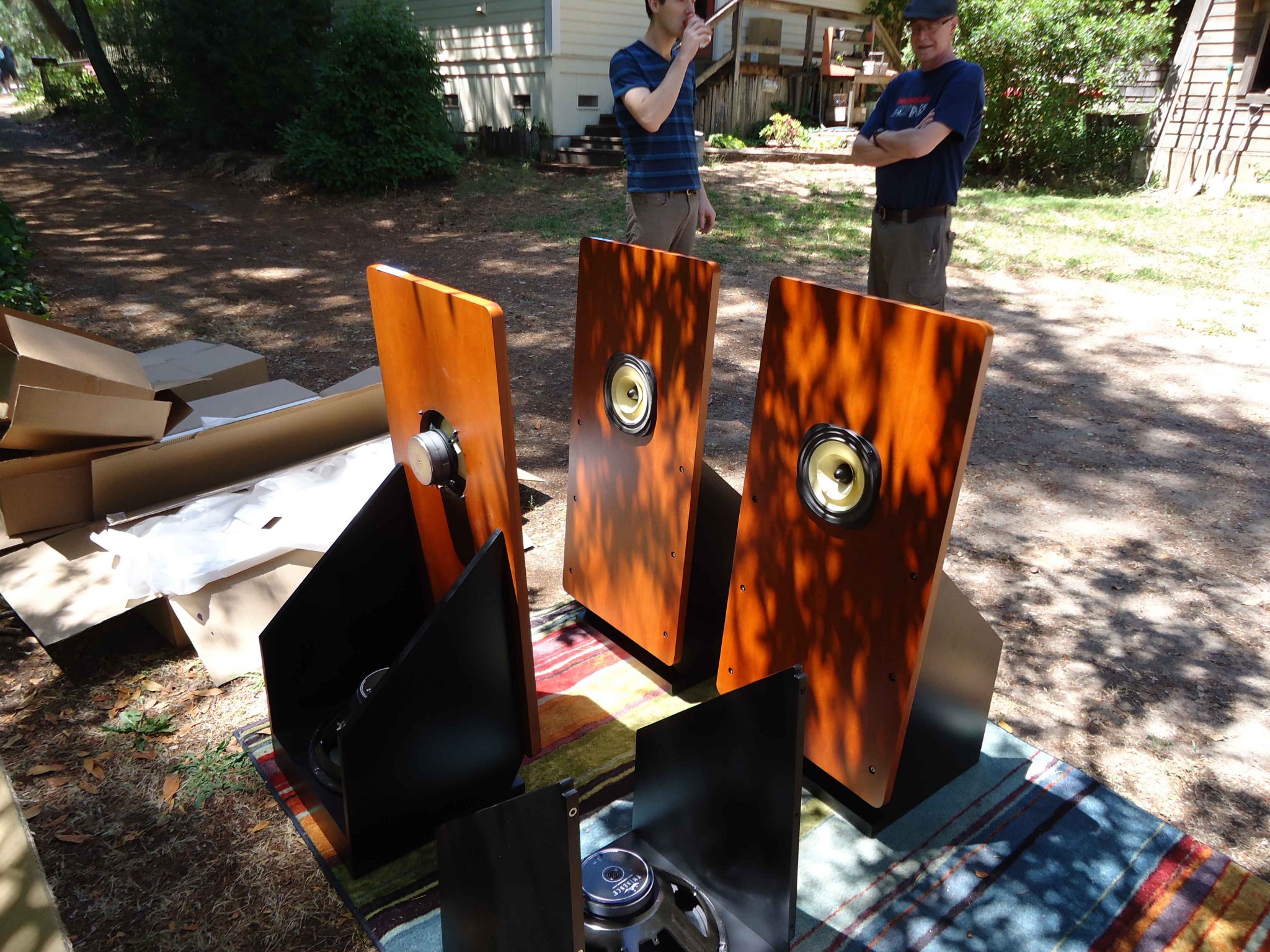

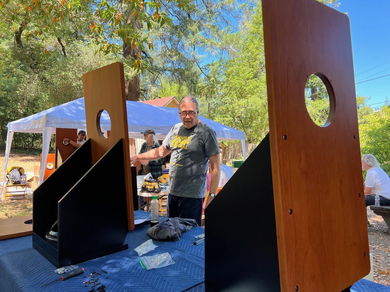

Yes! It was a wonderful day at the beautiful Brock home and gardens. Thank you to Liz, Dana and Nelson Brock for hosting us all (lots of effort to do so), and feeding us a delicious, healthy lunch. Thank you Nelson Pass for making this project possible, and making all of the crossovers!
The speaker baffles, boxes and Moth driver are an even more attractive package in person!

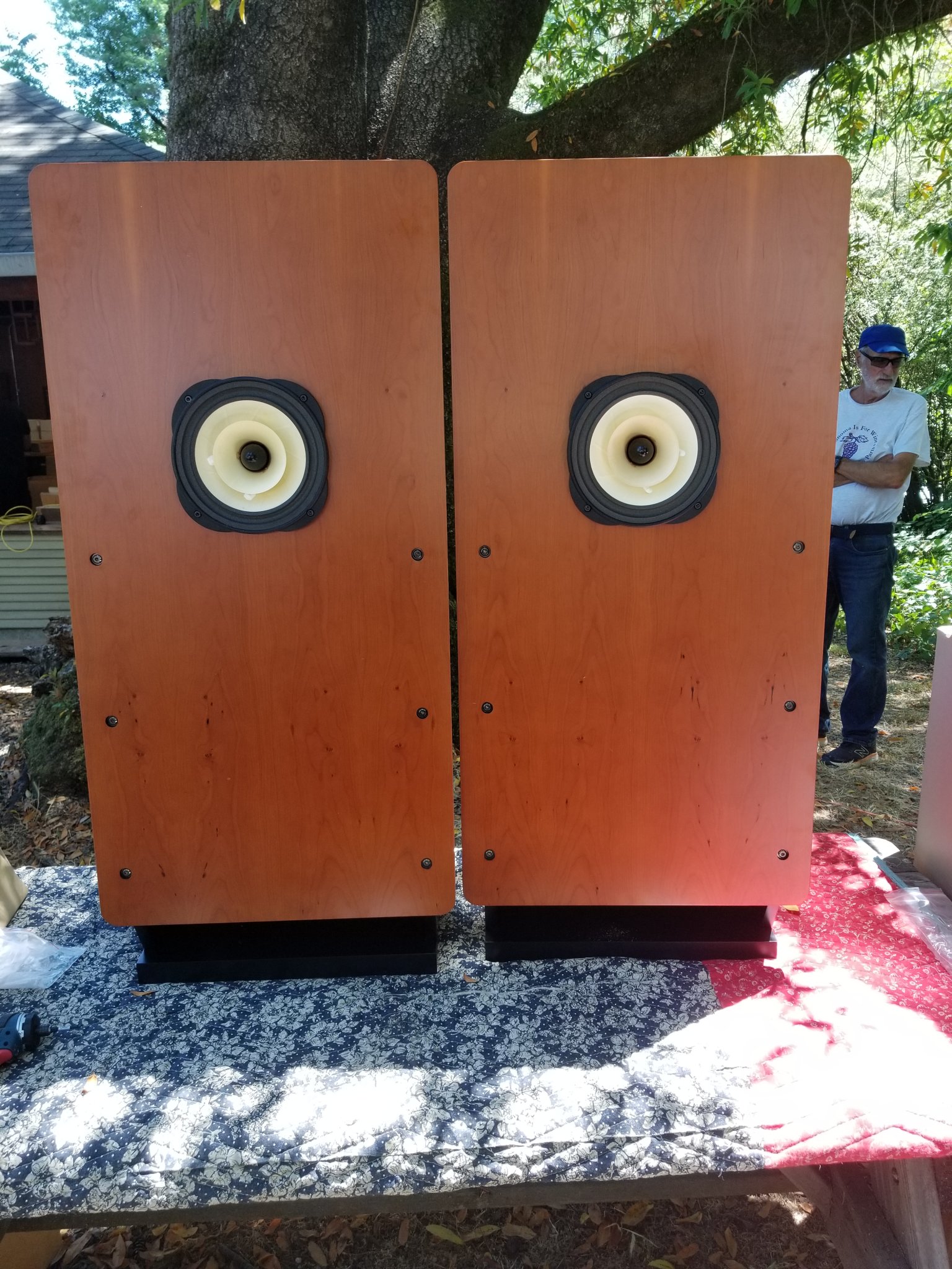

Yes, it was great being at the Brock's and hanging out with DIYers, not to mention the
great outdoor weather and excellent lunch.
This will be the last iteration of this particular design, as we have used up the Moths and
the OB enclosures that I had made for them many years ago. Next time we will have to
do something different.
Talking to one participant at the end I discovered that he did not know that best operation
with this system is running with the phase reversed between the woofer and full range by
switch the +/- wiring between the amp and drivers. This can be done on either, but
fulfills the Linkwitz requirement for the crossover.
Oddly, the system measures relatively flat either way, but is a bit flatter and has better
phase response this way.
