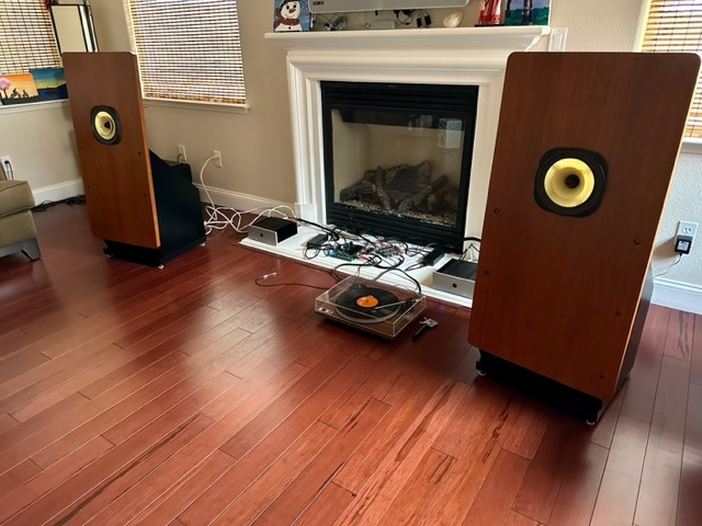

My daughter and I had a great time. We came home and finished the build, got everything wired up by midnight, and listened to these well into the night. These speakers look and sound great, and are going to be permanently in the living room, which means I now have a new interior design project!
Thanks a ton to the Brocks for being such amazing hosts. And thank you, Nelson Pass, for this project.
Attaching a photo that shows the setup as it is now. It’s a bit of a mess and I’ll need to clean things up eventually, but for now I’m going to spend time listening to some music. The speakers are powered by two ACAs and the crossover is fed by an ACP+ and the whole thing just sounds so good. Still going to use this as an excuse for some more projects, so I plan to build a couple of single-ended BA3s and a Mezmerize soon.

Thank you, Nelson - good to know!best operation
with this system is running with the phase reversed between the woofer and full range by
switch the +/- wiring between the amp and drivers.

Thanks, @cyclotronguy. I was looking into 3D printing a cover like the ones that come with Zu speakers but that won’t stay on in use; your suggestion would work better.

Thanks @GTKAudio appreciate your feedback. Not displeased, brain is getting accustomed (just got them yesterday from another member).
Would you happen to know the function of the four variable resistors on the mini crossover? Are they purely hi / low gain per channel?

What I've found is that the full range Moths are fairly directional, and one needs to be pretty well centered or have the toe-in just right to get the detail.
The trimmers are for treble and bass levels. If, like me, you are using a larger stereo amp or mono amps for the 15" woofers than you are using for the Moths, you'll want to trim the bass accordingly. I'm looking to build a 35-40W amp for that purpose, as I'm wasting my 100W APT power amp in that position, considering the frequency range required.
Once you find the right position and trim the mids/treble and lows to your preference, you should be very pleased.

Thanks for confirming trimmer function, makes sense based on their effect when turned. Using an AlephJ for the woofers and M2x for the moths. So fairly balanced from a power perspective. My first foray into active crossover for home hifi, only other active xover experience was triamped live sound reinforcement circa 1983. So it's a steep learning curve but a good one. Nearing completion of a 6-24 unit now.
Just in the last 30 minutes system sound steadily improving.
