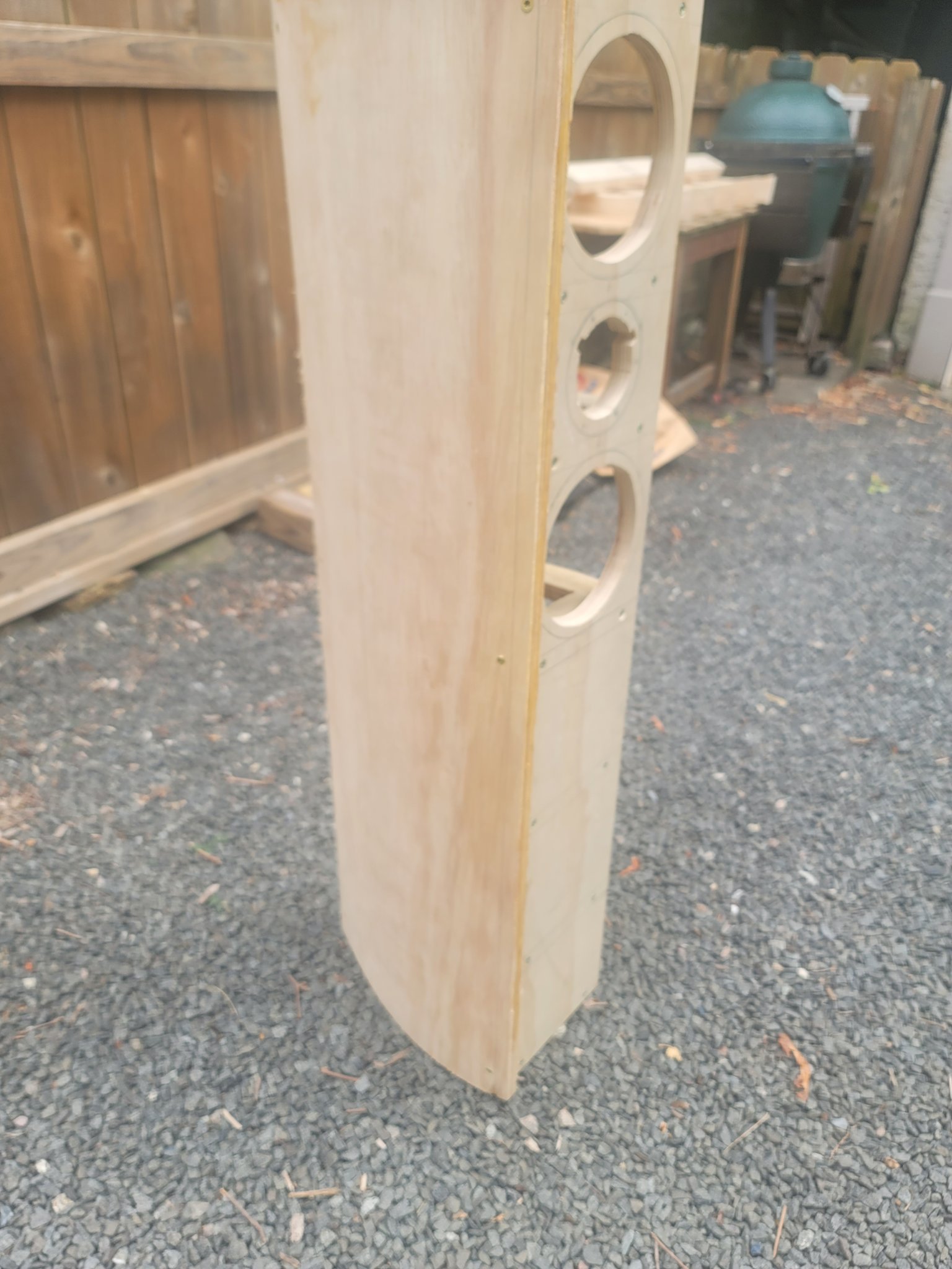

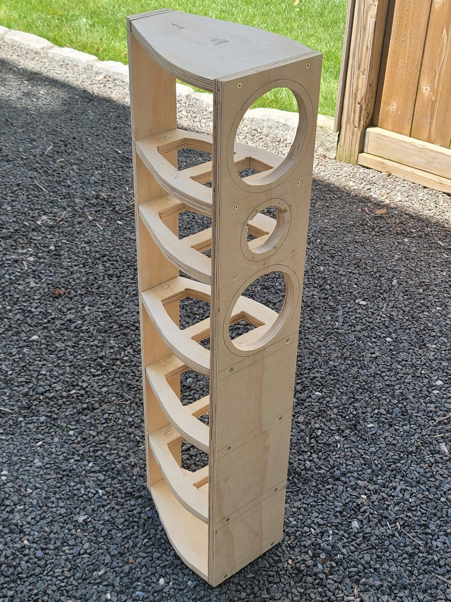

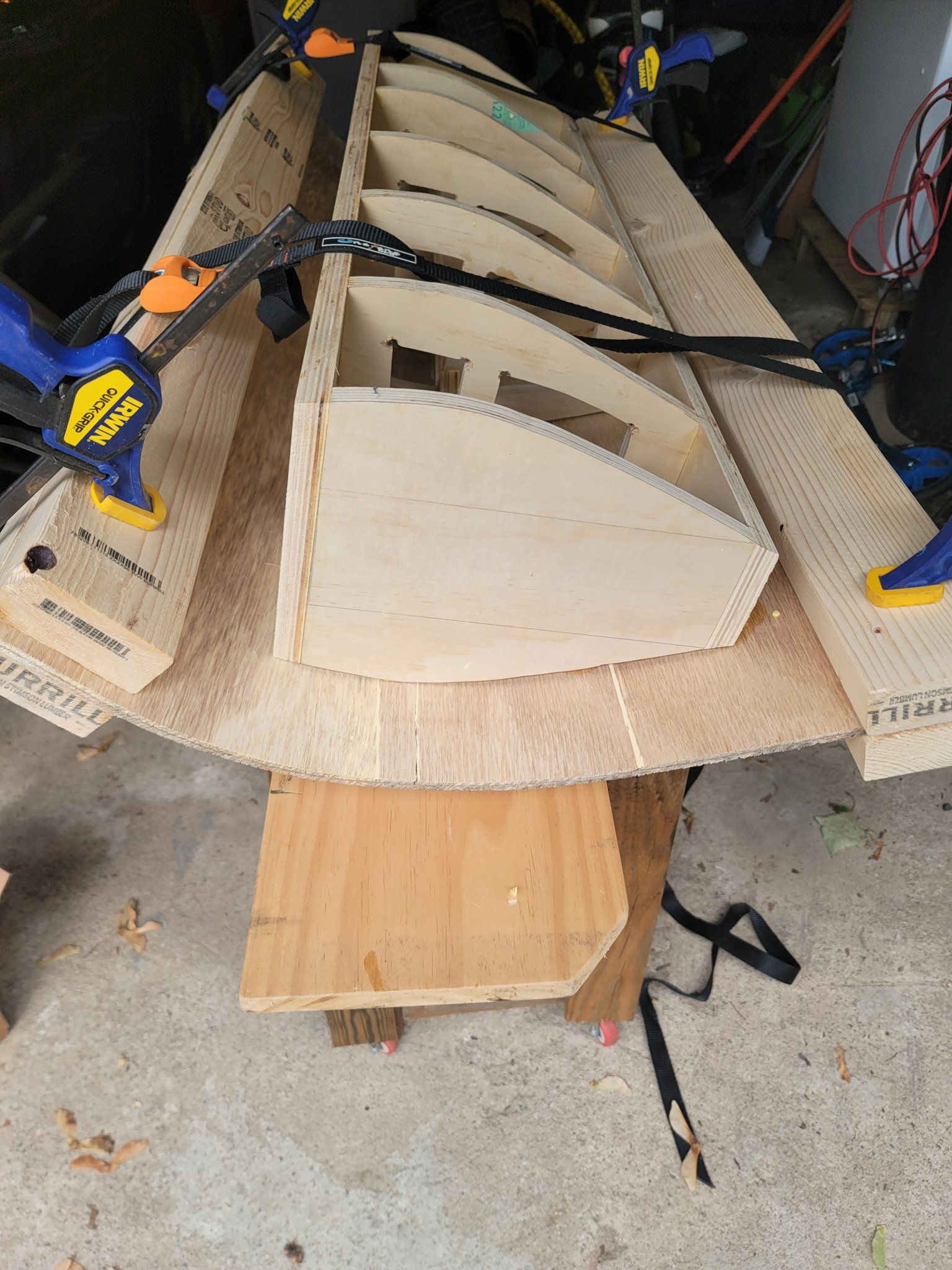

I have used Gorilla glue on a build similar to yours (but a smaller bookshelf). I used layers of 1/8" Baltic Birch and strap clamps, but it wasn't "bendy" so I had to cut kerfs. I used Gorilla glue because it expands enough to fill those gaps.
But Gorilla glue doesn't have a long open time so for a large speaker I would be nervous. I'm currently making a large curved speaker - quite the challenging curve. 1/8" hardboard kerfed layers. I used Loctite construction adhesive for the first layer to frame. Then I'm using Titebond II Extend glue for each additional layer. I'm pretty sure Titebond II is stronger than III, but III is more expensive because it is waterproof.
I'm hoping I don't have to buy a third gallon of Titebond II Extend.But I had to use a LOT of glue. I will likely go through a gallon on this project...

Any glue used will rely on the quality (and quantity) of glue holding the plies of the manufactured wood together, which will most likely be less than that of most glues us DIYers would use to bond the ply to itself or the frame.

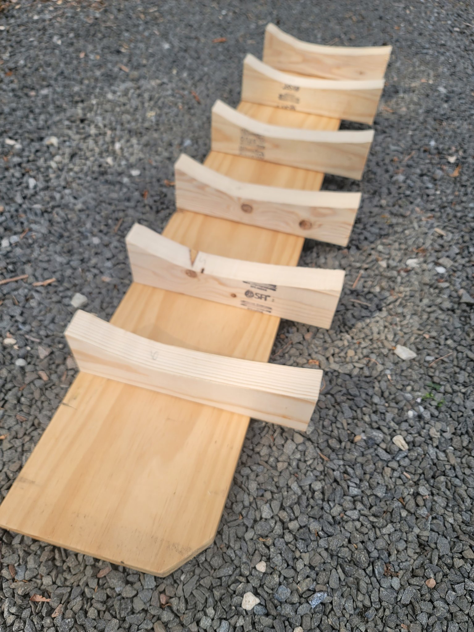

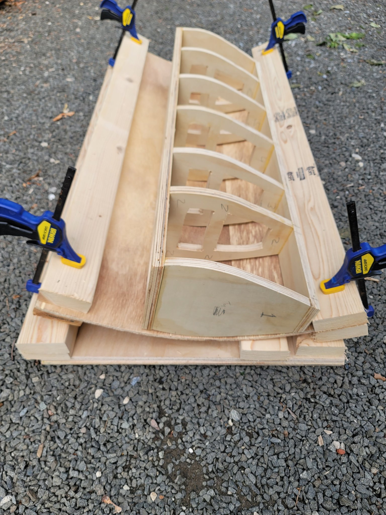

Using more layers of thinner flexible ply will make life so much easier when forming the curves, and gluing up the curved panels on a former first eliminates so many problems of trying to do it on the speaker frame itself. Use slow PVA and a notched spreader used in a single direction to laminate the layers, and use a hard rubber or wooden roller to consolidate the layers - this helps the air escape. Ratchet straps and a sacrificial (unglued) cover piece and a polythene interlayer works well over a convex former. Dampen the ply with a mister before gluing if more working time is needed.
Remember to buy flexible ply with the curve in the right direction on the sheet too!

@jayme I agree. It works well and is widely used in production work with high pressure and uniform heating that would be hard to achieve as a diyer.
@MrKlinky 100% agree that a solud, positive bending form, multiple thinner plies with an unglued top-sheet to help distribute pressure is the most user friendly, consistent, repeatable method for most of us. With forms and jigs, I always remember the Abe Lincoln quote: give me 6 hours to chop down a tree and I'll spend 4 hours sharpening the axe.

Don’t get me wrong, I am mostly not an advocate of that adhesive for much else, but I have had decent results in that application.
Many adhesives won’t stay wet long enough to apply it and get everything clamped up.
We had access to a cnc router for making the forms with lots of interlocking structure, but you can do it using carefully made jig saw profiles, or make a master template and finish the profiles using a router.
I have access to a cnc router for the first time but haven't learned the software yet. I need to get on that.
Taking as long as necessary to make one perfect template and routing copies is the hands-down best non cnc method out there. It's absolutely worth the $ to invest in high quality pattern bits like Amana, Whiteside etc.

First I have heard about the Extend version of Titebond II. I stayed far away from the original due to the fast set time. I need to check out this version once I work through my gallon of III. I dont need the waterproofing aspect of it. I just want long set time.Titebond II Extend
