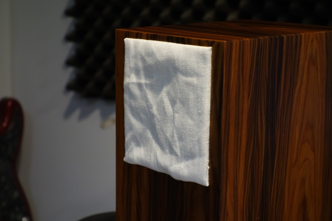

There's a measurement of the linen fabric here:
Replacement Speaker Cloth - Acoustic Research - The Classic Speaker Pages Discussion Forums
which shows about 1dB attennuation in higher frequencies, which I think is quite good performance.

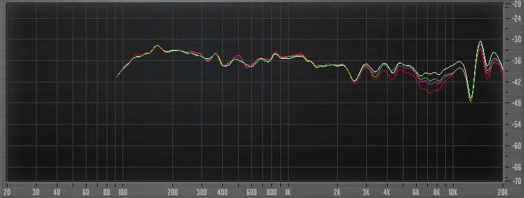

Measurements
I measured a full-range driver at 6" mic distance, 10 degrees off-axis with 3 different fabrics wrapped around the grille frame, though not stretched. The speaker was taped to the table so it would not move between measurements. I'm also attaching photos showing the fabrics.
- white: grille frame with no fabric
- green: craft burlap material
- magenta: linen
- red: double-knit
A few caveats about these measurements. The fabrics were loose, not stretched, which may have worsened their impact. The knit material is heavier than most, close to 1mm thick unstretched and probably equivalent to 2-4 layers of panty-hose type material.

I would agree that most people will not be troubled by -1 or -2 dB at 20 kHz, whereas the 5-10 kHz range is very important. My goal here was to provide measurements rather than focus on subjective listening reports.
I found it counter-intuitive that the burlap material I tested had much LESS effect than the double-knit material I grabbed off the shelf in the fabric store, and that the latter caused a -4 dB dip in a very critical frequency band. This craft burlap is probably more flimsy than what you'd use on a farm, and is pretty easy to see through.
The bottom line is that you do have to be careful to select thin material OR well-perforated material.
