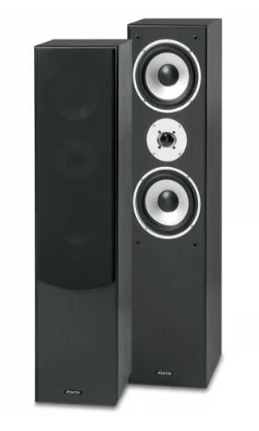

Noob here, (and it's my first post) I just bought these cheap tower speakers for $99 AUD, wanted to see what options i have to uplift them to a better quality on a budget.
Goal is to make them sound better than they are now without breaking the bank (and loosing the point of buying cheap in the first place). (I don't consider myself an audiophile but enjoy music when it sounds good), these don't have a crossover in them as i understand. (do off the shelf crossovers like the one below (from aliexpress) work? i guess the woofers are the same spec and cover mid to low range, is there any advantage in splitting the workload (Mid's on one and bass on the other) using a crossover?

What makes you think they don't have a crossover, because that would be unusual.
You might try room placement and equalisation.
I saw on the review comments by one of the purchasers who has modded it, he had claimed there's only a single filter cap on the tweeter (as the only crossover component?)
You may want to...
1. Decide to use it as a 2.5 way, and choose a crossover point for each driver,
2. Decide to make it an MTM and choose a crossover frequency,
3. Find your baffle step frequency,
4. Measure or at least find some responses and impedances to use in a simulator.

What's the brand on those $99- speakers?
What size are the woofers?
Share the reviews too and any links
I ask because I have something very similar I pickled up from the street a while back, if they are the same or similar don't waste too much money trying to improve them as the boxes might be so badly assembled it won't work well.

Thanks, @Moondog55 link below. (Brand is Fenton, size 6.5 inches)
https://djcity.com.au/product/fenton-shft60b-2x-passive-6-5-inch-tower-set-black/

First off I suggest you do some reading up so you understand Allens suggestions before you try and do anything with the crossover.
But I doubt very much they are 3-Way speakers at $99- a pair, even if they are $2- drivers, maybe 2.5 at the most
The Chinese seller would be happy to get A$30, the rest goes in shipping etc.
You really should open them up, most likely the material of the box will not like repeated unscrewing.
Tell us what is inside.

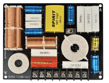

Hardly. Ok, here's a fairly common option.(do off the shelf crossovers like the one below (from aliexpress) work?
Once you understand planet10's page, use an inductor to cross one woofer at the baffle step. Use a smaller inductor to cross the other woofer at 3kHz or so, and add an inductor to the tweeter.
Add resistors to the tweeter to reduce it's level.
"way too technical" - a common probem with over-enthusiastic noobs; even if you're polishing a turd, you still have to learn how to polish.
I would suggest start with a simple 2-way series xover, hard to stuff up: https://sound-au.com/articles/6db-xover.htm
You still need to learn how to make impedance plots (that's the point where the enthusiasm evaporates from the wannabes)

Yeah, what other said...i guess the woofers are the same spec and cover mid to low range, is there any advantage in splitting the workload (Mid's on one and bass on the other) using a crossover?
The 2.5 way (not quite three) approach suggests ,yes, one midwoofer handles more lowish notes and the other makes more midrange, and it's placed near the tweeter (WWT or better...MidWoofer)and...since both woofers are not low-passed, you'll get a double contribution to bass, hence +6dB or whatever and then double for stereo.
So this suggests, either, that the MW is good till crossover, and depends on the speaker.
The classic and never surpassed 3 way approach suggests that each driver specialized in its own range ( passband operation) ...
wait...passband...SPECTRUM...wavelenghts
So the specialization is first offered by the diameter ( and form) of the cone.
small and light cone = less moving mass, more attitude to vibrate at high speed...hmmm...yes, they follow ( voice coil suggests that...) signal LF content ( what else?) and we hear from 20 to 20000 Hz

Then there's the MTM approach like we see in the first pic
Thousand of technical pages are written on the subject
Very subtle ( or gigantic) variations due to the two cones emitting together; great care in minimize their distance 'coz the higher the frequency, the smaller the wavelenght

Do you have a subwoofer? In that case, running them as a 2-way MTM rather than a 2.5 way would be easier. I support modding them, you'll learn some things and probably have some fun. A long as you don't pour a bunch of money into the process, it will probably be an improvement. It won't matter how good they actually sound because then you will be bitten by the DIY bug and build something new anyways.
