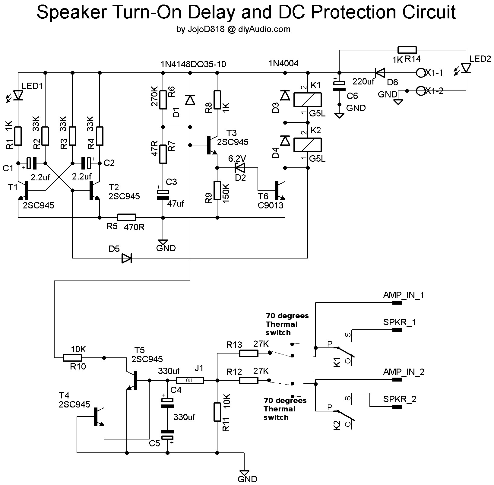

Speaker Turn On Delay and DC Protector Board Set (V2)
Just wondering, are we really breaking DC as we are breaking the amp's output ? If so, the DC voltage should be around 1V max when the relais cuts off - or am I missing something ?
Suppose your amp is working on +/-24V DC & one of the power rail fails sending 24V DC to the spk. The resulting arc due to DC current might even melt/fuse the relay contacts permanently. This situation is far more dangerous from the normal turn ON/OFF transients of 1V or so. Special relays are manufactured for this sole purpose by Amplimo.

I have a Pass F5 power amp with the current limiting portion of the circuit removed, and so I absolutely must prevent the short circuiting of the output terminals, as even a momentary connection would frazzle the amp boards. I am using Neutrik Speakon connectors to prevent this happening, with success.
Would this delay/dc protect circuit short the outputs in any of it's modes - ie. during delay, when DC tripped etc, or does it simply disconnect the circuit?
Many thanks
Lucas
no it does not, it simply disconnects the speakers to prevent it from frying,
voltages as high 1.5v can not burn your speakers but a full rail can..
so at least an output offset speaker protection circuit is minimum requirement for me...;)
it will not affect the operation of the amp except to disconnect the speakers,

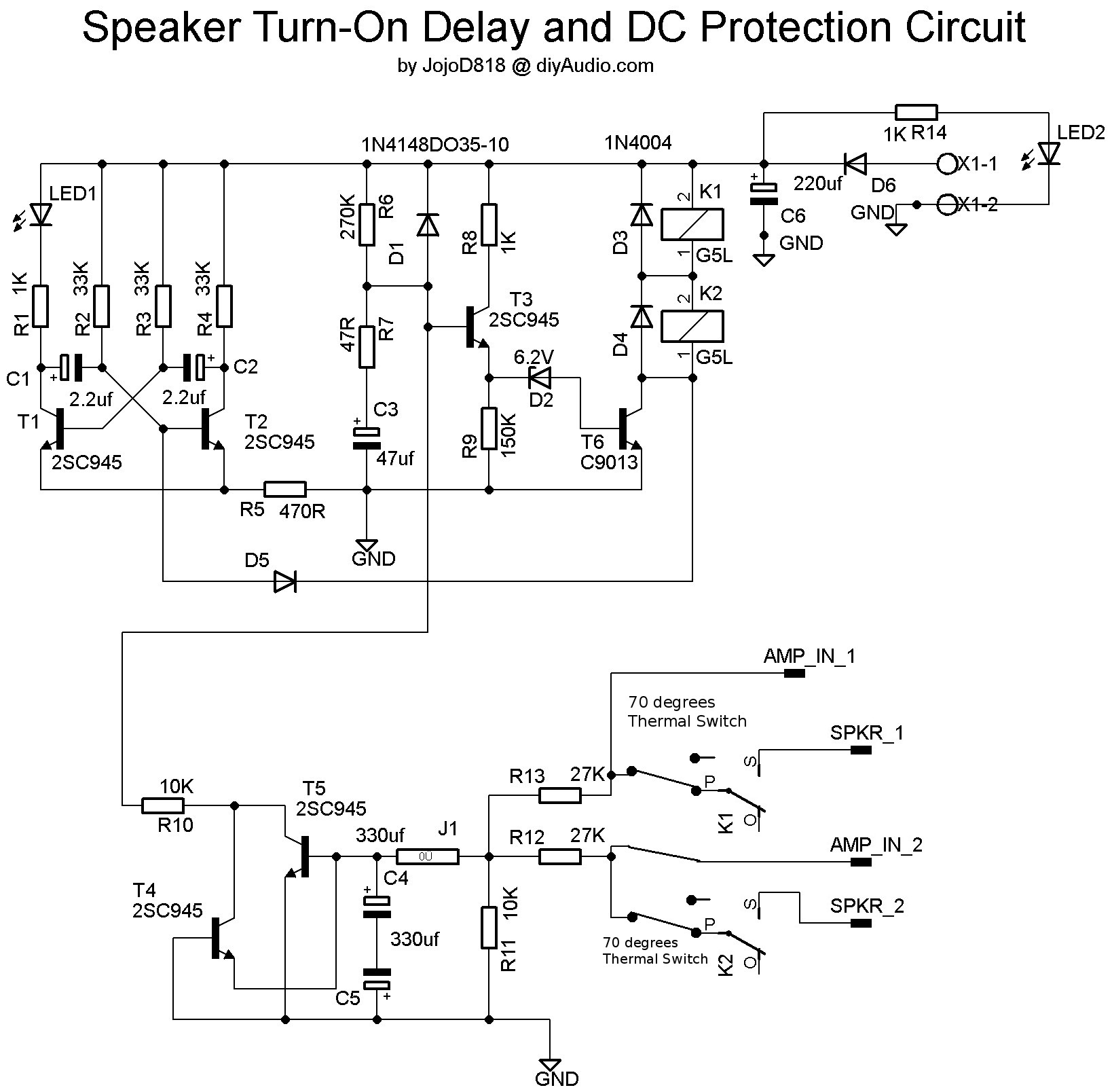

Thermal switch
Can I add in the thermal switch at this location as shown on the attached schematic?
Thanks.
