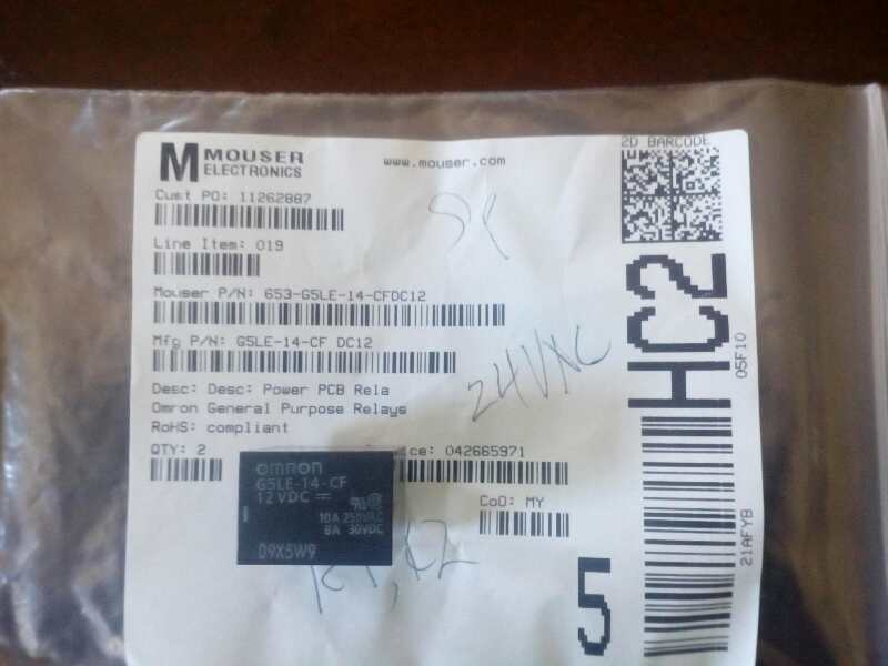

Well, I made a mess of my V2 board trying to desolder the relays. I'm going to start over with the V3 board but mouser #653-G5LA-14-CF-DC12 for K1, K2 (24 volt) is unavailable.
Would this (http://www.mouser.com/Search/ProductDetail.aspx?R=653-G5Q-14-DC12) be a good sub?
Hey mattmcl,
I got these, 653-G5LE-14-CFDC12. See image. I'm pretty sure I compared with the BOM ones and they were similar. Pinout matches the PCB. I haven't soldered them in yet so if anybody sees that they won't work let me know. I ordered them a couple months ago so I would think they are still in stock.
those wont fit the pcb as footprint and pin spacing are different.Would this (http://www.mouser.com/Search/ProductDetail.aspx?R=653-G5Q-14-DC12) be a good sub?
see my post no. 256 . just ensure that PCB silk outline for relays can take 22mm lengthwise.
653-G5LE-14-CFDC12 would work too as given by dbis
