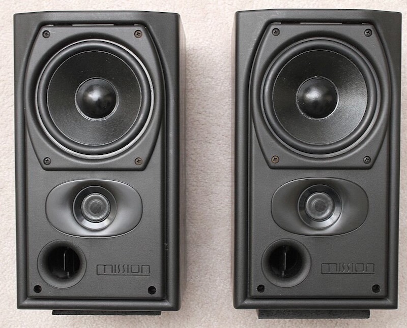

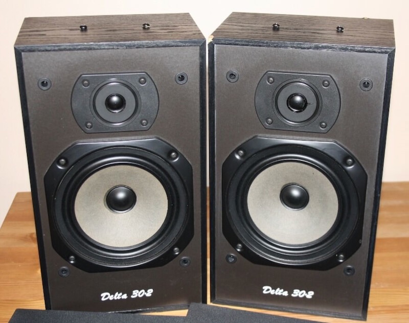

Due to a clerical error on my part, I now have 4 pairs of 2 way monitors going spare. Wharfedale delta 30.2, mordaunt short ms20, mission 731 and 732.
In my house, I like to have two systems. One for the office, and a surround sound for the TV (got a standard 2 channel amp for the office, and a 5.1 avr for the TV, I'd upgrade to 7.1, but I'm really not sure if it's a good idea for the space).
Originally, with a spare amp too, I was going to give away one pair, keep one pair (most likely the 732s), and sell the other two, but I was tinkering with some of them the other day, and I was really enjoying the difference in the characteristics. I won't say they're all on the same tier exactly, but they're not that far apart, and I do enjoy the variety, even if they're not crazy different.
Recently, I bought this pair of custom speakers. Way cheaper than they should have been, and absolutely massive. I think the previous owners liked them for parties, and I got a horrible overpowered amp for the asking price thrown in for free. Thankfully, it plays nice with the avr, and the added depth it gives the sound at not insane volumes (I like my neighbour, and it's a semi detached, what can you do) is very nice.
It had me thinking "how hard could it possibly be to whack some MDF together, do maybe 5-10 minutes of soldering, and unscrew drivers for transplanting".
I did do a little research, and the advice seemed to be "why would you do this", but I guess I'm just after answers with my specific set up.
My current thinking was:
1) don't mess with the 732s. They're nice, I like them, perfect for the office. Keep those as is (once I've repaired a tweeter).
2) give away the 731s + amp. It's getting a bit silly having this many unused cabinets lying around.
3) unholy Frankenstein combination of what, iirc are some wharfedale lasers (please don't make me walk downstairs to find out which) I'm using for rear surrounds in the TV set up, the mordaunt short ms20s, and the delta 30.2s into a disgusting mttmm or mtmm floor standing speaker, then flog the unused parts on the bay. Potentially add a woofer for fun too, then use them for my rear surrounds in the 5.1 set up.
What I want to know, is on a scale of 1 to 10, 1 being bad, and 10 being good:
1) how good/bad could it sound
2) how much will I regret my decision on this as a project
3) chances of success? (Part time tinkerer + audio refurbish and repair. I won't say what I achieved is aesthetically pleasing, but I also won't say I care, or that it doesn't function)
