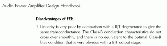

Bob Cordell said:
We have to be careful of broad statements like this. Doug Self also inappropriately described MOSFETs as less linear than BJTs. Both types of devices are nonlinear when looked at by themselves. The exponential of a BJT is arguably more nonlinear than the square law of a MOSFET. But that all misses the point.
To be fair, from chapter 11 (FET output stages)..........
By Bob cordell - MOSFETs have about ten times lower transconductance at the usual modest operating currents in the crossover region than do BJTs. This leads to reduced incremental gain in the crossover region and hence distortion. The distortion created does, however, tend to be softer than that created by BJTs because the transition region is wider.
Interesting statement, Bob. I have noticed slightly higher THD with a direct replacement of BJT's with mosfets in a given topology. You say a "softer" distortion occurs at the Xover region.. what does that mean ??? Different high order distortion products ??(less H5/7).
I do not entirely trust most fet models , but would this difference be a logical "tradeoff" (softer distortion vs. slightly higher THD). In simulation we are only talking about the difference between .003% (BJT) and .006% (IRF's). Also , would these transition differences also hold true with a quasi-comp class B stage??

Bob Cordell said:
Models are even more of a problem with vertical MOSFETs, as the ordinary ones do not properly model weak inversion, and that is where you are at in the crossover region with the typical quiescent bias currents for a class AB MOSFET output stage (per device pair, 100-200 mA).
The somewhat over-simplified MOSFET transfer characteristic behavior is described as exponential at very weak inversion (like the Ic-Vbe characteristic of a BJT) transitioning to square law at full inversion, and then transitioning to a somewhat different law at very high currents where the Rds begins to come into play. At typical quiescent class AB bias current of 150 mA, many MOSFETs are right in the middle of the transition region from exponential to square law.
