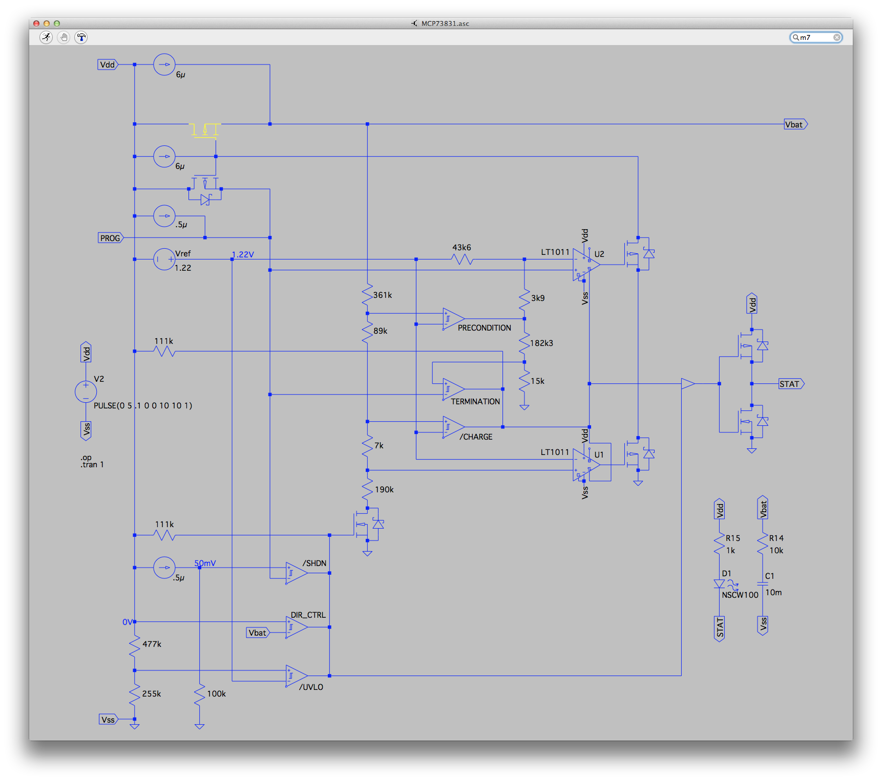

I had a quick look at your file... it wont be easy I suspect. The LT1011 comparator might be worth a look as it has a strobe input that is active when pulled down to ground via a suitable resistor (not a direct connection).
I thought it wouldn't be easy, but I need this and I'd like to make this work. And it would be shared, so help others too.
That LT1011 would be instead of the lm311 right?
Was I correct to assume that it's a plain buffer with strobe that commands those mosfets for that stat output?
That too probably needs tweaking to make sure it works as intended.
In that asc file, I only put parameters in one of the schmitt triggered comps, and the values are arbitrary, so probably won't work as is.
Yes instead of the LM311, and the LT1011 looked sort of suitable because it has a strobe and of course its in the library. I wonder if the buffer has an inhibit or strobe to put the status output in an 'open' condition depending on the inputs to it of course. Like tristate logic.

After looking at the LT1011 datasheet, I have doubts that it can be suitable, because it is made for dual power supplies, with the ground, and not a single, so since everything else inside that MCP chip is single power supply, I don't see how this would work. The output from that comparator would want to drop below zero, if it could, but it couldn't because there isn't a dual supply for it.
I think you connect ground and the minus supply pins together for single rail. Try it in a simulation and see how it performs.
I had to rearrange a few things and reroute, but it's in there.
The thing is, this schematic isn't complete yet, as it's still missing a small but important part near that top mosfet (highlighted), the direction control, which remains a mystery for now.
I tried running it, with a 5V dc supply, but the stat signal is up and the vbat sends power to the battery, but I'm not certain my little test contraption on vbat with the R/C as a battery is going to be suitable. I tried with different values, but everything stays pretty much static.
I tried giving it a "pulse" instead of dc power for the whole circuit, starting with no power at all, and after a short time, turning it on, and there goes the stat and vbat, the same as if dc powered from the start.
I figured a large cap with a resistor would kind of simulate a discharged battery at first, then as the big cap charges, it would behave like a charging battery, using the R/C constant like a charging curve. But I'm not seeing any hints that it would happen.

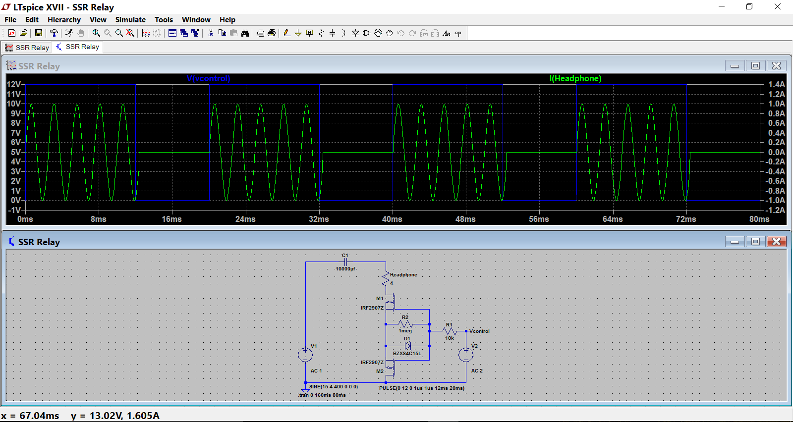

Could the direction thing be a solid state relay that passes current in either direction irrespective of polarity ?

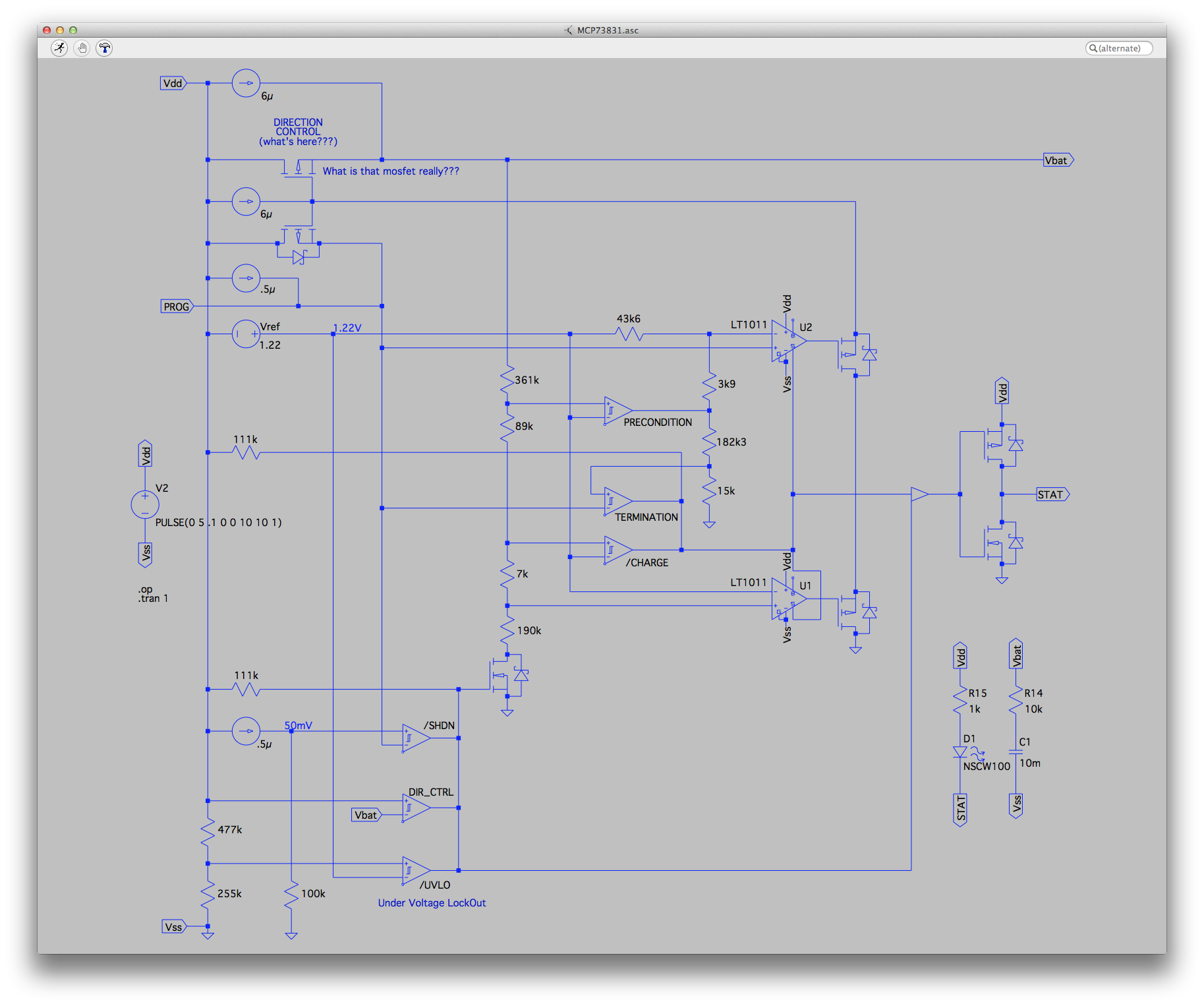

I really haven't got a clue about what that mystery box could contain, but I assume if it had more mosfets, that those would be drawn as the others in the schematic and not put away in a box with who knows what else. It would stand to reason that there aren't any more mosfets to this schematic than there are already and that whatever is in that box would rather be something that commands those 2 mosfets below. Those that we see in the schematic.
What I see about that box, is that it has 3 connections, one to get power from Vdd, an other "senses" Vbat, and the last one seems to go to the gate on the mosfet below.
However, I do see something odd about that particular connection: that mosfet already has a gate that is connected to the line below, along with the other mosfet's gate, which to me means they are commanded by the same signal, but although that 3rd connection from the direction control box seems to be going to the mosfet's gate, I can't be certain it's the same gate as the one going down to the line below.
Plus that mosfet seems different from the others, not only doesn't it have a schottky diode across it, it doesn't have the connection between those 2 legs at the source.
Something is odd there, and I have no clue about what is going on.
This is the missing part for this model, and I don't think it can work without it, so until something can be figured out, it can't truly be tested.
I don't even understand how there could be bi-directional currents there, as it's hooked up to Vdd and current could only come from there and not the other way around. Am I missing something?

The way I did it doesn't really match the datasheet schematic.
I just dropped a generic pmos there, the same as the one below, but we can see that this isn't what's actually there in the datasheet schematic, at least not quite.
And the difference isn't just the lack of the schottky, there is something more, not to mention that mystery box.
I'm stumped!
I'm stumped!

I wonder if the mystery box could be some low drop out programmable constant current source. Thinking about it, if it were just a FET or as I perhaps thought a bi-directional type of relay then that would connect the battery to the incoming voltage with no current limiting.
Not easy to suss out at all.
If there is a current source in that box, why would they draw just a box and not the current source? Unless they are doing this purposely to blurr things up a bit.
They have drawn explicitly a bunch of other current sources, so why would they hide one more? We can only speculate for now.
Same as with a current source, if they draw all the mosfets but not those in that box, would that just be a way to obfuscate things? or just that what's in that box is something else?
For one thing, if there were a couple more mosfets inside that box, as some type of switch, then it would come in parallel with the mosfet that is shown below. Would that make any sense?
Now that makes me wonder one more thing, let's say the contents of that box is some kind of command logic, maybe getting its parameters/info from some other parts inside that chip, and that it commands that shown mosfet right below it, and I suppose maybe both of those mosfets, if the gate signal goes down to where both mosfet's gates are connected, then perhaps that logic in that box is what does commands those 2 mosfets.
And one more thing, that mosfet right below the box, looking a bit different from the others (no schottky for one thing), could be a simplified representation of some arrangement, perhaps of 2 mosfets instead of one, arranged as a bidirectional switch...
I still don't understand how it really could be bidirectional, with current flowing back up towards the Vdd. I must be missing something...

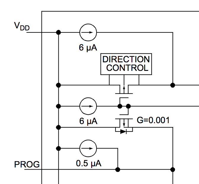

I just found out I had already made a few mistakes in what I did, from that ltspice forum. I had switched some mosfets at some point, and since I'm using the library generic ones without their schotty associated, when I put them in place they were reversed.
I'm posting an updated screenshot.
And there is one more thing I'm wondering about: on their schematic, it shows a G=0.001 near the second mosfet from the top, below that direction control box. What do they mean by that?
