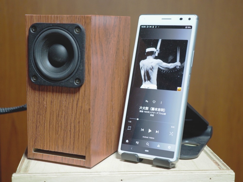

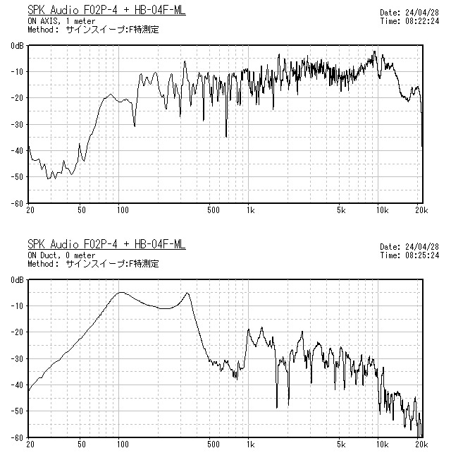

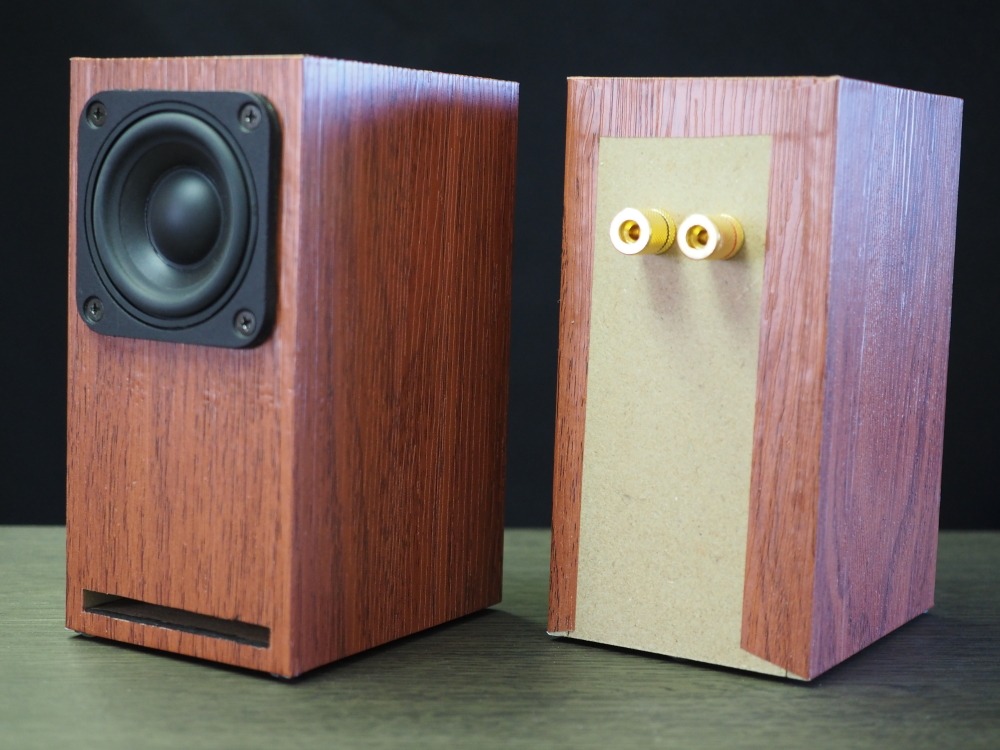

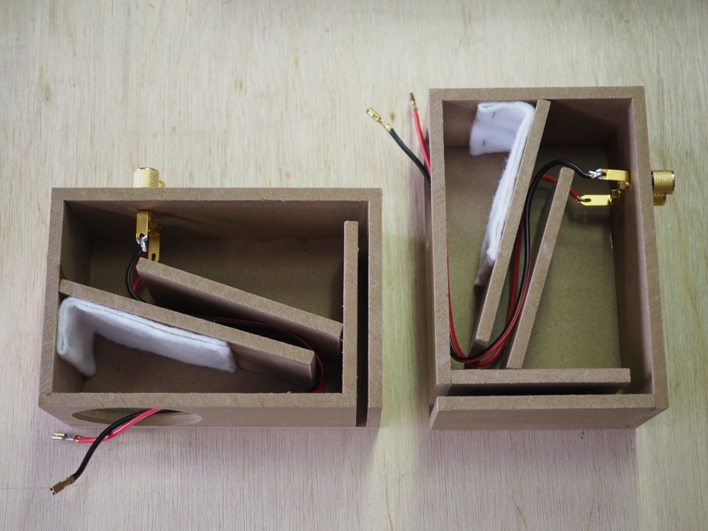

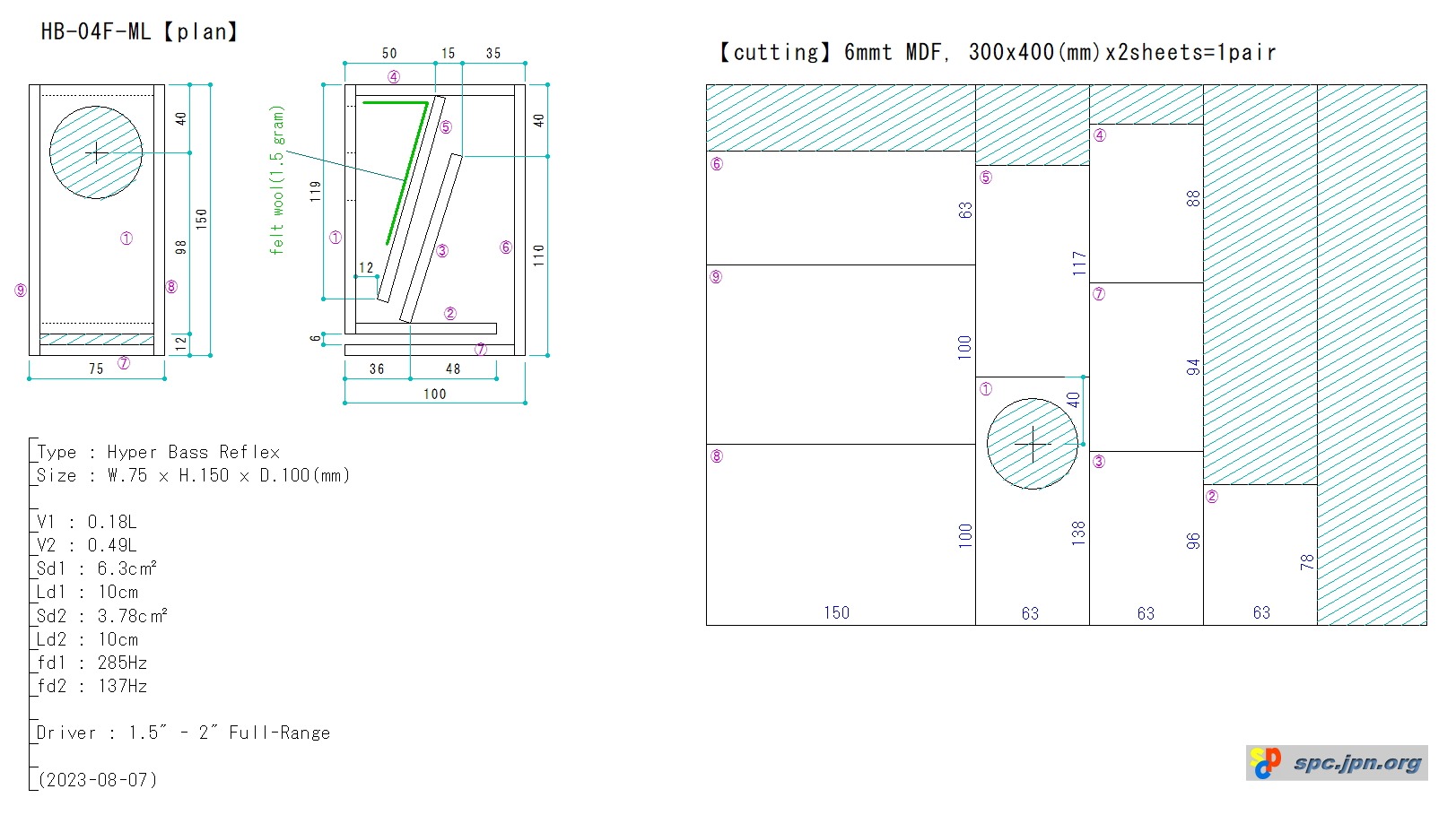

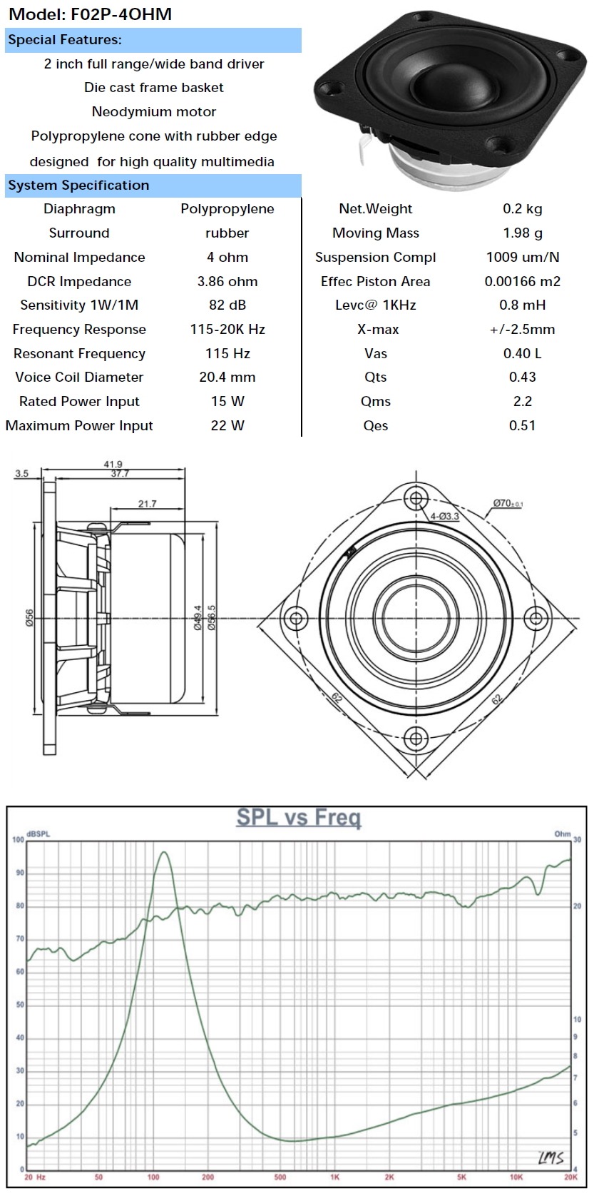

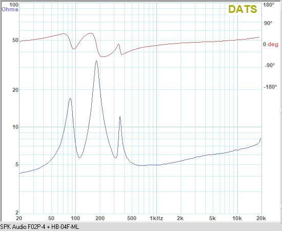

SPK Audio F02P-4 (2" full-range) + HB-04F-ML (smart-phone size mini speaker)
My favorite 2" full-range driver(F02P-4) installed in a smart phone sized enclosure.
The body is 6mm MDF and the finish is wood grain sheet.
It's a mini size but enjoyable to listen to music.
Bass is poor, but I don't mind.
