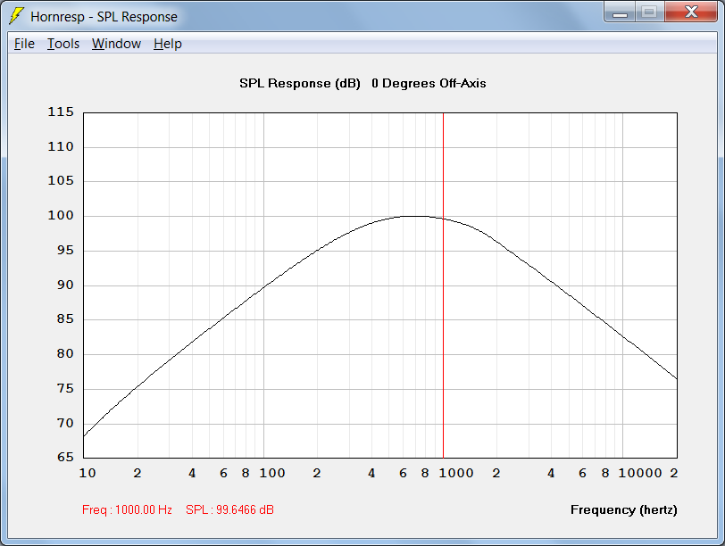

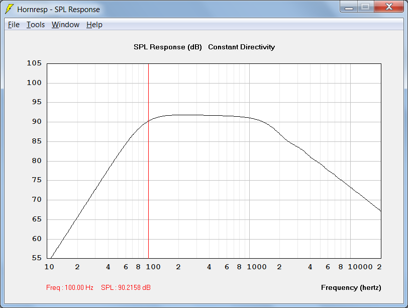

Is Sound Pressure Level generated by a transducer proportional to speed of the cone or acceleration of the cone.
Attachment 1 - On-axis sound pressure level 1 metre from driver diaphragm. Driver mounted in an infinite baffle.

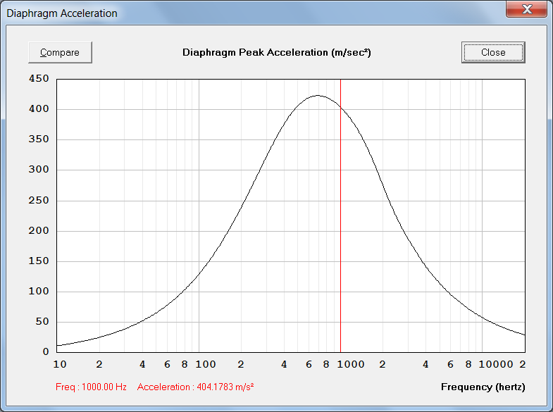

Attachment 2 - Peak velocity of diaphragm.
Attachment 3 - Peak acceleration of diaphragm.
If you plot 20*LOG of your acceleration data it will match response trend of SPL plot (20*LOG of Pressure/Pref).
I performed a few hand calcs to check, taking 20*LOG of data from the acceleration plot and the results match the HF and LF roll off slopes shown in the SPL plot.

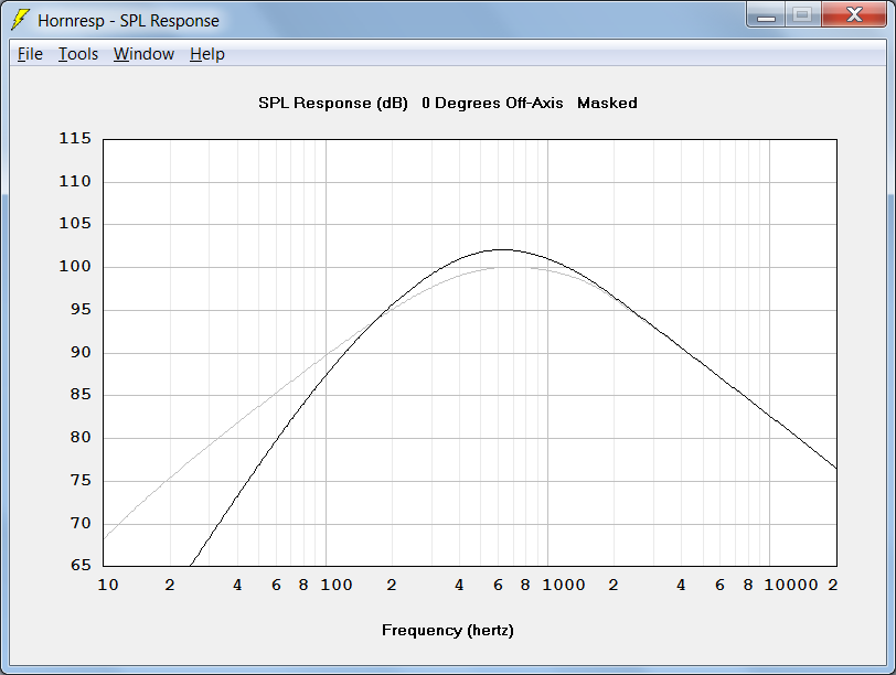

The simulation was for a driver in an infinite baffle - as stated. The SPL response chart posted showed the output from one side of the driver. Each side of the driver diaphragm radiates into a solid angle of 2 pi steradians (half space). Note that this is not the same as a driver suspended in free space radiating into 4 pi steradians, in which case the front and rear outputs cancel due to the 180 degree phase difference.

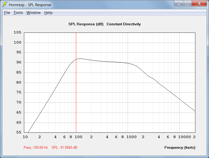

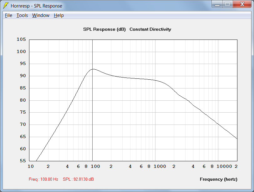

The attached screenprint compares the same driver in a sealed box enclosure (black trace) against the previously posted infinite baffle result (grey trace).

Looks like your simulations were run with a driver having unusually low Qts. Perhaps around 0.10?
Most woofers designed to be used as direct radiators have Qts>0.3 and you will see the response revert to the 12dB slope on the low end even in the infinite baffle case.
For the purpose of the SPL / velocity / acceleration / exercise I simply used the Hornresp default driver, Qts = 0.13.

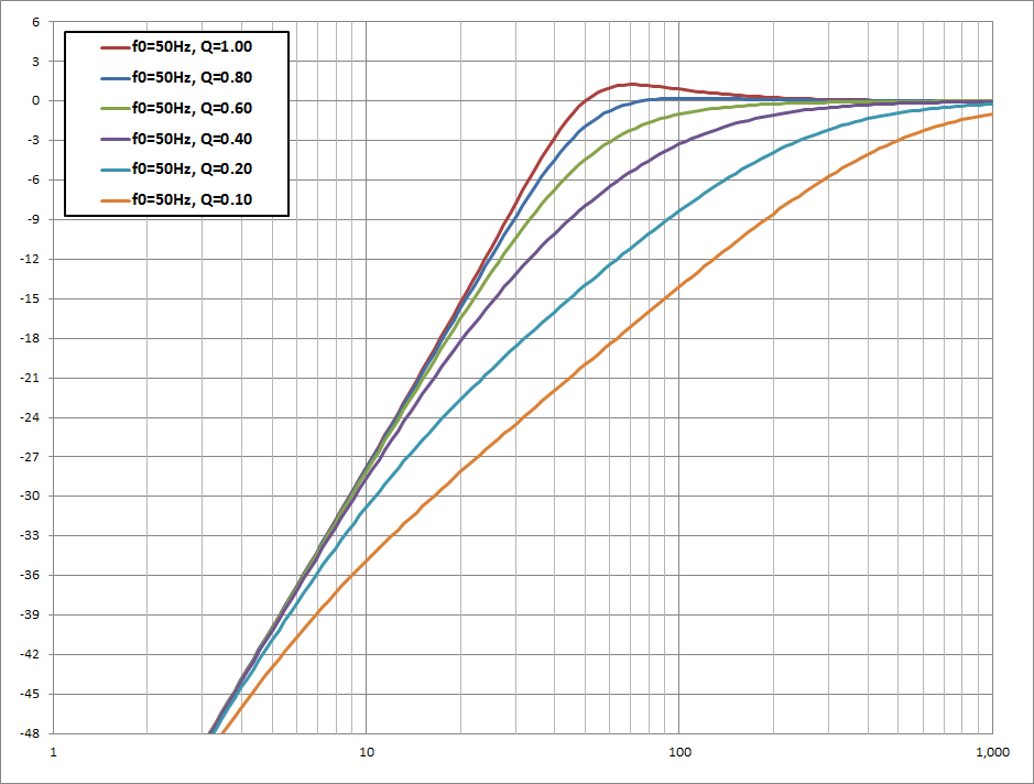

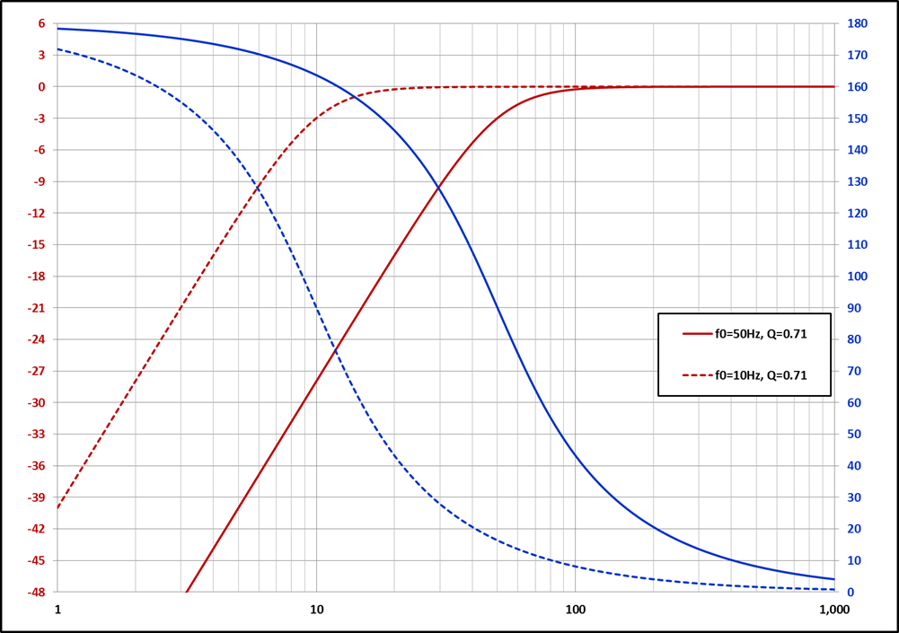

... what would the phase relationship be between speaker (in closed box) driving voltage and microphone output? Microphone would be placed close to the speaker, and the speaker should look pretty much pure resistive at the frequencies of interest.
Attached is a plot show relative response(red curves) and phase (blue curves) for a critically damped closed box woofer. Phase shifts from 0deg(in phase) above resonance to 180deg(out of phase) below resonance. With resonance set at a typical 50hz(solid lined), you can see that you would need to include some sort of phase compensation to keep a feedback loop stable when a useful amount of open loop gain was used. If you added enough mass to the woofer to push resonance down to 10Hz(dotted lines) you may get away with minimal phase compensation. However, be aware that you would also need to consider the phase response of your microphone and any other AC coupled circuits in your feedback loop to avoid instability above or below your bandwidth of interest.
It is certainly possible to reduce LF noise at your listening position with a noise cancelling woofer set right next to you....the frequency range will be restricted to about 20-50Hz (as a first try), and the idea is to reduce the noise over a small area, in a small room
However this will cancel out not only the unwanted noise, but also any bass content in the music you are listening to on your open-baffle speakers.
I do need to have a fairly clear and accurate picture of phase response, because I'll be designing this by "dead reckoning" as I unfortunately don't have any test equipment other than a multimeter.
Personally I would not consider trying to design a noise cancelling woofer circuit without equipment to measure open loop gain and phase.
As mentioned above, you will need to know the phase reponse of the entire open loop signal path, not just the woofer portion. You might take a look at one of th MFB(Motional FeedBack) threads to get an idea of what is involved. Basically it is the same thing as what you are wanting to do, but the sensor is an accelerometer rather than a microphone, and the unwanted signal is distortion instead of noise.
